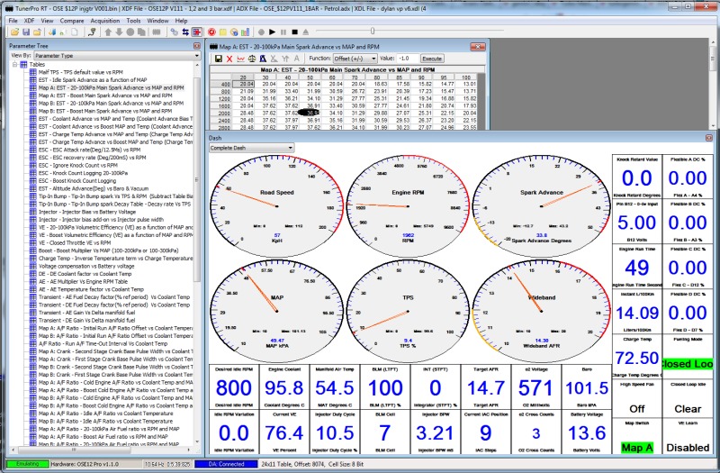

Screenshot: Quick Start:

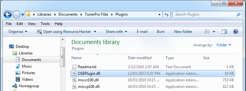

The plugin should be extracted from the zip and copied to My Documents\TunerPro Files\Plugins. This is the default location selected by the oseplugin-180 installer.

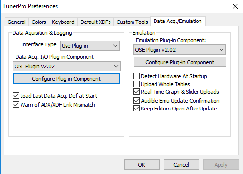

Then run Tuner Pro and pick Tools then Preferences then pick the "Data Acq./Emulation" tab. Then change "interface type" to "use plugin" and "OSE Plugin" for both of Data Acquisition and Emulation. Attach your USB->Serial adaptor or USB vehicle interface, and power it up. When windows has loaded the drivers for the device, Click either configure button. Pick your com port from the list.
If you are using an OBD style ALDL interface, select echo
If you are using a modified '808 with a pcmhacking interface, select echo.
If you can not connect to a modified '808 with echo selected, try it with it deselected. Echo is more common, but both types of interface exist.
If you are connecting to a VT/VX/VY Commodore then select the correct vehicle type.
If you are connecting to a VN to VS Commodore or a pcm on the bench select vehicle type "other".
Port 2 is for running dual 6 cylinder computers on a V12 engine - for normal applications leave Port 2 set to "None".
Click OK to save the plugin configuration.

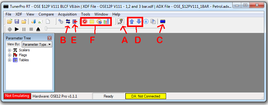

On tunerpro click the 'Initialize Emulation Hardware' button (A). Tunerpro should beep and name your hardware at the bottom of the screen eg "hardware: OSE12 Pro V1.1.1". Load the appropriate XDF (bin file definition) and ADX (Logging data stream definition) for your configuration. You should now be able to start logging (button B) and emulate (requires running from NVRAM, button C) as well as download from or upload to the complete tune (D). For logging bubble tracing hit E (shows on fuel/spark tables where the ecu is looking up data from - supported XDF/ADX only). The Dash, Data list, Data history and monitors views are labeled F. Recommended detailed usage and configuration guide: Known Problems:

also for those on win7 and vista, the plugin goes into Documents\TunerPro Files\Plugins
you have to create the Plugins folder.
