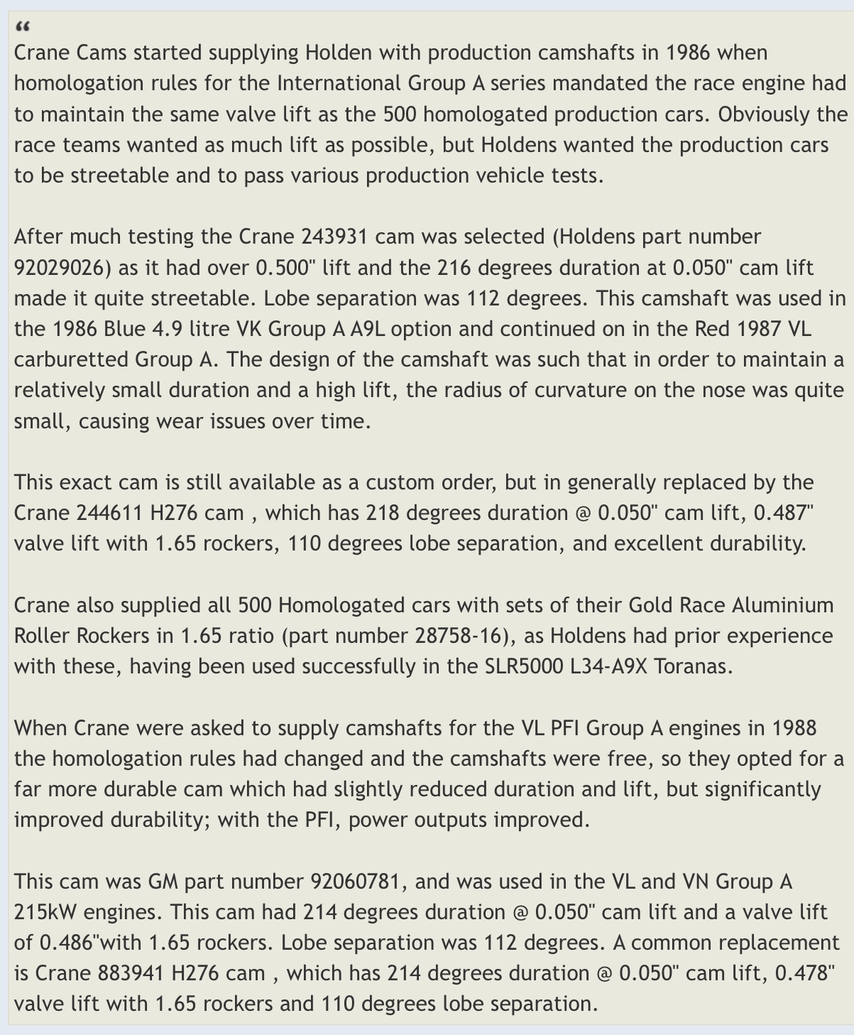

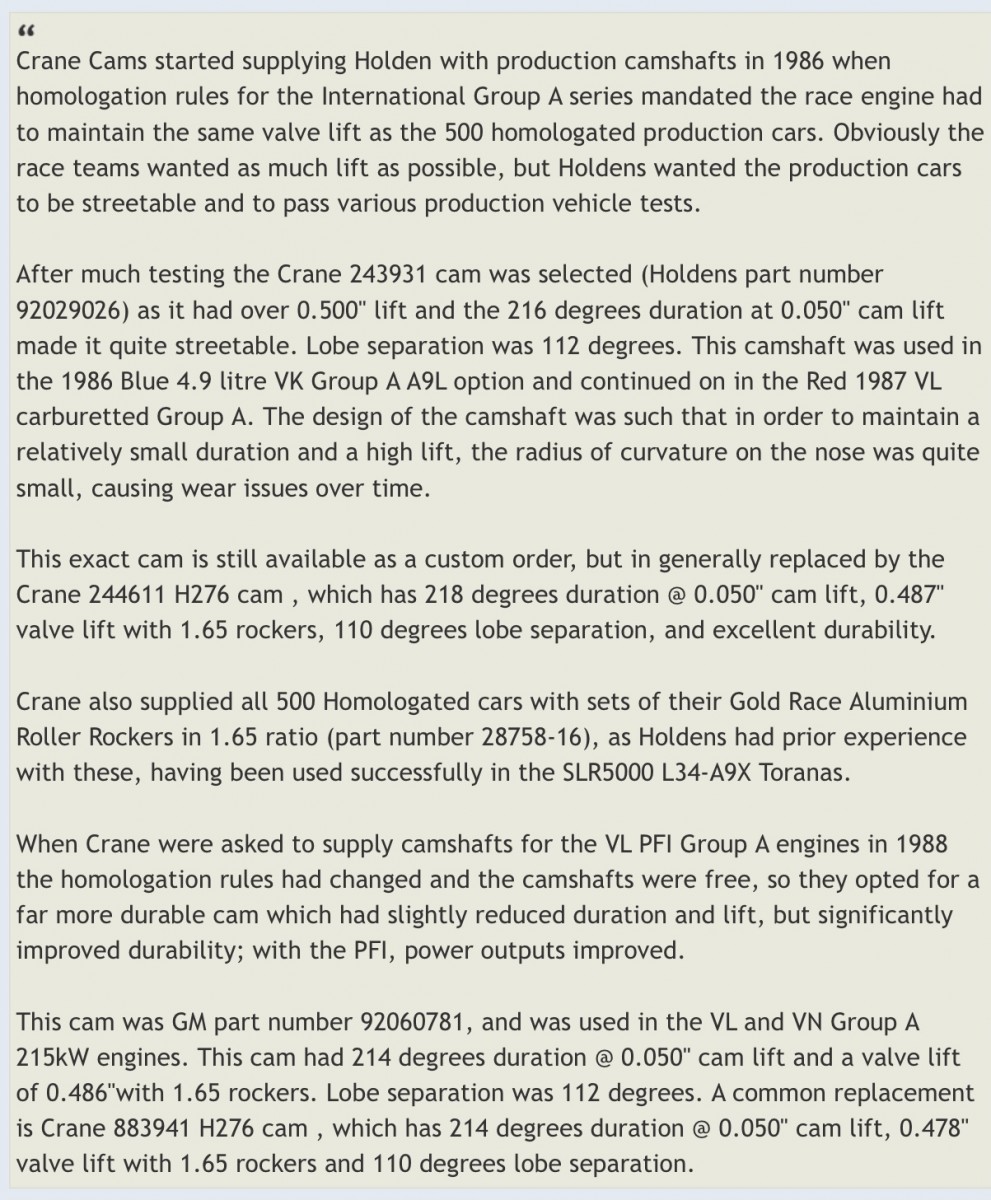

Mine is the big single BF fan. It shifts a serious amount of air but has a serious amount of draw. I’m still wondering if there is some some of capacitor or resistor that only allows half the fan speed initially??
The tune in the memcal when I bought it is factory nos VL Group A. I bought it from a Holden Dealership in Oz some time ago. The reason I went with the 276 is crane states it as their Group A replacement cam. As far as I am aware the specs are very similar to the factory Group A.
Below is a extract from Bertie Street
