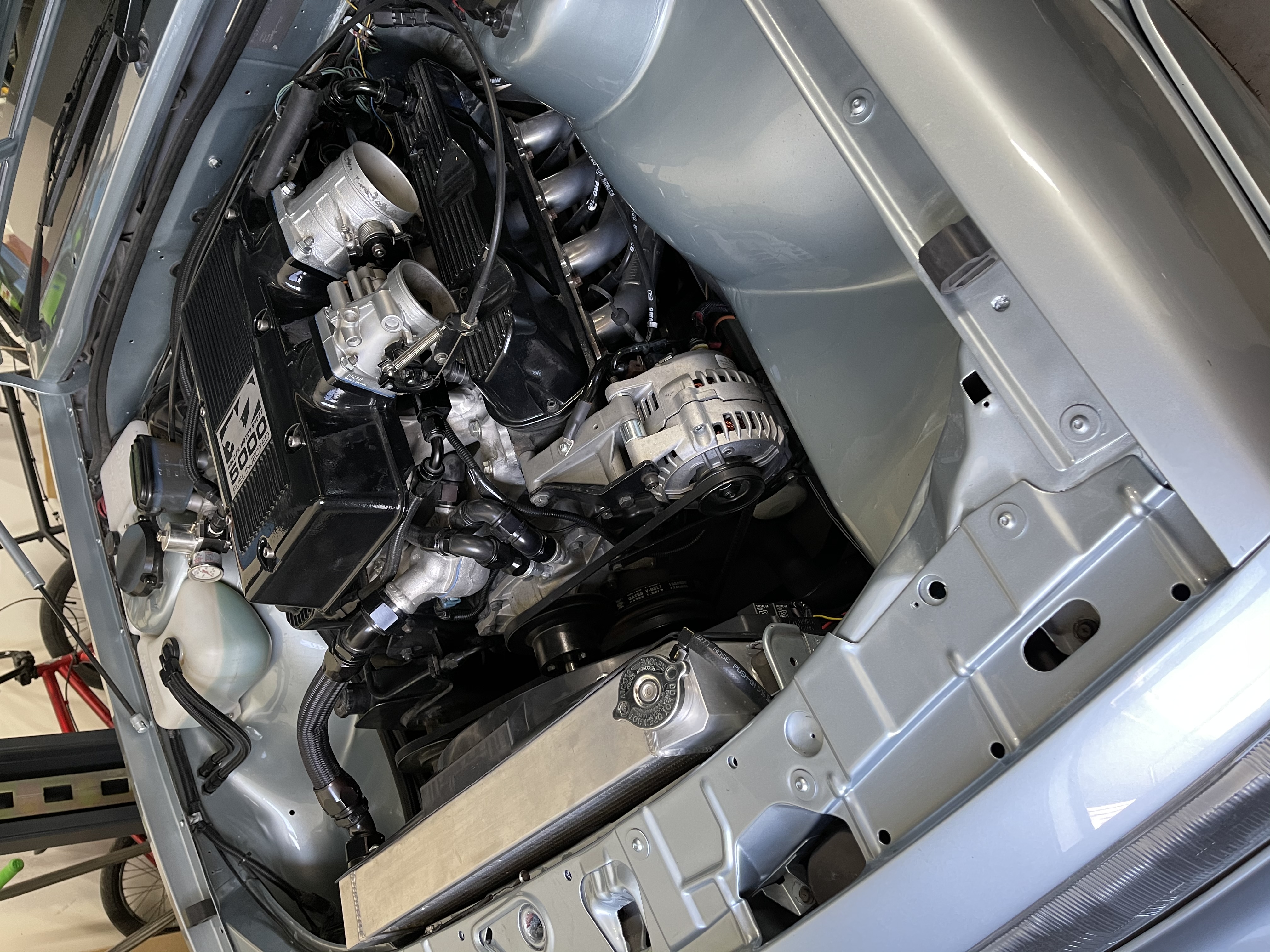

Re: VL Walkinshaw High Idle Issue
The setup

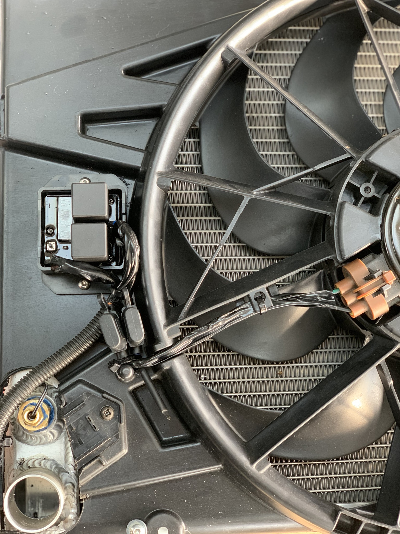

Cooling set up

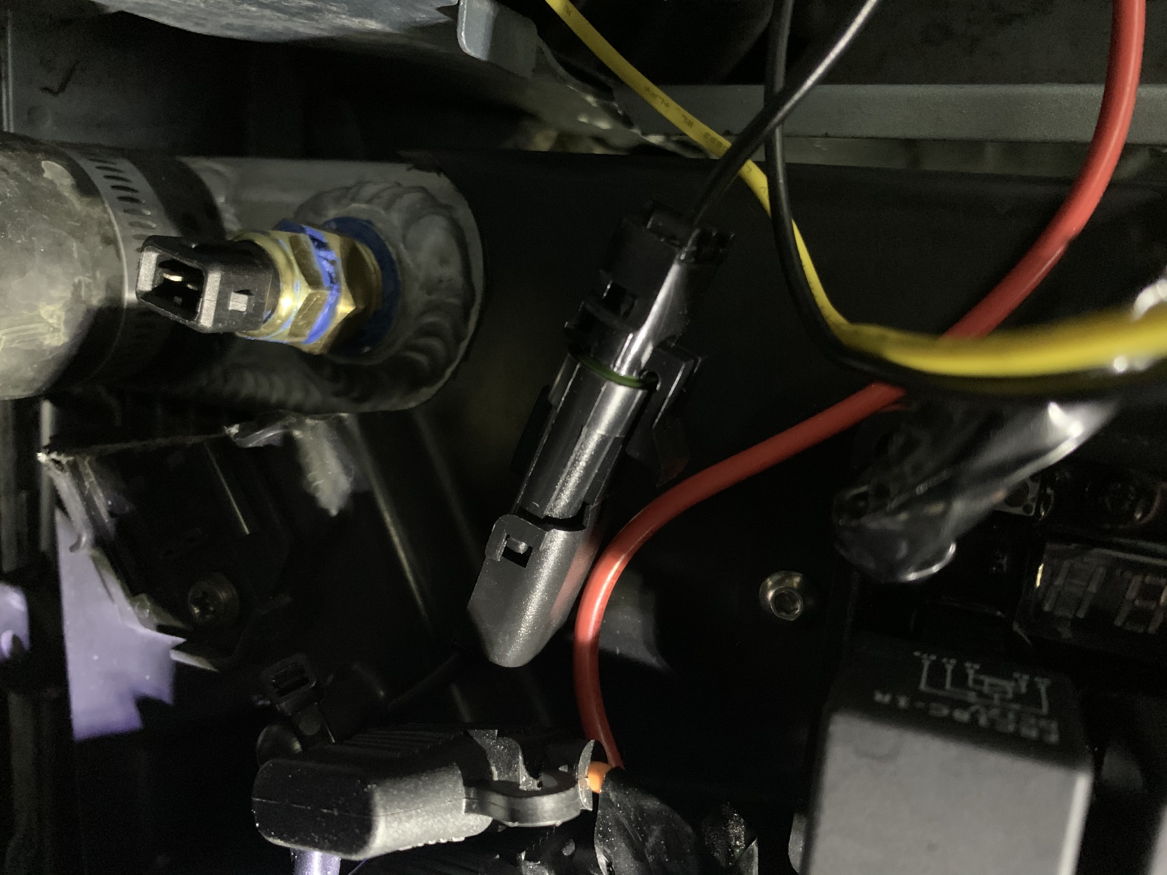

I’ve since changed the probe style to below.
