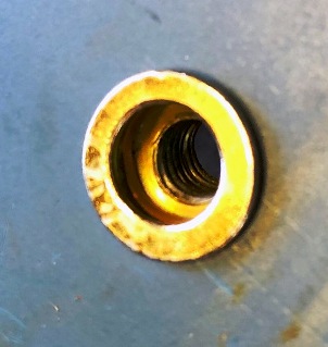

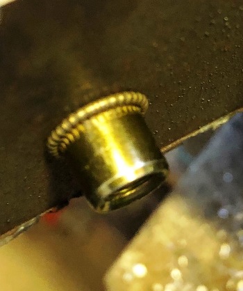

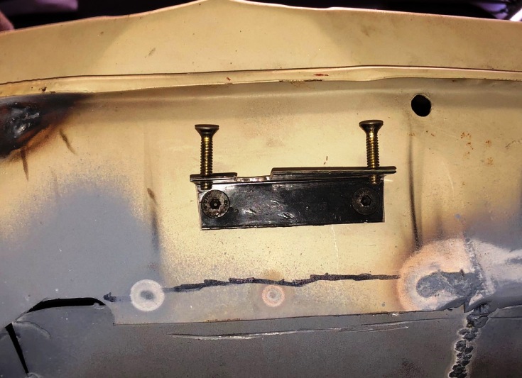

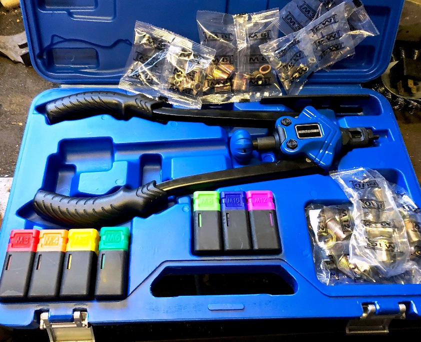

So its been months since i worked on the car, but after getting this chrissy present i had to :)
These two are an example on an offcut
vs ss

Noice, gotta love nutserts. Looks like it pulls up nicely, not like some I’ve seen. :thumbup:
yeah it looks decent enough! the two in the above were actually metric (something i had left over) but i need to see if i can find imperial bits so i can do some other stuff on the car cause i dont really want to have to change to metric where its imperial already.
But the main reason i wanted this was for the engine cover on the bedford to screw it to the floor using them.

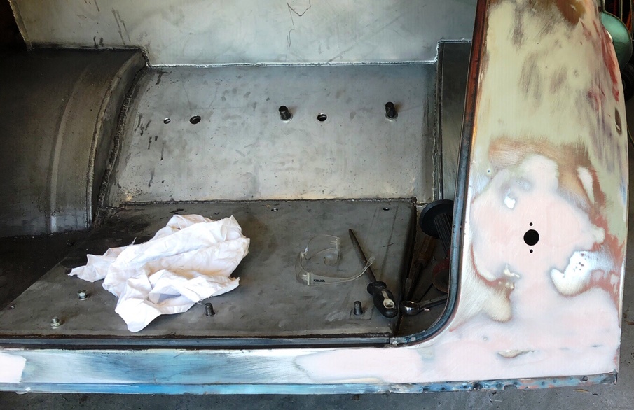

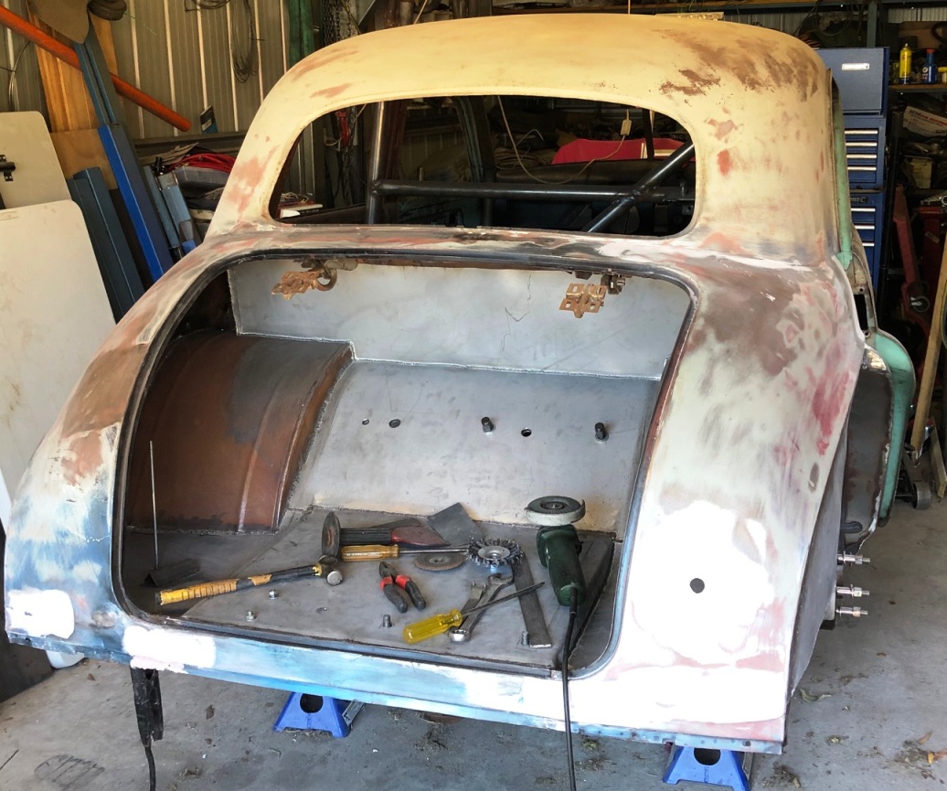

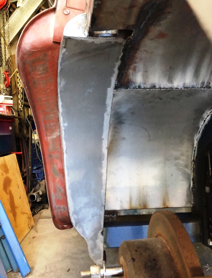

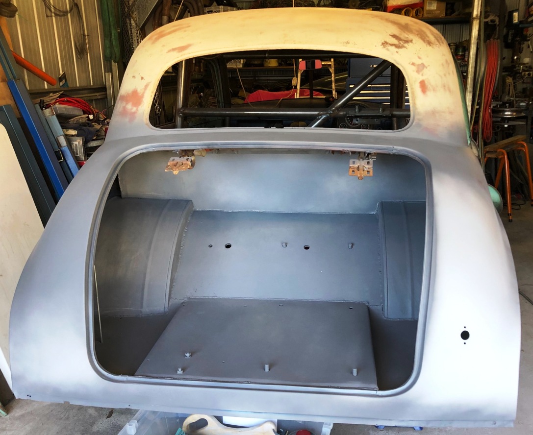

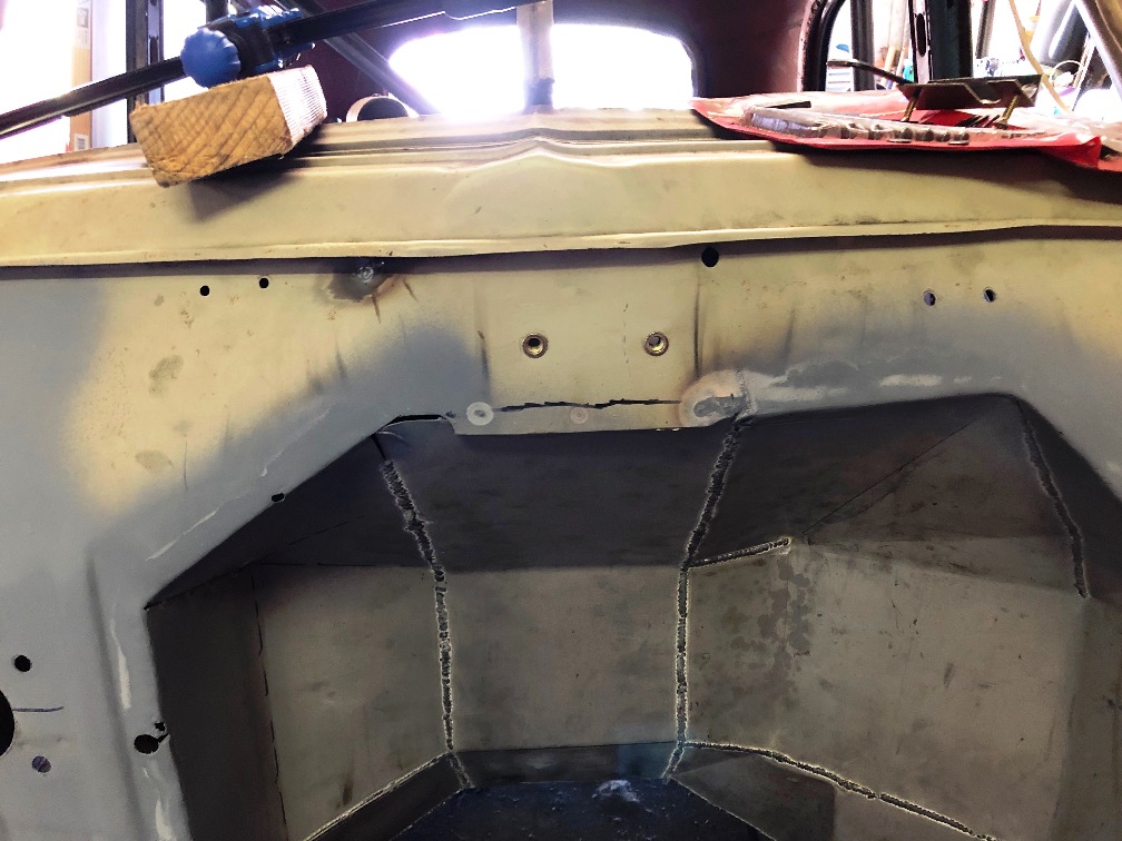

Despite stinking hot weather with dads help we got a good bit of panel work finished, the whole rear is now primered (needs a few more touch ups with some spray putty in a few spots.)
This back section was pretty fucked from previous owners rust repair (section below boot) but we did the best we could and used bog for the rest hehe :)
This is a spot where i had some surface rust, use rust converter and steel wool :thumbup:
Even though it needs more work, primer makes it look so much better!
Next plan is to remove the diff and paint under the floor.
