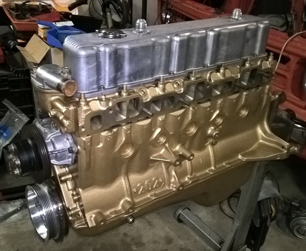

vlad01 wrote:Are those yella terra alloy heads for 202 any good? Ever used one?
Unfortunately they're only available with a large combustion chamber, 60 & 70 something cc, so require welding to get a decent chamber shape & volume. Probably ok for forced, but not n/a.

v6bucket wrote:Unfortunately they're only available with a large combustion chamber, 60 & 70 something cc, so require welding to get a decent chamber shape & volume. Probably ok for forced, but not n/a.
just mill it down don't they have a real thick deck?
Re: My Delcoed Rides
yeah you can do that, my high comp 202 has a 36cc chamber (13.5 comp and zero deck height), and this motor is 47cc chamber (10.5 comp with .018 deck height), not optimal though, valves hit the block with that much taken off and high lift cam!

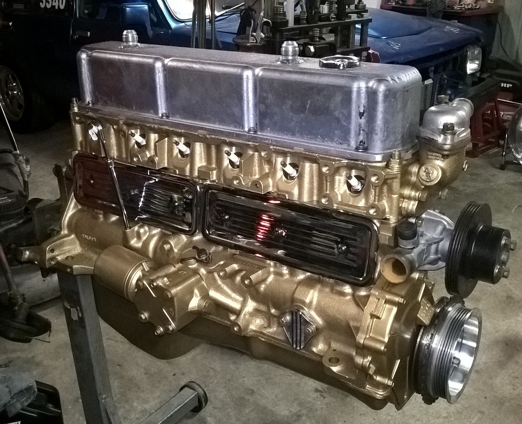

I didn't know Ryco made a VHT Gold oil filter... :wtf:
They don't, its dupli colour gold :P
