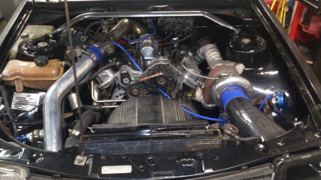

getting excited now new paint new convertor no powersteer hoping to do its first ever boost launch tomorrow during testing :D
Posts: 5636
Re: DELCOS NEW RIDE
couldnt get any avgas today bit of a bummer but still got it running. went to start it and it was so empty it wouldnt even start must of evaporated away we drove it in there LOL.chuck 4 or 5 litres of pump gas in there on the avgas tune fired it up on axle stands run through the gears checked all the fluids.then we had to have a small attempt at building boost 7psi with the tyres just starting to turn less than half throttle looks like a win so far.some avgas tomorrow and time to get it on the ground and see just how far we can go butits looking like a win looking like we are going to have the same launch rpm but 10-15 psi more boost at launch LOL i have a fealing we may go more than a little bit into the tens if we can still hook it up
Re: DELCOS NEW RIDE
yeah I can speak first hand for how much a few tenths in the 60 foot makes!
so whats the converter change higher stall than before ?
Posts: 5636
Re: DELCOS NEW RIDE
Same stall but it's a nitrous converter. Has anti ballooning plates front and rear and the direction of the vanes is totally opposite to stop it flairing when you hit the nos or boost seems so far to do as advertised
Re: DELCOS NEW RIDE
ahh right :) so how did the test runs go today hehe ?
Posts: 5636
Re: DELCOS NEW RIDE
just waiting for the owner to turn up with avgas :D and oh yeah i have to maybe burn a new chip it may have gone 11.02 on the backup resistors LOL havnt had a check engine light for a while and yesterday found the power feed to it broken reconnected it and key on yip light works start car light stays on Hmmmm goto flash codes nope light still hard on no flashy flashy.fit a new ecu and do a few check tonight before we go driving its been starting and idling a little off every now and then maybe this ecu is toast or maybe the eprom is dead after we had an ecu die and the car kept shutting off mid pass
Re: DELCOS NEW RIDE
yeah but if it was in limp mode wouldn't it have the fan on all the time ?
