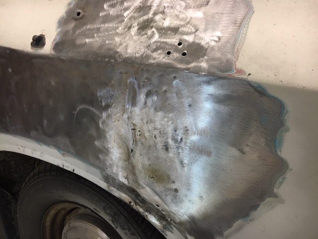

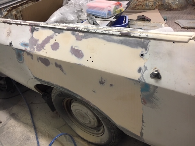

Hi all, this area had been annoying me for a while and I knew there was something ugly under there. They must of had a rear quarter replaced and where they joined the two panels together was a ton of bog. They just caved the two panels in and stitch welded. When I cut it open it came back a lot closer to the correct position so not so much filler was required. Once I welded it together I filled the welded join area with reofill so its no to be problem again.
Still a bit of work required on the body line.
Re: 265 Hemi to efi
nice job, looked pretty dodgy before hand!
heff0018
Posts: 1045
Re: 265 Hemi to efi
Post by heff0018 »
Thanks Sam, just has got me stuffed why they caved it in so far and why they plug welded it. It took me about 15 minutes to weld it properly. I ground about 1/2 an inch of bog out of the repair and put back in a couple of mm of reofill.
