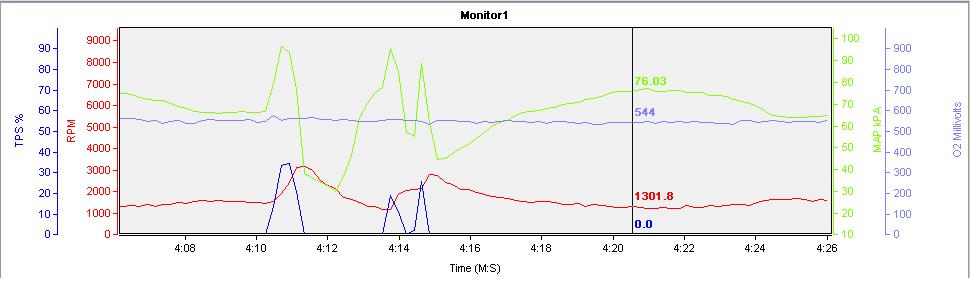

Yesterday I finally got around to running the fuel lines under the car (instead of over the roof where they had been), and thought I should probably drain the tank before connecting it up.
Lucky, because what came out didn't look much like petrol at all! I started tidying up the engine bay too, bolted down the ignition module and fixed up a few bits of dodgy wiring. It's still running really rich. I wired up the NB O2 sensor this afternoon and got the engine up to temperature, but the O2 voltage wasn't responding like I expected it to so will double-check the sensor earth etc before trying again.

do you have a log or screen shot of what its doing ? is it varying from 450mv ?
Re: another Alfa Romeo conversion
I think the alfa might have been on the guinness on NYE, petrol shouldn't have a head!Holden202 wrote:you sure there wasn't coke in your petrol tank
The O2 voltage was varying a bit - I saw 5-600mv but it didn't really change with revs (or even changing KINJFLOW) - I took a log this morning but it was still saying O2 not ready after 10 minutes this time, so no point posting it.

ok heres a monitor log of a mostly normal NB o2 sensor, the bottom monitor blue and green ones, this is in an ecotec .... don't worry that they are not the same, thats another issue
so what i would expect to see in cruise mode (closed loop) it will swing from rich to lean every half a second or so, then as you mash the pedal and go into the richer than 14.7 areas you should see it go up to 800-900ish mv for WOT obviously if you tune it lean then it will be a lower number, but thats the general feel of things, it does sound like yours is cactus, weather its the sensor or wiring is for you to work out

That's the sort of thing I was expecting to see - but mine looks more like this:
I'll swap the sensor out and see if that makes a difference.
