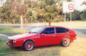

Here's a couple more pics I found from the last time I had it out on a track... it was 2006 :oops:

good to see another alfa conversion underway! nice car btw, good offset wheels aswel, just needs to be lowerd a bit ;) is that the only alfa you have?

BradGTV wrote:hi,
No, there's another lurking in the shed next to it.
Those are old photos though, it hasn't been driven in about 10 years :(
You'll notice that those wheels in the other photo actually belong to this car, they were only on the track car temporarily - I normally run a set of 16x7s - hence why with 14" wheels it looks too tall.
