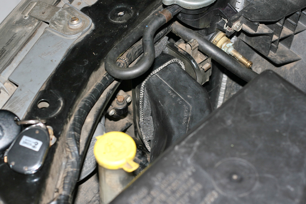

yeh vs v6, mace airbox with pod, though i havn't cut the window wash bottle pipe i just cut a hole in the lid so i could leave it long and still useable, anyway ive checked but even if i cut the pipe i wouldn't fit the whole box in there. So ive gone back to stock setup but done this, put some rubber pipe on it to make it longer, put a strip of foam in to block the bottom half, give it a go, should only get air coming from outside and should be blocked from radiator and interior heat. thoughts?

here is another idea.
cut the whole bottom half of the air box off, leaving only like 30mm or something from the flange. make up some brackets or mounting system on the bottom, that way it should fit inside easy as you have effectively taken off more that a 1/3rd in height and the bottom is fully open to draw air.

yeh was only trying to fit the top half in the box and line up the intake hole, ill see how this goes first, if not mod time.

Well that setup above with stock system gets good temps, but has bad flow with just the stock inlet pipe, WOT is maxing at 8400hz on the MAF about 4.5k RPM and then leans out to 14AFR lol, usually up 8900hz, so tried fitting the box without the bottom in the mace box but no go. So the only other solution would be rigging up another pipe.
