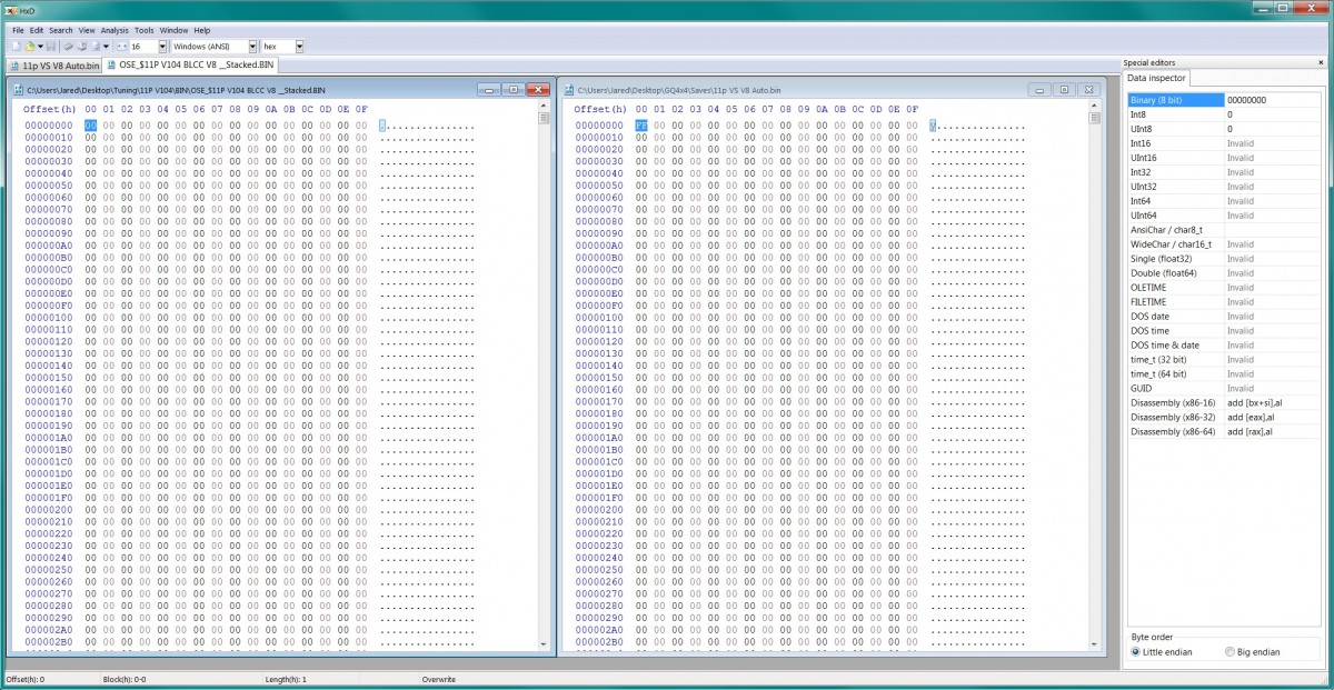

Now a question for Antus and VL400, or anyone else that knows...
Should the VS V8 NVRAM bin that I read from the NVRAM Antus just sent me in the mail only weeks ago vary from the "OSE 11p V104 BLCC Stacked" bin I downloaded from 11p thread?
Total n00b to this programming in assembly language thing, but I wonder why they vary?
Posts: 9011
Re: VT V8 304 MAF NVRAM -> VS V8 MAP NVRAM + M122 SC Convers
It is possible thats an error on my part. Did I set the PCM jumper before shipping? If the PCM jumper is not set, I can send you one (or if you have one, you can just add it). If it is set then it could be because the start of the nvram maps over the top of RAM, and the ECM has written to that address which has been stored on the NVRAM as well as RAM. Is that the only difference? addresses lower than 0x1000 can be ignored (and are, from the pcms point of view). As there are two banks on the nvram, the same is true of 0x10000->0x11000 for the other bank. Its also possible that is they byte 11P uses to check if an NVRAM is installed when it starts up. I know it does a test write/read cycle, I am not sure of the address. It could make sense that it is there.

How different are they? In which locations?
