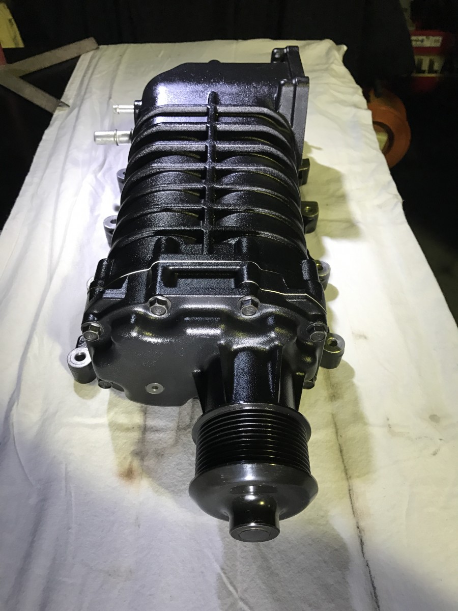

All has been going well, but I really want to move into mapping VE tables as I have an Eaton M122 Blower to go on this motor and I believe the current factory TB and MAF arent going to cut it once the blower is on.
The vehicle is nowoff the road and I have time to really play with this motor and trans. I will be building a roller Dyno (no hydraulics as yet, just for safe "Off-the-road" roller tuning)
After I have the Motor and Trans really banging, I may engine swap them into a much more interesting body... but we'll see.
I am milling the intake to house the M122 and will also find suitable Seimens Deka Injectors (maybe 60 or 80lb) to suit the 7-10psi I will be running the Eaton at.
