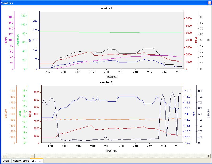

maybe someone can inform me if im going blonde at the moment .... i was looking at the long log and i've noticed 2 minutes into it, the car takes off from a stop and pretty much as soon as it takes off its lean, as in 15.7 afr is being commanded and the o2 that is working is below 100mv .... this stays like that till decel
to me that doesn't seem right, nothing should be commanding lean cruise till you've been moving for 150 seconds and doing over 78km i think it is ... so it should be that .... so what is it ?
if those numbers are right, this thing must go like a sack of shit when thats happening!

I'm not expert but isn't the O2 sensor voltage the yellow line in the second graph you have put up which doesn't get below 400 mV
I finally found the adx file
to have a look at the log. There are alot of error occurring in the log also the o2 ready flag turns off and on and the cylinder select is changing from 6 to 8 alot.

sorry, the forum has cut the right hand side off ....
have updated the picture!
one of the o2 sensors is the orange one and the other is in black.
