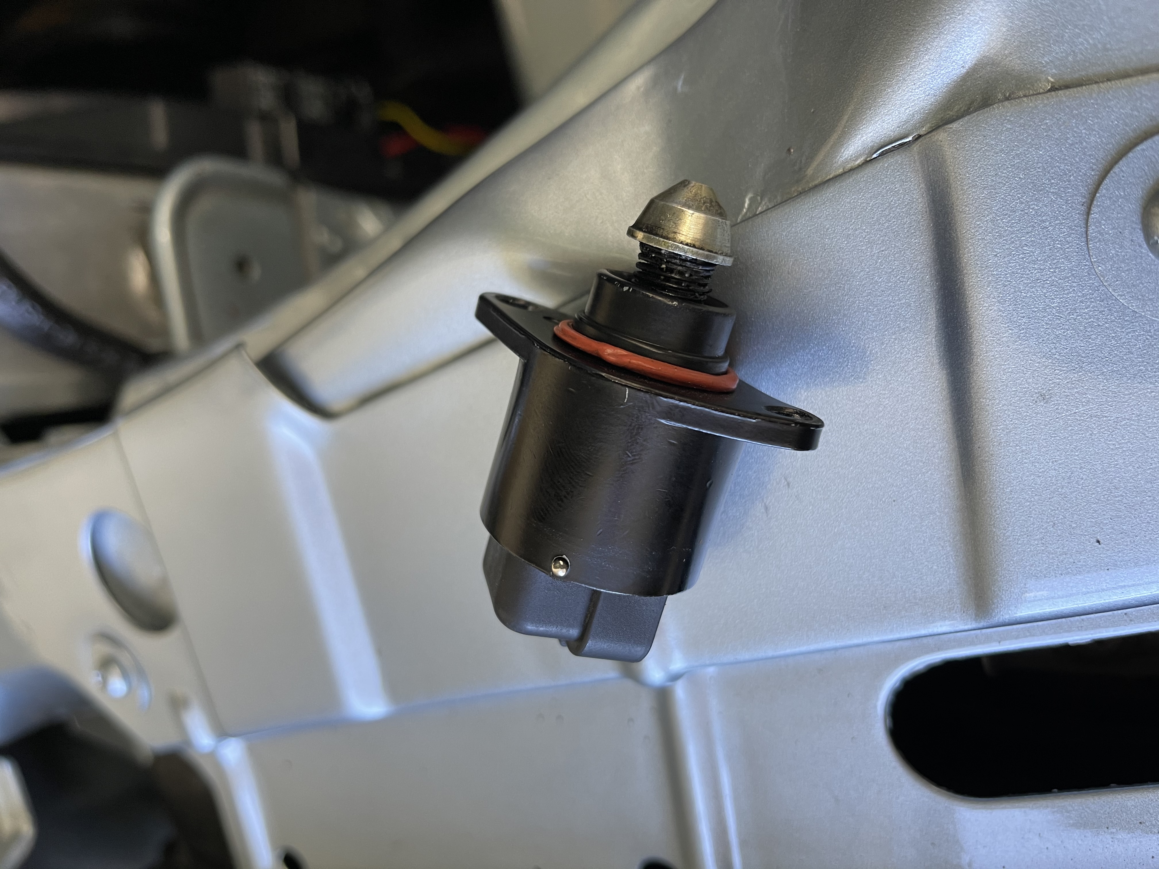

That o-ring is pinching and is in the wrong spot.
Refer to the link re-IAC's I sent. page 8
'quipt4it
- Posts: 675
Re: VL Walkinshaw High Idle Issue
Don't re-use it. You'd be better off using a proper o-ring in place of that soft-ass POS.
Likely leaking as well.

Yea it’s not the IAC in the photo but that is the style I have.'quipt4it wrote:Don't re-use it. You'd be better off using a proper o-ring in place of that soft-ass POS.
I’ve tried 3 different gaskets now and is not doing that well. I’ve stuffed around with screwing the throttle stop screw and adjusting the TPS to have the voltage down. At start up it throws up to around 1500rpm and the IAC slowly stops bleeding until it stalls.
It will idle around 1100-1200 but as soon as i try to bring it down it will hunt to a stall.

Is that a spare IAC then?
Just for sh1ts & giggles, throw that one in there

I had it in there but have done back to the genuine one. Just switched o-rings off the genuine one. I’ve left the orange one on their to remind me.'quipt4it wrote:Is that a spare IAC then?
