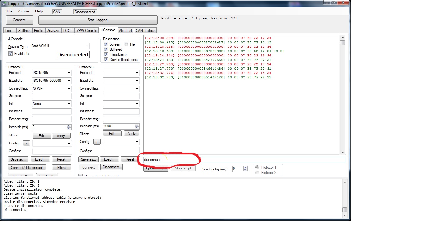

Gampy, you can type any j-tool command that is supported in script or a message to the bus, and hit enter.
There is no send button yet, but enter works fine.
In v22.08 you can use
connect
and
disconnect
connect works with currently selected setting in protocol1 setup dialogs.

Yes sir, I'm very aware of all of that ...kur4o wrote:Gampy, you can type any j-tool command that is supported in script or a message to the bus, and hit enter.
connect
and
disconnect
What I am looking for is a way to send results from things like a Flash Chip ID script or a Key Brute Force script to the Console Pane (the very bottom full width pane).
That information is hard to pick out for those that are new and do not understand how to pick the results out of the busy log!
Thank you!

Now I see what you mean.
I was thinking about some pop-up window that prints report[also converts it in various way], or data enter dialog, for changing vins for example but never got to that point.
The simplest will be to specify a command for printing to log specific responses.
Hope it will be in next release, when joukoy have some free time.

Is there something amiss, or is this all there is with a P04 at this stage ??
And the text if the image cannot be read ...
-Enjoy
