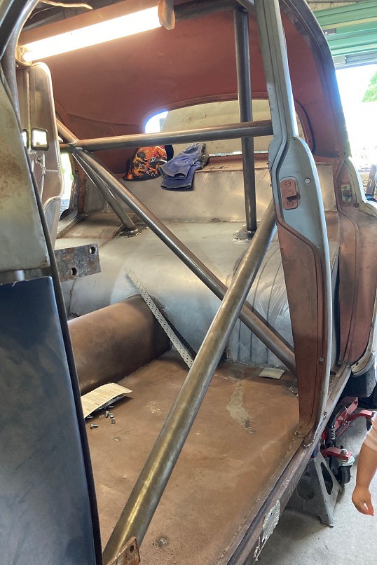

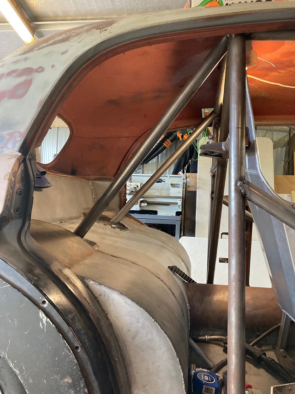

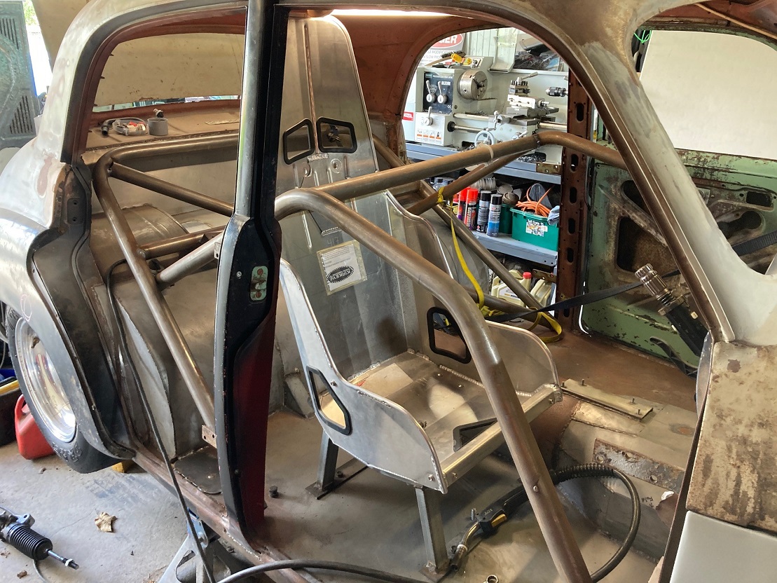

Finally had a good use for dads new plasma cutter, and oh how it makes quick work compared to the grinder! So used it to cut out the roll cage mounting plates and also do the radius on the corners to suit ANDRA's reqs.
It was a bit of a jigsaw puzzle that had to go together in a certain order!

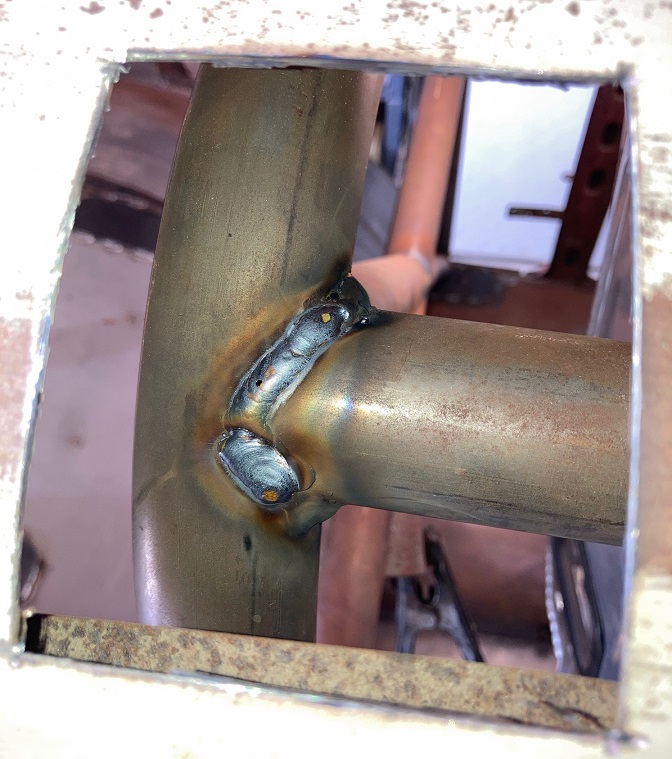

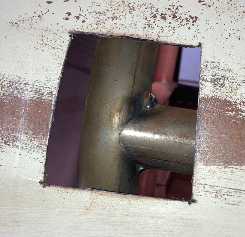

Unfortunately there was no way to maneuver the cage to get at the top of the joins once the main hoop and forward supports were joined! :(
So after lots of thinking and failing i had to bite the bullet and put some holes in the roof to get the welds completed, i did cry a little bit inside!
From there it got a lot easier and came together pretty quickly, probably mostly because i had most of the bars already made, some needed minor trimming.

I need to remove the seat and the steering column now so then i can get in and finish a few welds on the cage, then its time to flip her on her side and start painting underneath!

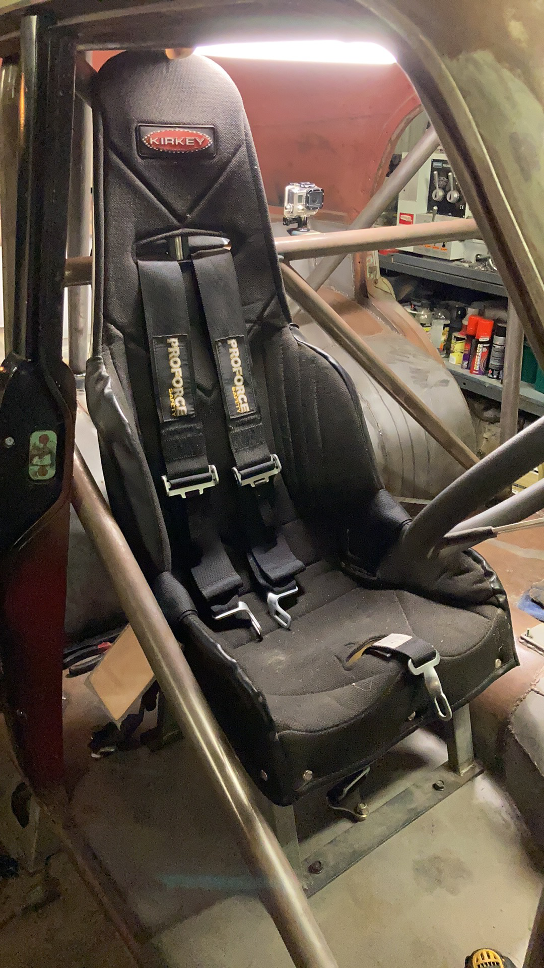

Seat looks comfy.

Charlescrown wrote:Seat looks comfy.
how about now Charles ? :)
