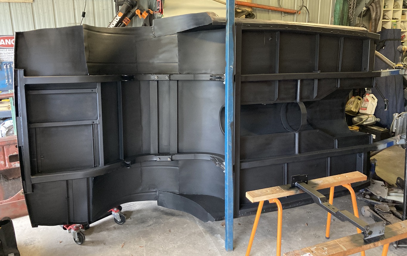

Great week of progress, got the car stripped down and flipped onto its side again to finish painting under neath.

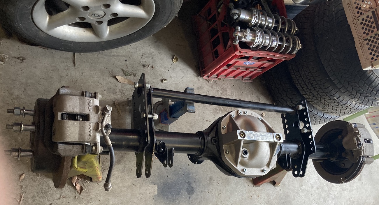

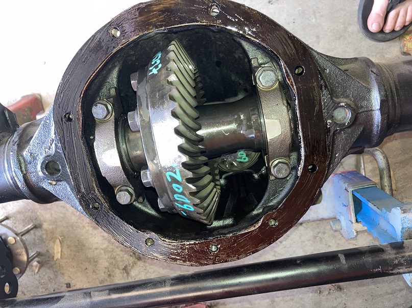

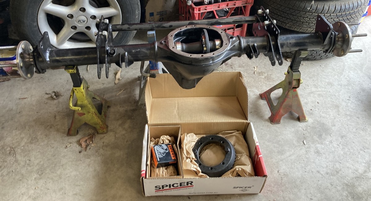

So now that the diff was back out i was able to get the nice new 4.11 crown wheel and pinion installed.
Back plate on for good and the carrier cap girdle screws torqued up! :) 5lb/ft tension.

So with the car on its side and a handful of underbody coating spray cans we set about getting her all tidied up!
Certainly having the one colour makes it a lot nicer to look at!

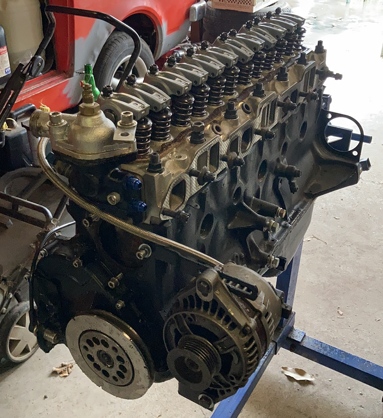

While i was waiting for the paint to dry on the body i got the tappet cover off the motor and re-did the tappets as i had backed them all off when it came out of the car a few years ago.
Also replaced the water pump (which for some reason corroded where the remnants of water were sitting in the bottom of the block!!) and put a new oil filter and oil in it.

Was there much setting up to get the backlash and bearing preload correct?

Charlescrown wrote:Was there much setting up to get the backlash and bearing preload correct?
the hardest bit was getting the crush tube squashed (my dewalt 1600 torques inpact driver helped alot though :)) the preload on the pinion i usually just do by feel, mind you i'll be checking it all after its been run in anger just to make sure nothings moved and made play, ie. a bearing cup not 100% home ... as for the backlash i was pretty lucky that the shims that were in it originally when swapped from side to side ended up in the ball park which was good as i cant find my stash of shims!!!
