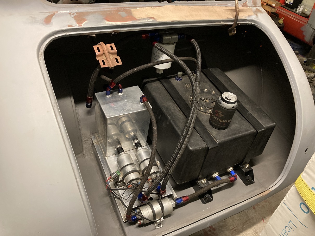

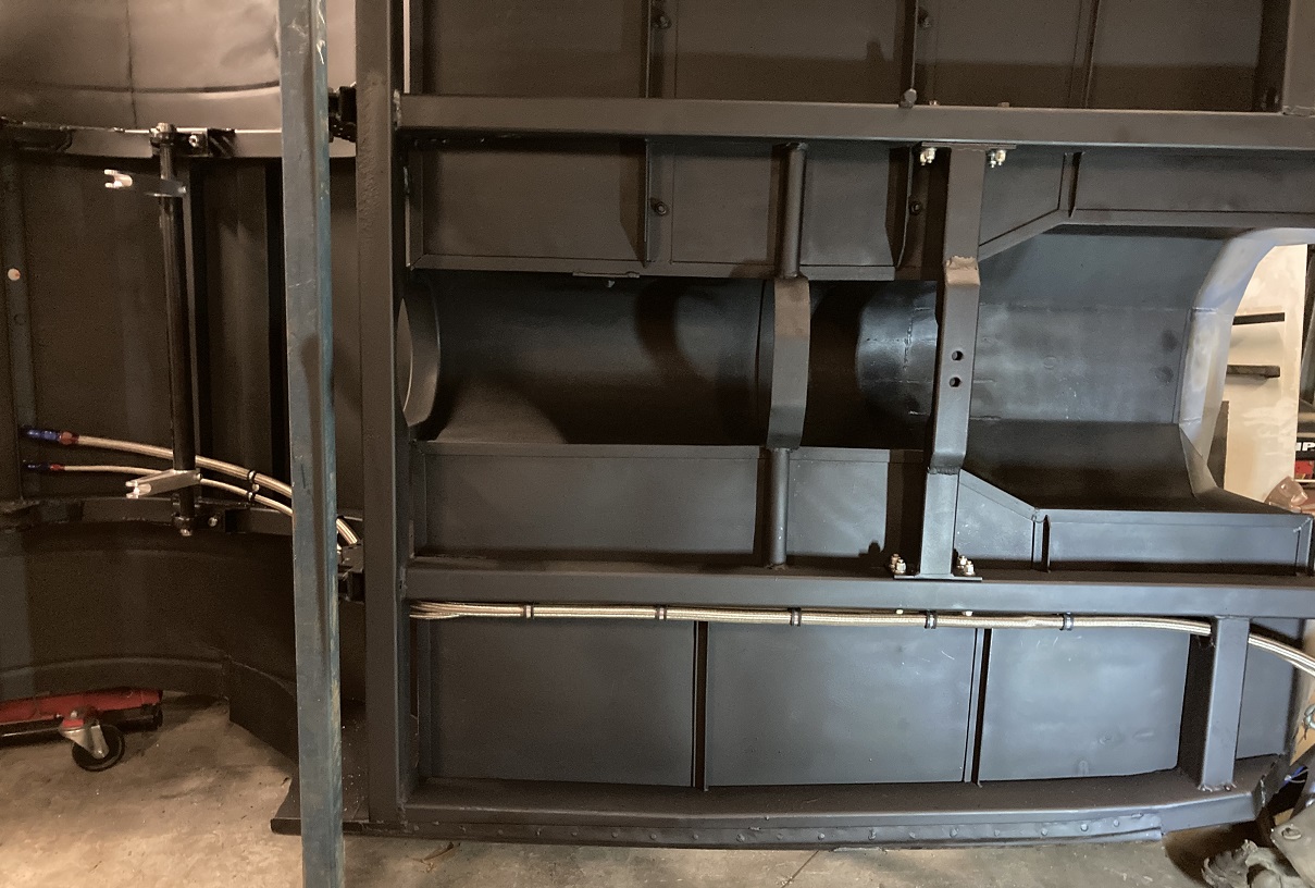

So while the car was on its side i thought it might be the perfect opportunity to fit the fuel lines and rivet them to the chassis, certainly much easier doing it this way than lying on the ground!

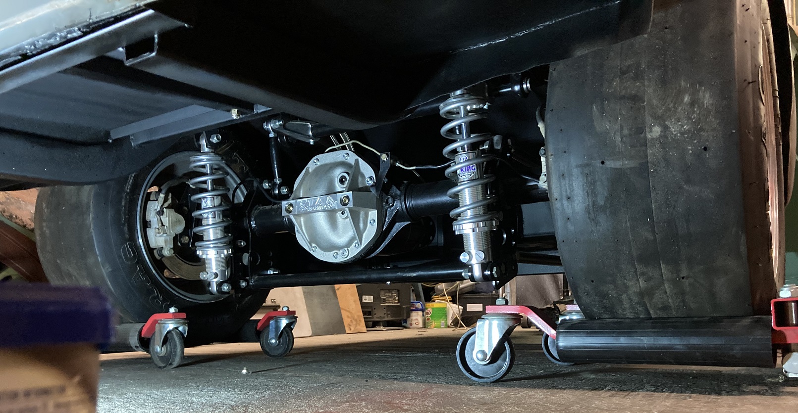

Last night got a few muscles over to help put it back on its right side, we then proceeded to fit the diff.
All business under here!!
We also chucked the fuel system in the boot.

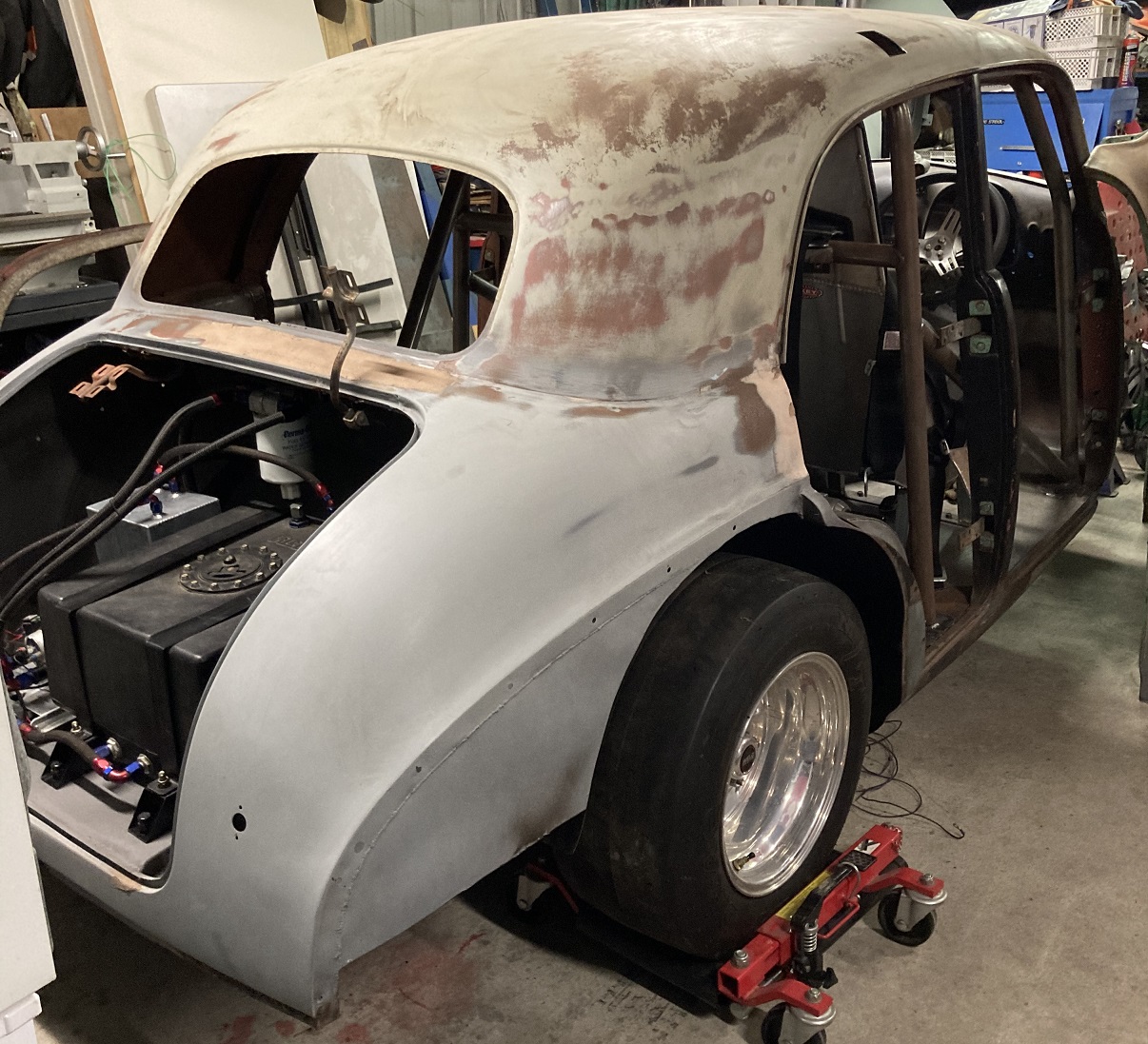

I now need to wash and paint the front control arms so they can go on, then theres a few small welding and grinding jobs i need to do on the front end of the car, so i'll probably try and sort them over the christmas break, also start fitting things like the shifter so i can drill the hole in the tunnel before the box goes in but shes slowly starting to come together!!

Looking pretty sweet ...
I just noticed you have a perimeter tube, that makes it hard to drop the cage through the base to weld the tops ... Unless done prior to install of perimeter tube.
However that also makes me question the andra rules or the interpretation of them on the use of base plates.
If you weld the cage directly to the perimeter tube you should not be required to use base plates, at least that's the way it is here ...
In the end, all that matters is if the driver is satisfied it's structurally sound and the andra technical inspector that inspects it, is satisfied.

Nice reference scale for the size of that fuel tank.
so when i started this car, the welded roll cage rules didnt allow it (or didnt specify) that it could be welded to the chassis, but recently they updated it to allow it, now the issue here is that the chassis member needs to be of the same thickness as the roll cage or thicker, which mine isn't, as its 2mm, and was only put there to replace very fucked out inner sills and also add some more strength..Gampy wrote:Looking pretty sweet ...
had i have known back then that i could weld directly to the chassis i would have made them 4mm like the inner chassis rails and 4 link frame! i also would have welded the cage in then laid the floor around it, which would have also allowed me to drop it down to weld the tops ....
i knew i had to put reference in a picture or i'd be shot! ... i was going to put it in every pic somewhere strategic, but it was 9:45pm and i was over climbing under the car so just did the onevlad01 wrote:Nice reference scale for the size of that fuel tank.
