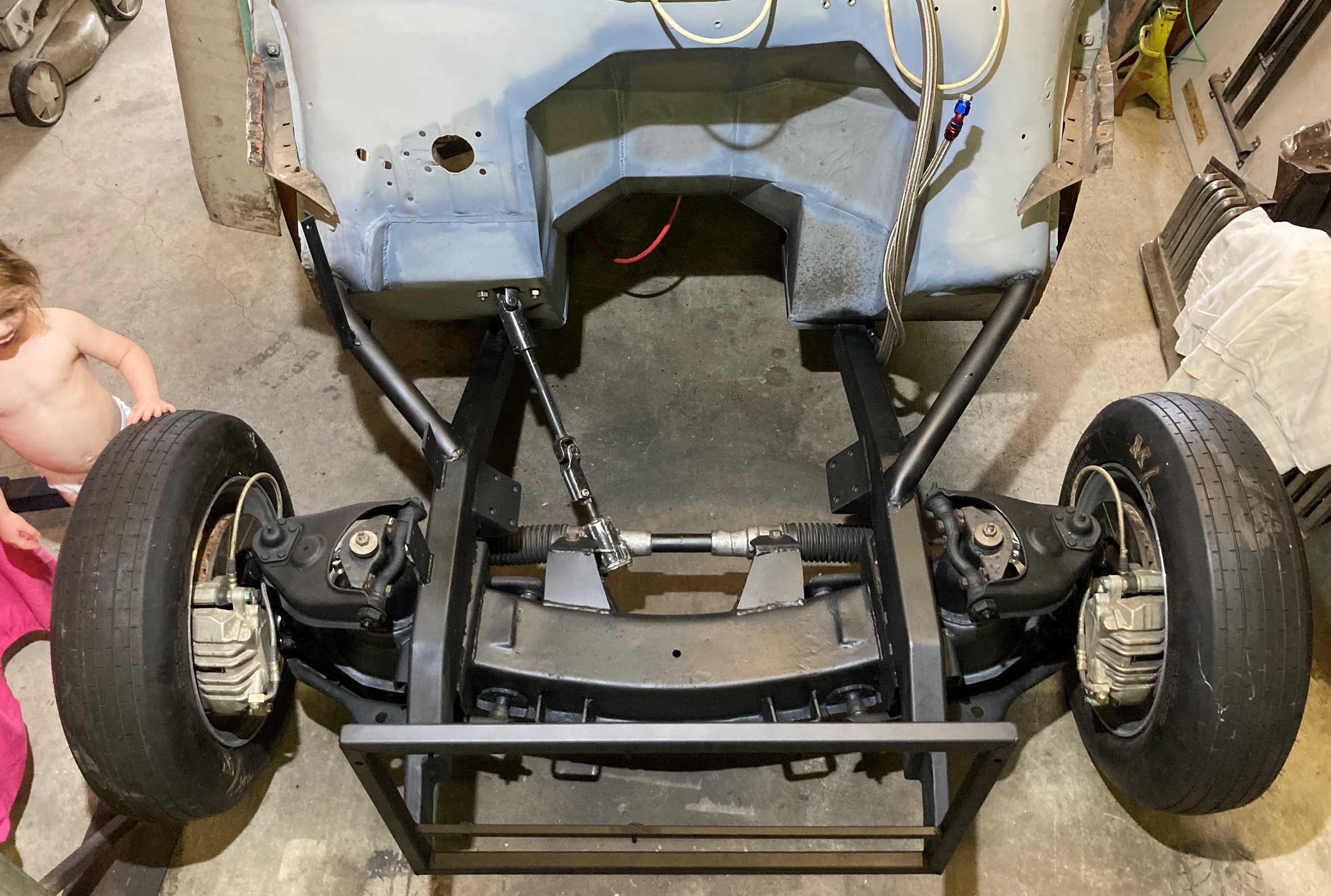

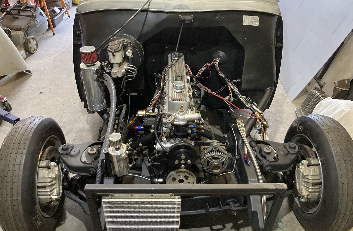

Got the front end all painted and its starting to go back together!
Engine and box will be going back in shortly so i can start getting the rest of the bits sorted out

Love the whole front setup. Is that HK/T/G crossmember? What are the rotor and calipers from?
its a HR front end, and the brakes are a hoppers stoppers 300mm twin piston kit, commodore pattern, but uses a falcon caliper

Well it should certainly pull up ok.Holden202T wrote:its a HR front end, and the brakes are a hoppers stoppers 300mm twin piston kit, commodore pattern, but uses a falcon caliper

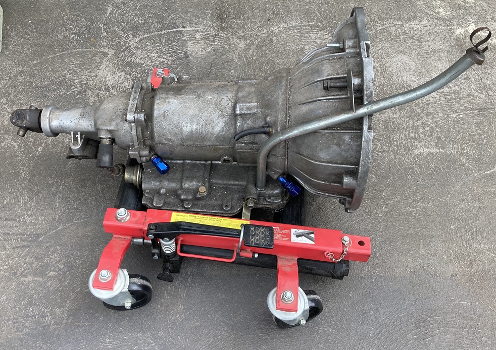

I worked out an easy way to move a gearbox on your own, i needed to get it out of the shed so i could give it a degrease, mainly it had dust and grinder shavings all over it.

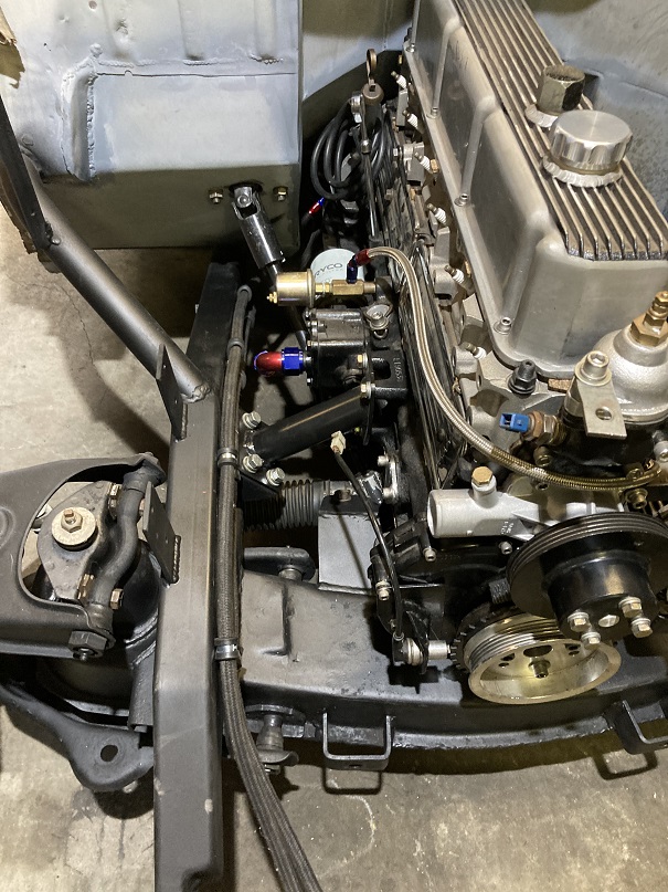

So i fitted the motor and box back in so i could get onto finishing a whole heap of things, like working out where to put rivet holes in the body for holding hoses and wiring etc. The oil cooler lines i had already done before the chassis was painted, so i got them in place before the motor went in.

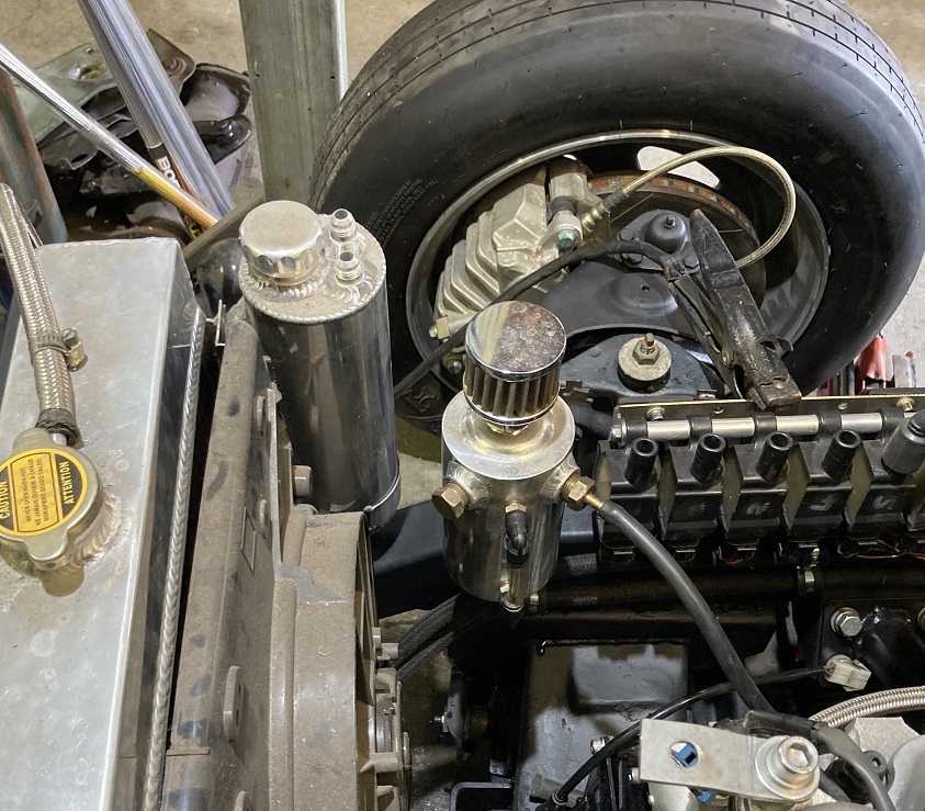

I then had to work out a spot to mount this breather can for the transmission, ended up using some old bits of pipe and a commodore control arm bolt to make a mount for it

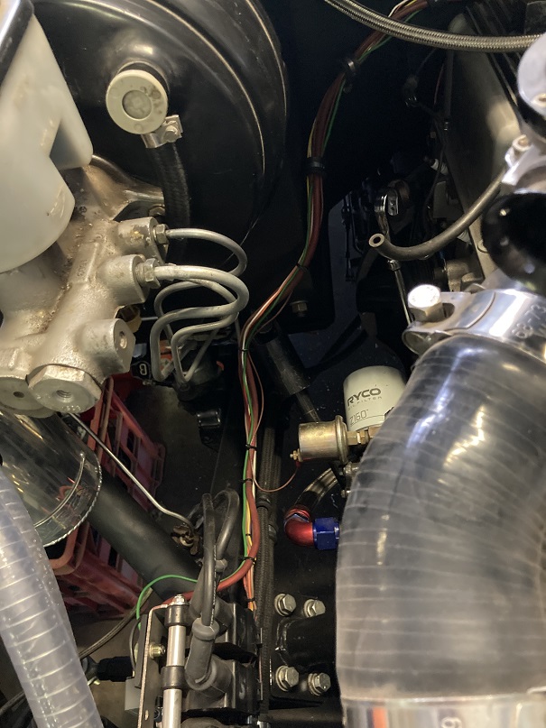

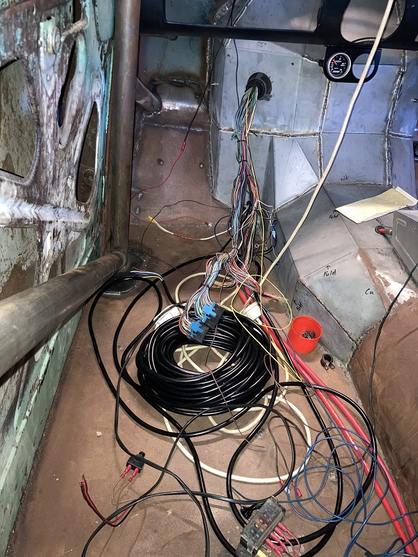

Got everything installed and then marked some spots on the firewall for the wiring loom, also fitted a bulkhead fitting to go into the cabin for boost/vacuum gauge ... also now the wiring loom is through the firewall i can start working out where to mount the ignition module and such bits.

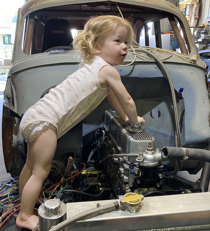

And of course i had my little helper, she loved un-screwing the oil fillter cap and the one on the radiator overflow bottle!

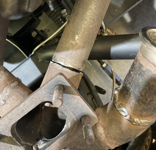

I noticed when i had it running originally that there was an exhaust leak from the head flange, so i cut the front and rear halves of the turbo manifold, straightened them up and then put them back together, there's still some filing to be done of the flanges but its no longer showing light through the other side with a torch now!
Also the brake line are all connected and bled, transmission lines sorted and shifter connected.

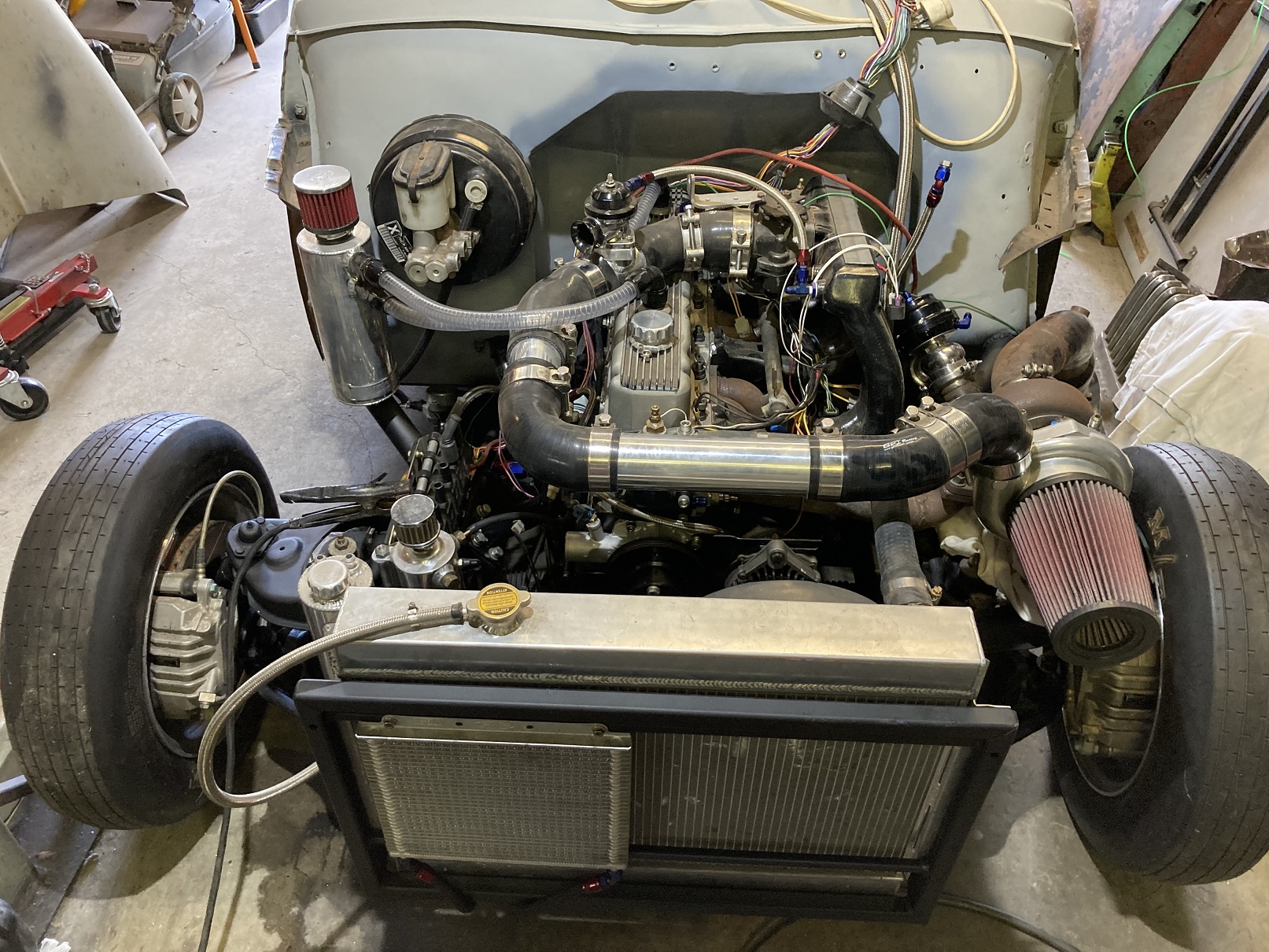

Got the firewall painted and the motor is in, hopefully for the last time this year! I've been focusing on the wiring at the moment mainly because its a job i can do when its stinking hot that doesn't make me any hotter, and its a lot easier to access most of it before i put the inlet/exhaust and turbo all on.
For those wondering why there is so much attached here, with the battery in the boot this is the best spot to run all the big power wires to for things like fans/coils and in cabin power etc.
Pretty well haven't started in here other than feeding some extra wires through to the cabin, mostly the EFI loom is done other than adding one or two wires for analog inputs/flex outputs to things, then its really just some relays and fuses and mounting the ignition module then joining it all to the dash.
the boot is mostly done, i have ordered a few relays which i am waiting on but all the wiring to fuel pumps and from kill switch is all done, i did end up running them round in front of the fuel tank as they are too close and the boot wont shut properly if they are at the back, few more p clips and some convoluted conduit and its pretty close.
