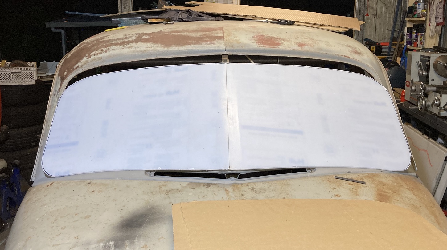

In other news, last night dad and I started on the window cut out, so we managed to get the front window mostly cut out, it needs some trimming on the edges but we chose to go on the larger side for the first one to make sure!
Its obviously sitting lower than where it should be but i couldnt get it to stay up and hold the camera at the same time!
we've also made a template for the side windows and started on the back one, as it got too late to make too much noise, but its moving forward at a good rate
i need to try and decide on a method to attach them, i have a few ideas but nothing locked in yet.
