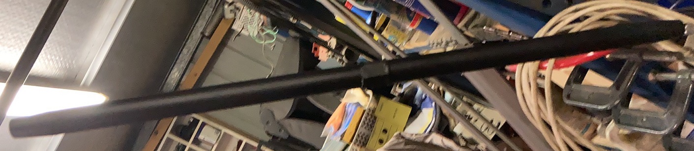

When i made the four link diagonal adjustment bar i cut it slightly too short, and i wasnt really happy with the amount of threads in the bar on the rose joints, so i hatched a plan to lengthen the bar and also added a hex section to allow a spanner on for adjusting.

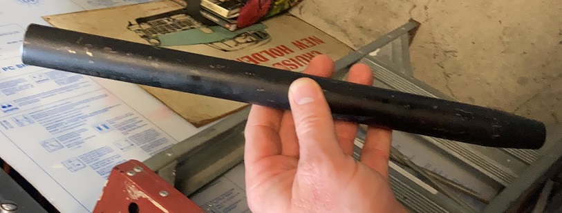

So i cut the bar in the centre...

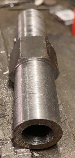

Then machined up a bit of hex bar to go inside it ...
And glued it all back together!

That tube looks like Chromoly ??
Rose Joint = Heim Joint ??
Gampy wrote:That tube looks like Chromoly ??
how can you tell that with paint on it ?
and yes heim joint :)

If you look at that cold rolled mild steel hex bar stock it will be a bit duller in tone then the 4130, chromium is a lustrous material.
But I must admit I really am guessing a bit for I really can't see the end cut of the tube so well, not to mention the white of the background tossing in a curve ball ...
A little Tap Magic would do wonders on the finish of them cuts and add life to the cutter.
You glue it with er70 mig ??
i wasnt too stressed about the finish of the cuts as they were going into the tube, i was more concerned on a nice snug fit :)
yeah was just mig welded.
Posts: 2332
Post by Gampy »
Yup, knew that from the spiral running the carriage back ;) ... was just pushing Tap Magic!
No affiliation, just have used it for 50 years, love that stuff, nothing better, it's Magic!
Did you pre heat the 4130 to 4-500F, then slow cool it ??
Those two will heat and cool differently possibly causing cold joining and or cracking.
Honestly, I don't think you'll have an issue, many have done it ... it's just ""more"" proper.

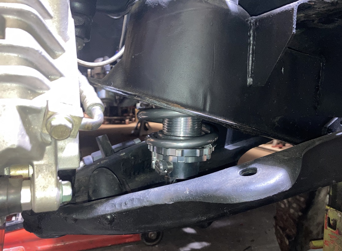

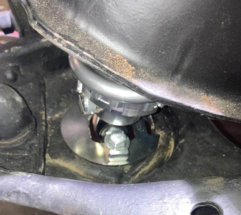

So the coil over kit arrived last week, been a bit busy but finally got to having a play with them this week!
I cant really get it to sit low enough at the front (its about 1/2 to 1inch too high), so i may need a softer set of springs, but i'll be racing it as it is to begin with and see how it all settles in before i change anything. Aside from that they are sweet as!

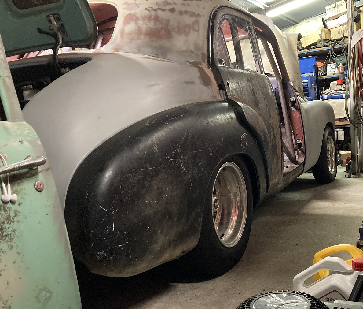

The car has been on stands for something like 6 months, finally got her back on the ground now!
The list is slowly but surely getting finished, the biggest work left now is fitting the front doors and front/rear windows then its got to be pretty close to getting a tech inspection :thumbup:

Holden202T wrote:I cant really get it to sit low enough at the front (its about 1/2 to 1inch too high), so i may need a softer set of springs
You do not want to use spring rate to adjust ride height ... Spring rate is a handling tunable, not a ride height adjustment.
You need to either change spring height or you need to modify the mounting points, unfortunately springs come in standard heights (lengths), not incremental heights.
Thus your only real choice is to either leave it, or modify the mounting points ... In the end you are going to want the ride height adjustable, and not be limited by lack of adjustment.
In some kits the upper spring retainer (between the spring and upper shock mount) are cones, some come flat, if you have cone shaped ones you can go with flat ones and gain a little more adjustment ...
