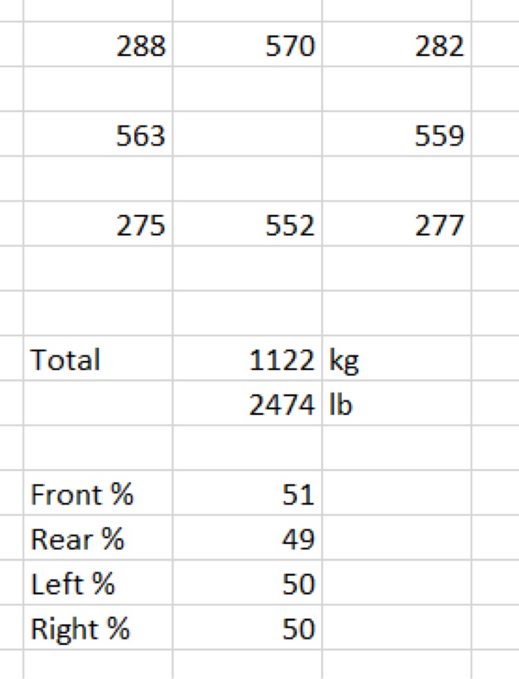

I completely agree with the above except that sometimes it isn't practicable to learn everything at one time, sometimes taking the advice of suppliers/experts is a reasonable supposition and considering that something like springs are a tuning tool and fairly easy to change it's not the end of the world. Real world experience (when it hits the track) will ultimately decide if other springs are required.
Considering this is a clean sheet build with a lot of unknowns (like corner weights of the finished car) some guess work is required. It's not like he's building a common car where there is a huge knowledge base in the industry to help you make decisions.
yeah i guess i have previous experience (ie. the gemini) to improve from, like adjustable rear end/shocks etc, but at the end of the day the car is totally different to the gemini so there's going to be a lot of difference just from that.
my aim was to improve on the past and take what i've learnt previously and apply it to hopefully have a more in tune symphony than the gemini was!
i too Gampy read, study, listen and take from it what i think is right ... and i'm not always right but its all i can do :)

She’s about 1260lb on the front axle so the springs are right on the borderline!
This is without me in the car too!
Posts: 2608
WOW, that's heaps lighter than I was expecting!!!!
Great balance too :thumbup: :thumbup:
yeah i was hoping having the engine rearward would help with front / rear balance! i think from memory the gemini was 52% front, so its ever so slightly better lol!
