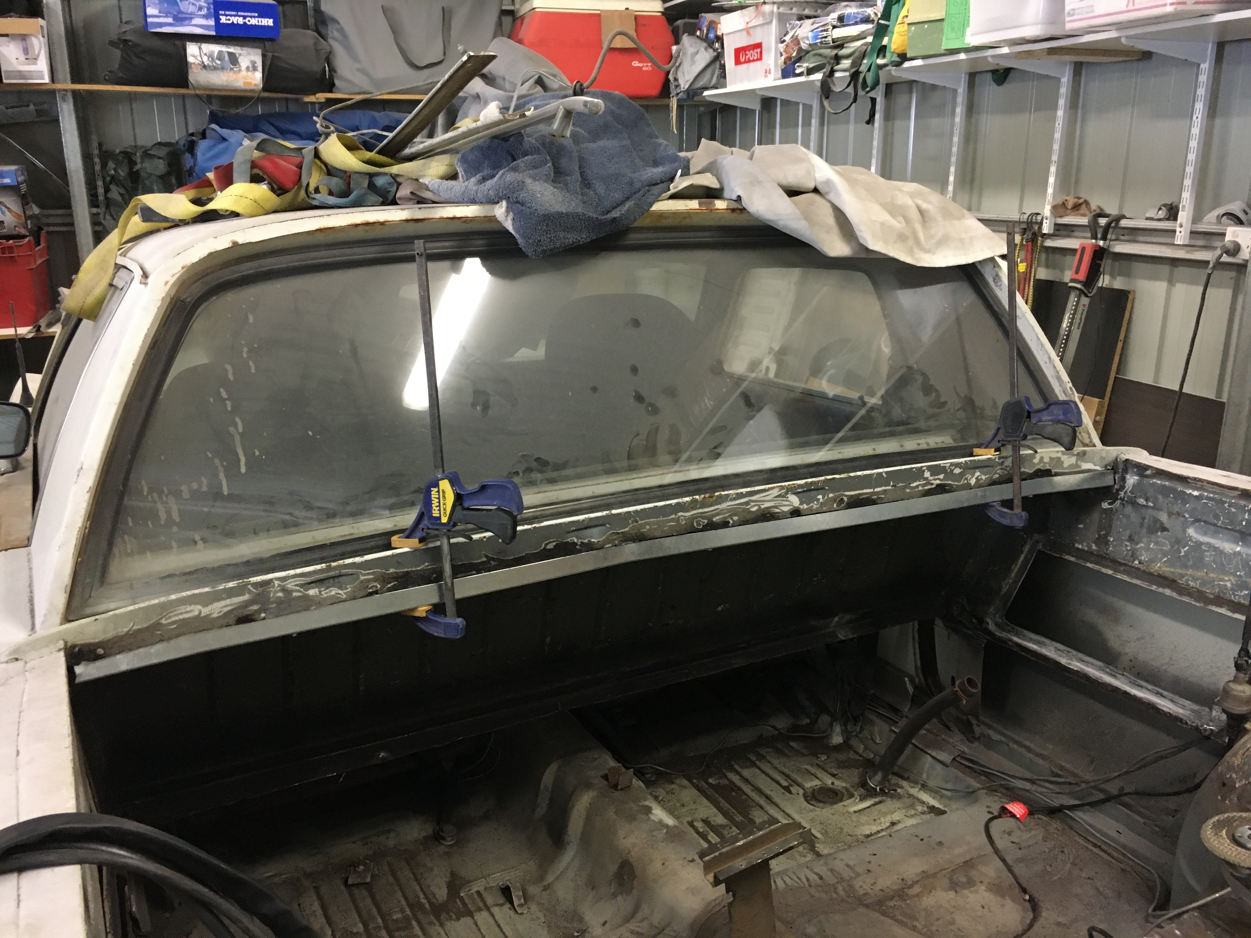

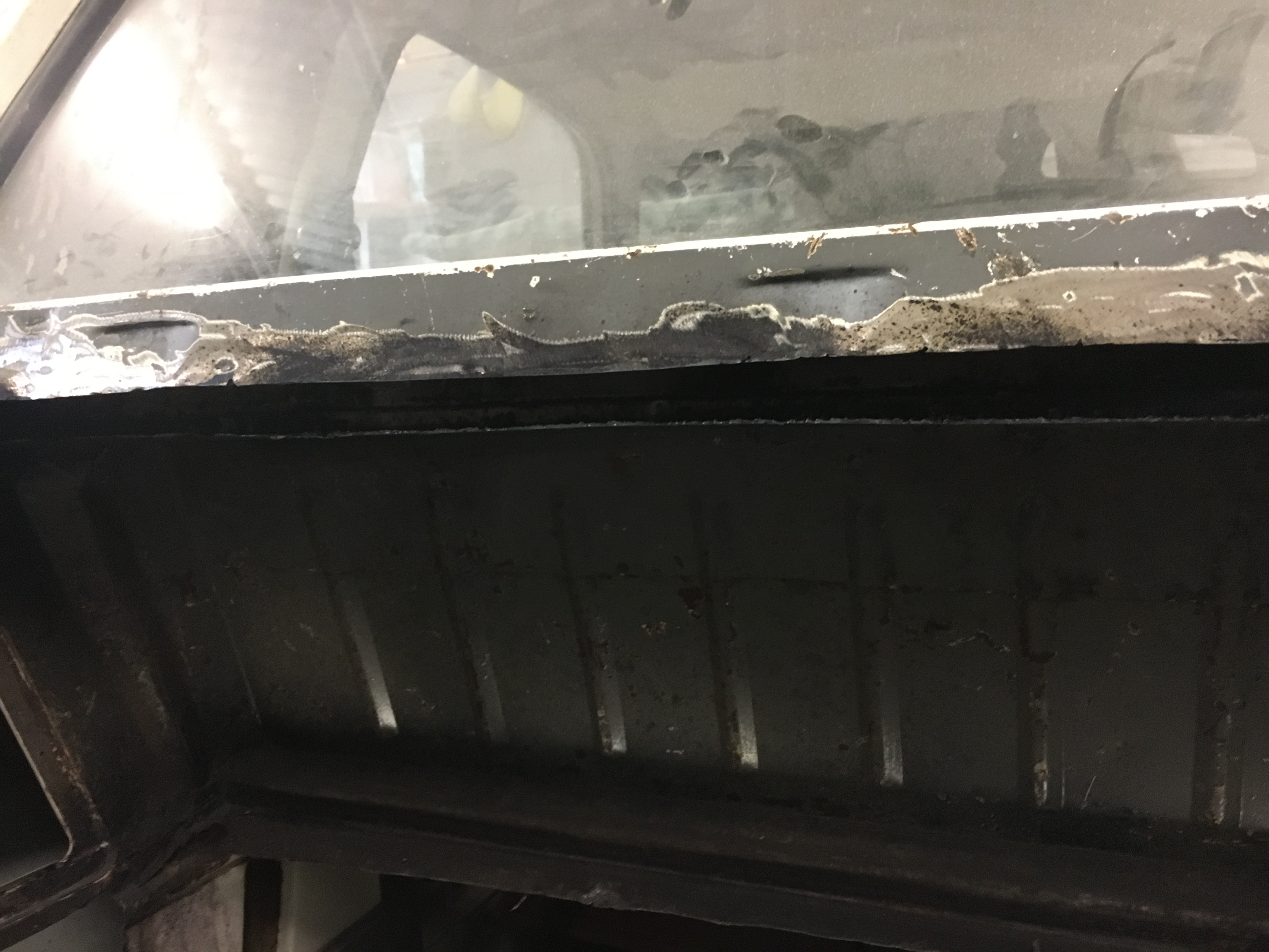

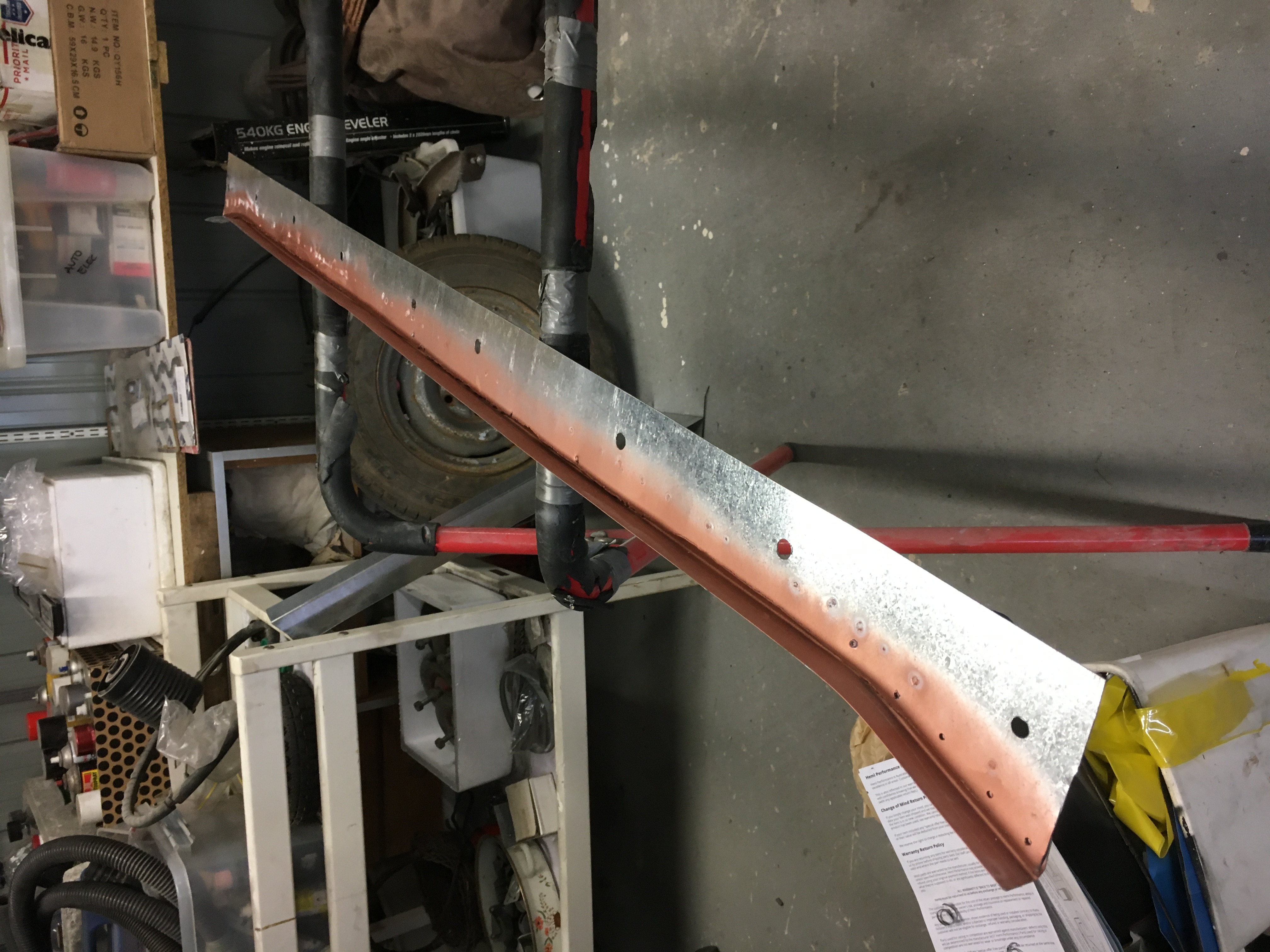

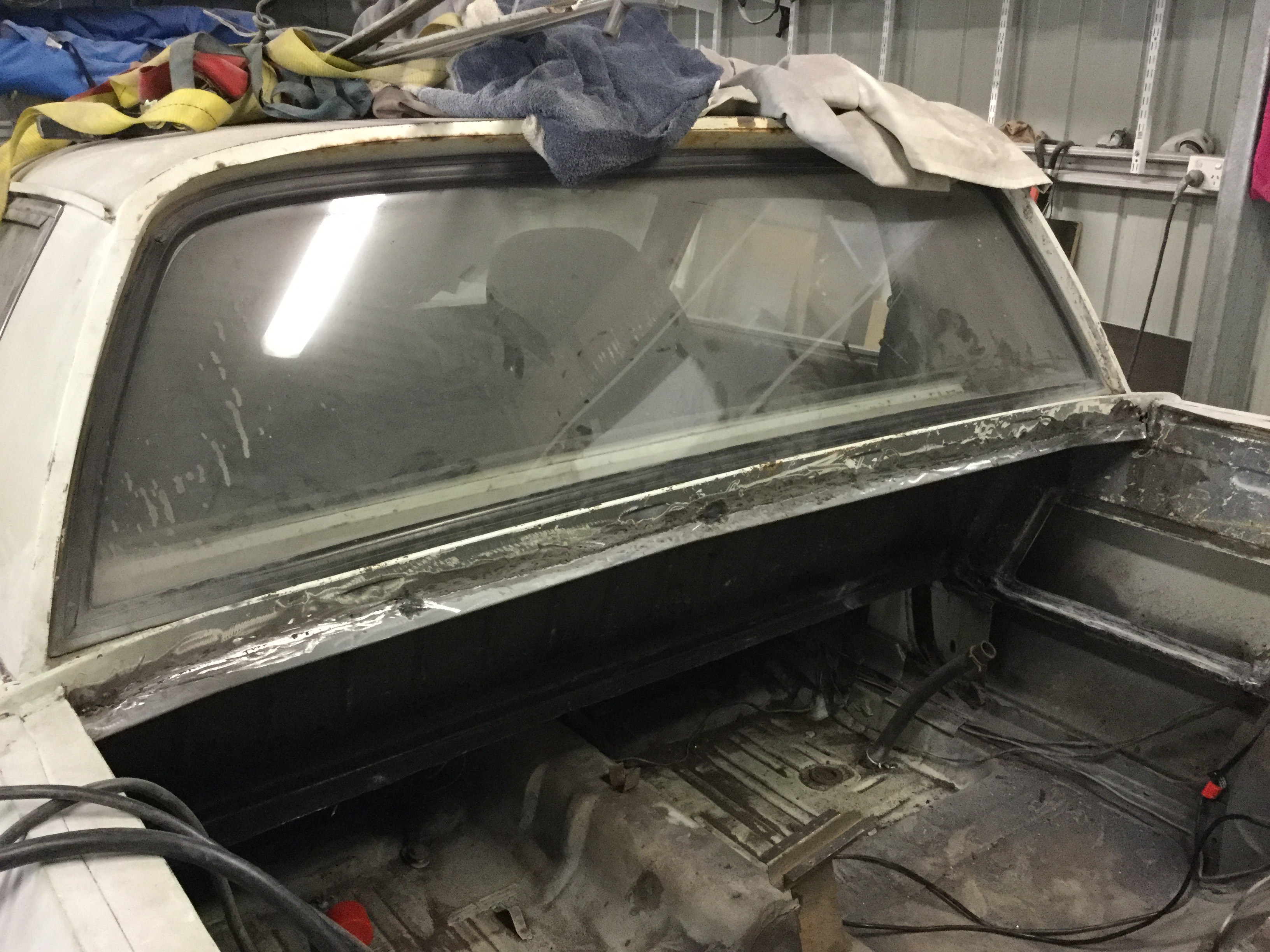

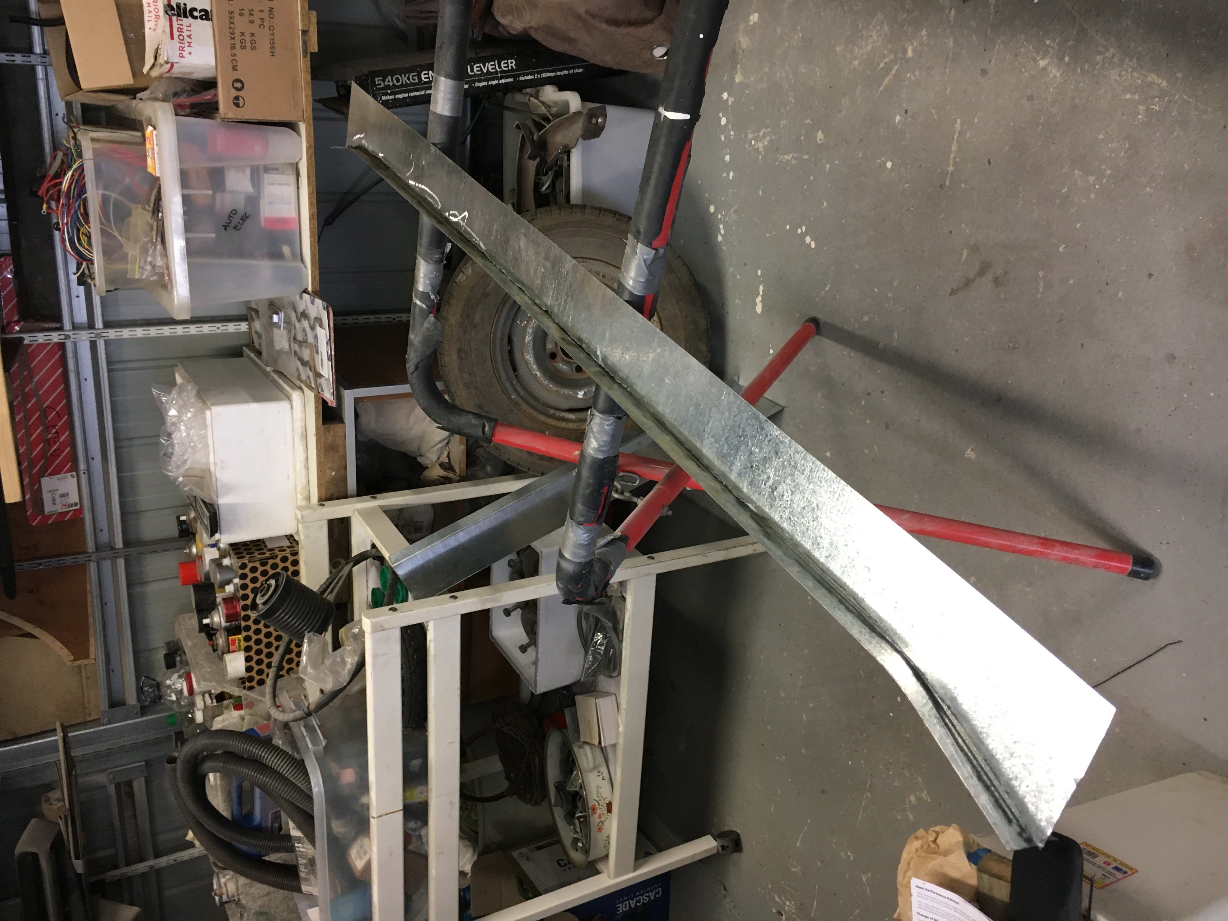

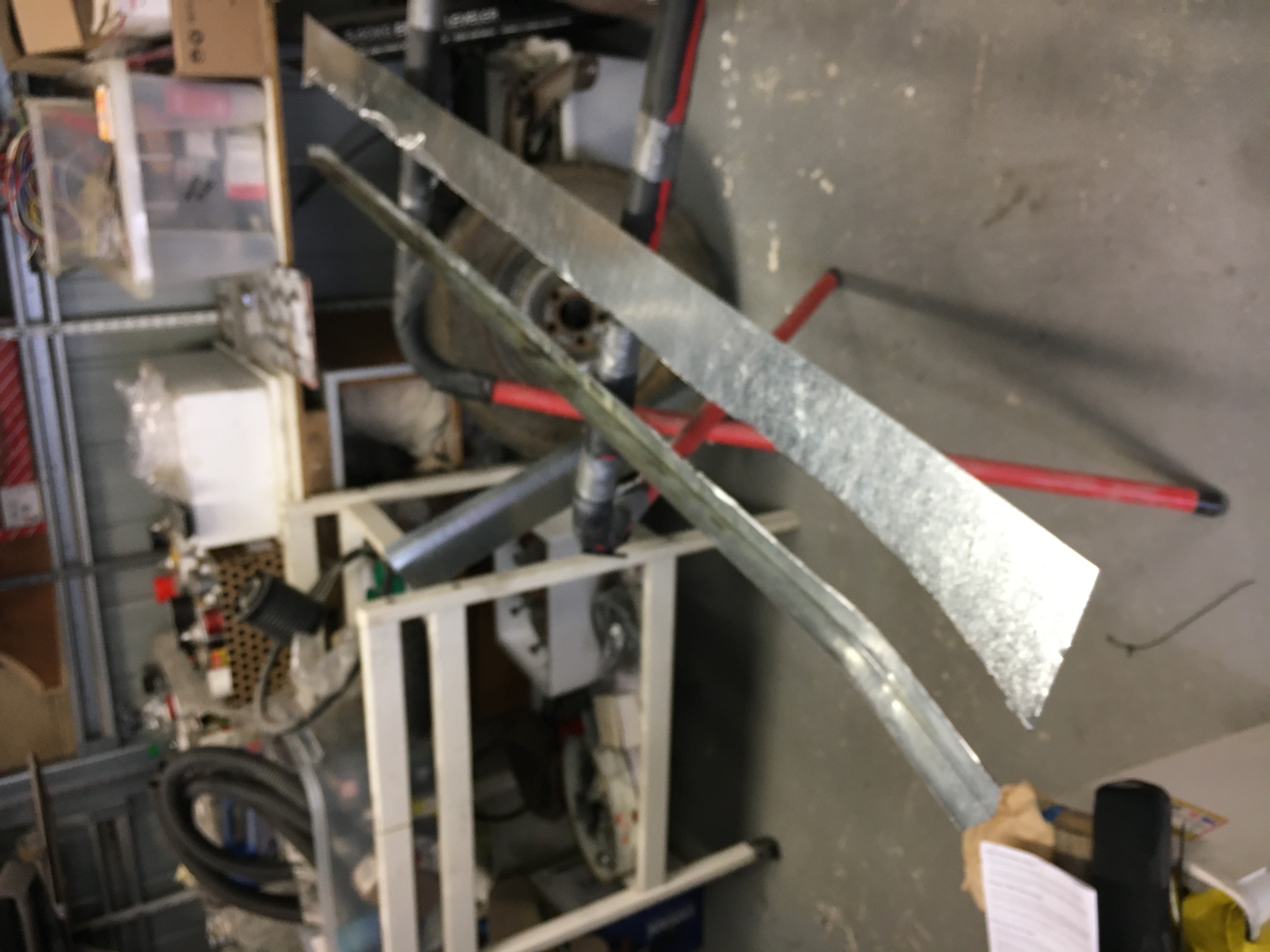

More panel work today. The metal stretcher /shrinker tool comes in handy.

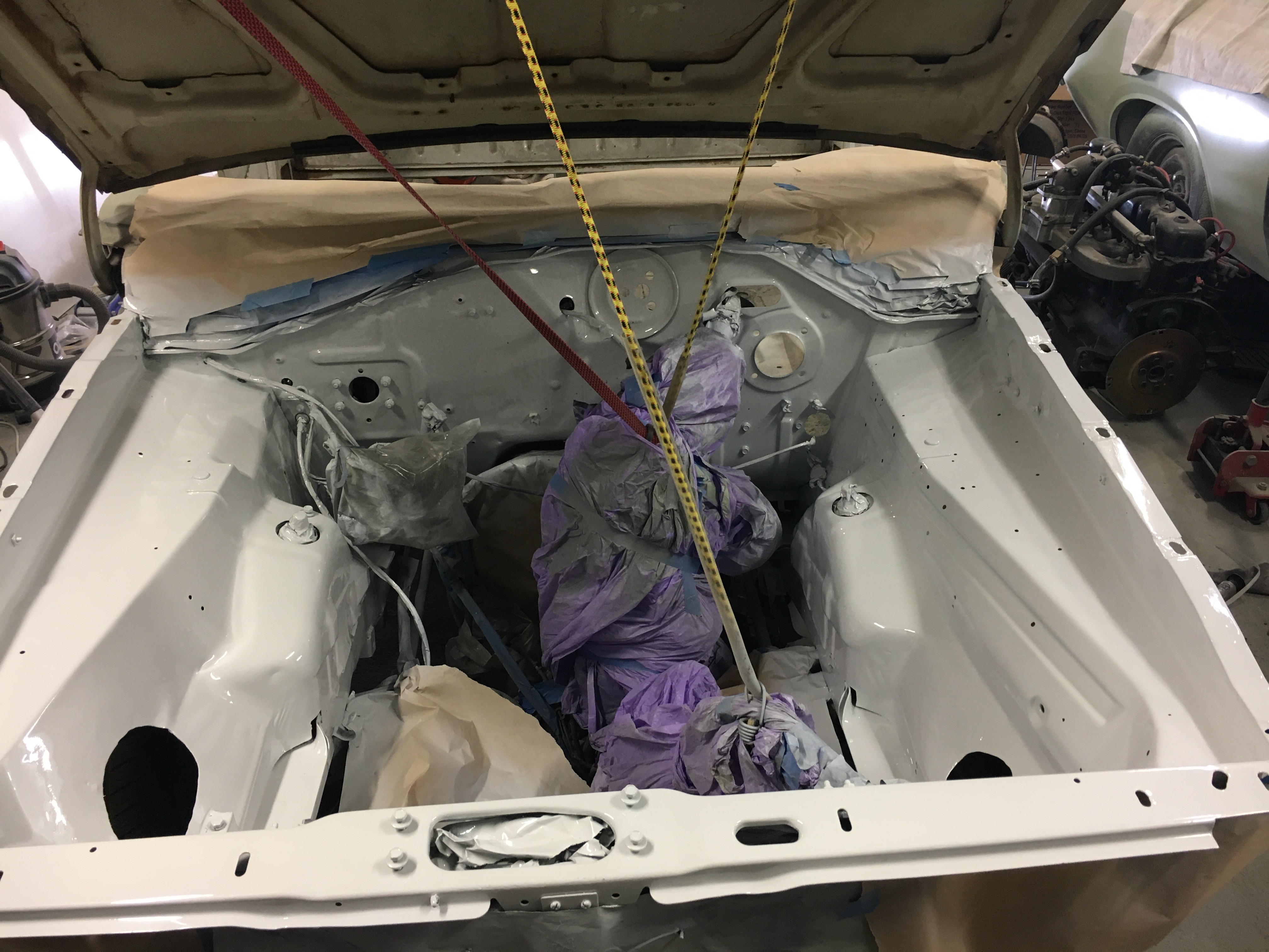

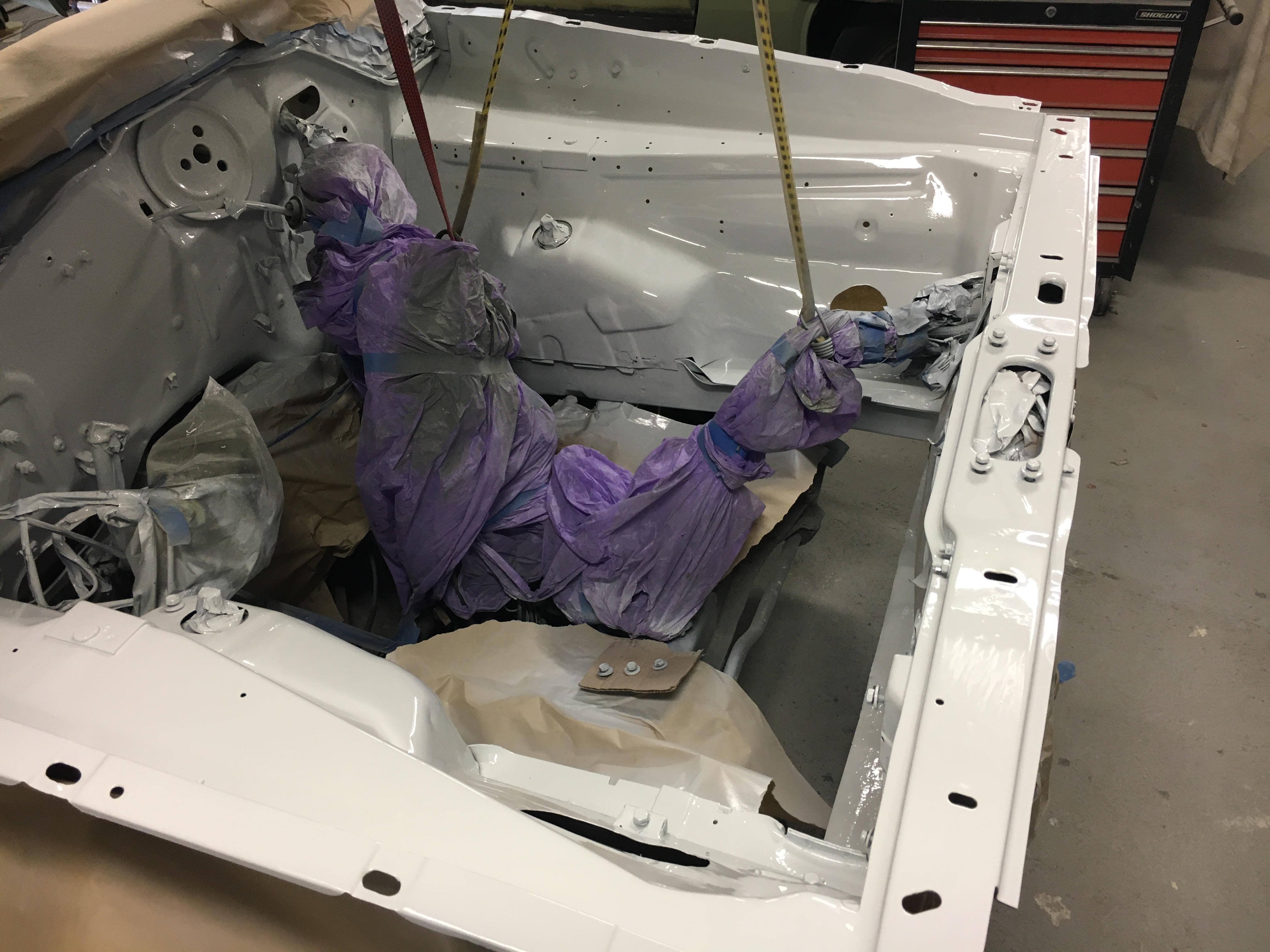

Sprayed the engine bay this morning and hope to get the engine back in and running soon. Using the clear over base system is an easy way for a beginner to get a good shine.

Re: 265 Hemi to efi
Hey Heff,
What exactly is the base over clear system?
Thanks.
Chuff
Thanks.
Chuff
- Posts: 8124
Re: 265 Hemi to efi
I think he means clear over base. A flat colour base coat, with gloss clear coat on top.
Re: 265 Hemi to efi
Ha too many paint fumes, clear over base. CheersChuff wrote:Hey Heff,
Thanks.
Chuff
