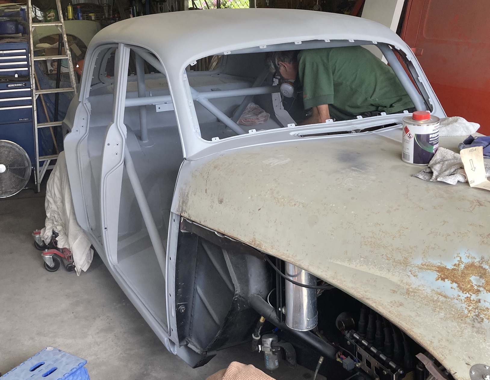

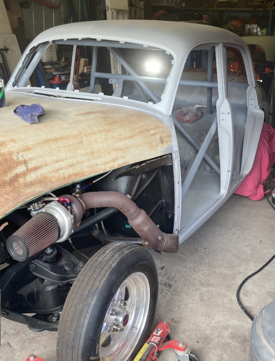

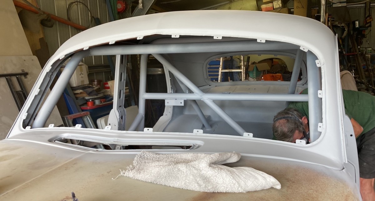

floors and roll cage all rust converted and etch primed.
Laying on the primer filler, inside, floor, dash, roll cage etc, and external panels on the main body of the car.

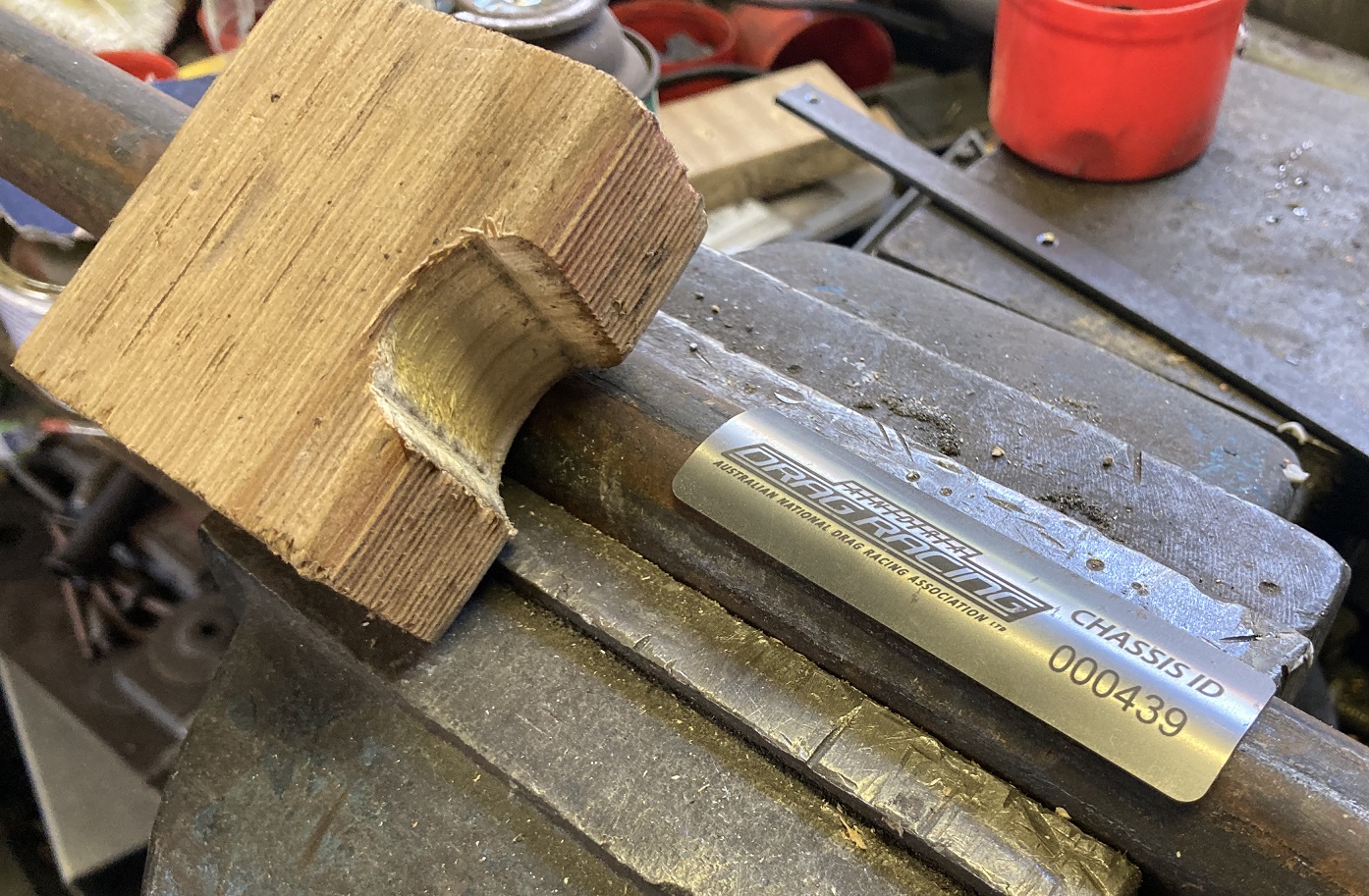

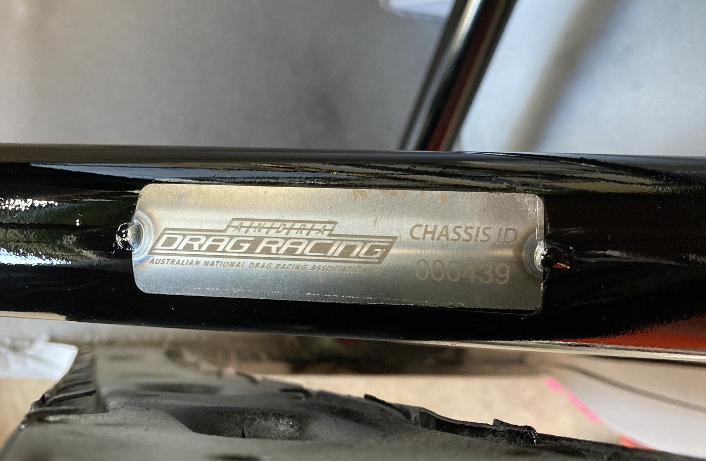

I have to attach the ANDRA chassis ID to the roll cage somewhere, so wanted to have it match the curvature of the roll bar, so i made a little tool to achieve that!
almost forgot to put it on before applying the top coat! so cleared a section of paint and zapped her on.
Covered it with masking tape while painting, and will give it a coat of clear to seal it from rust.

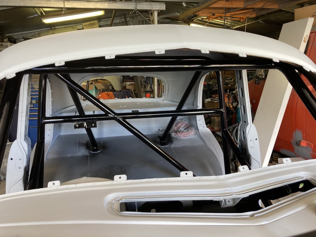

Roll cage all painted, will be covering it with newspaper and masking it all up to then paint the floor etc a different colour, then dash to paint and then we'll be close putting some blue on the body!! :punk:

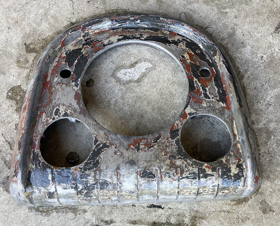

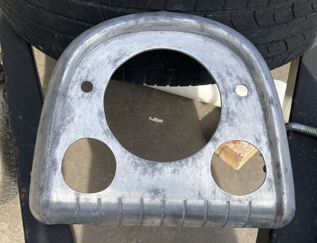

I decided the dash would be best to use paint stripper instead of wire wheel as it was alloy and has lots of fiddly bits .... this was after the first coat of paint stripper
3 coats later shes all ready for some primer!! i was tempted to polish it but it seemed like alot of work, and would most likely cause me glare when racing knowing my luck!

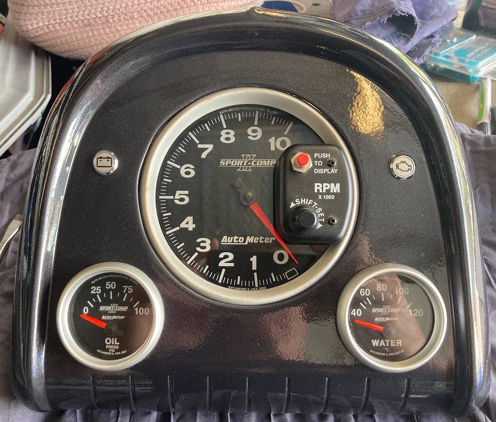

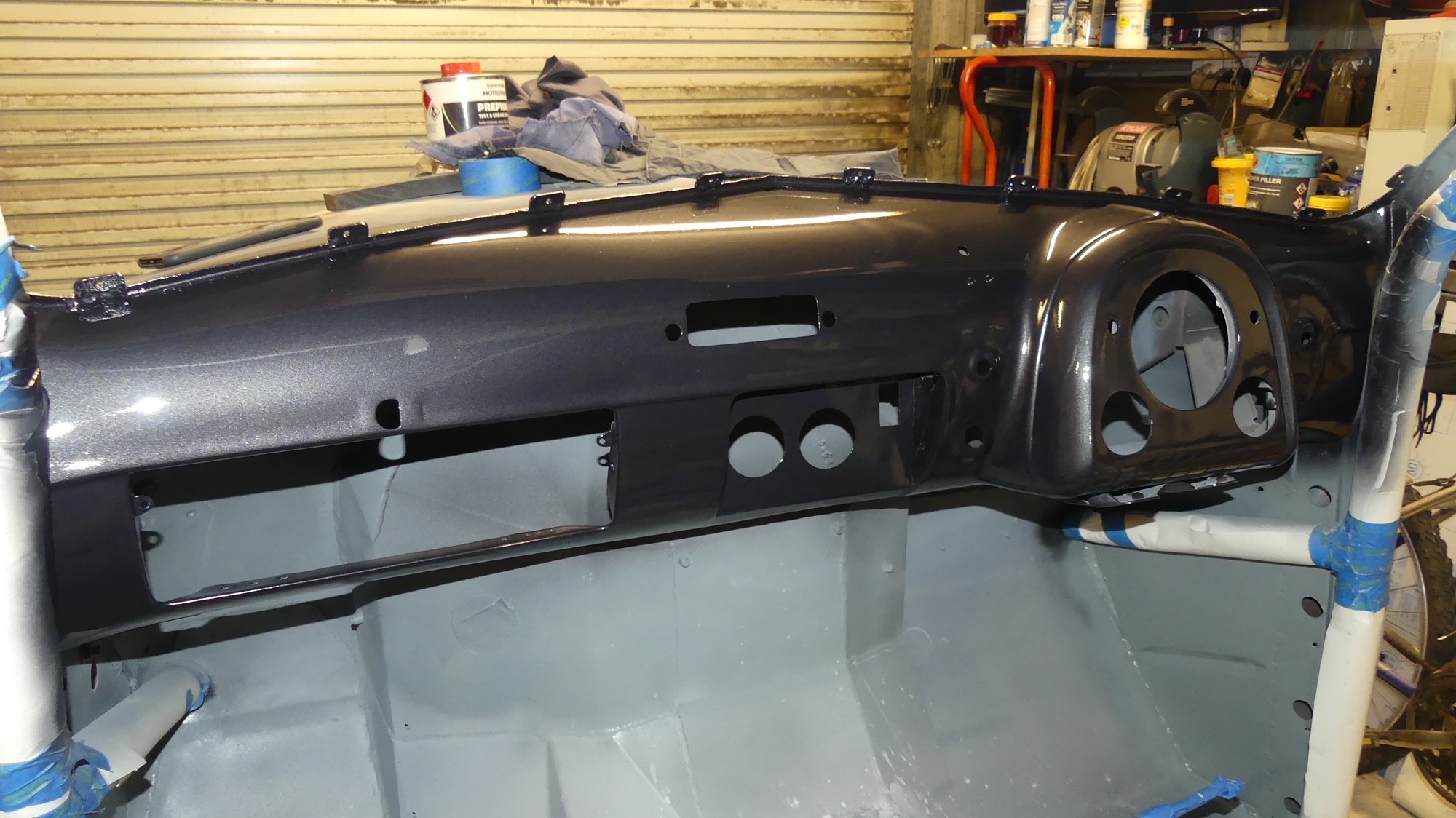

So prior to the COVID outbreak, we managed to get the dash painted, acrylic base coat with 2 pak clear ... initially we were going to use an acrylic clear dad had just cause its easier but after applying some of it to the dash cluster it sorta went a bit funny .... thankfully putting the 2 pack clear over the top brought it back to an ok finish!
So then we used 2 pack on the rest of the dash in the car .... its probably way too good for a race car paint job hahaha but who am i to complain :)
In amongst my sickness i had to get out and fit the gauges to the dash just to see how it looked, pretty happy with the result!
