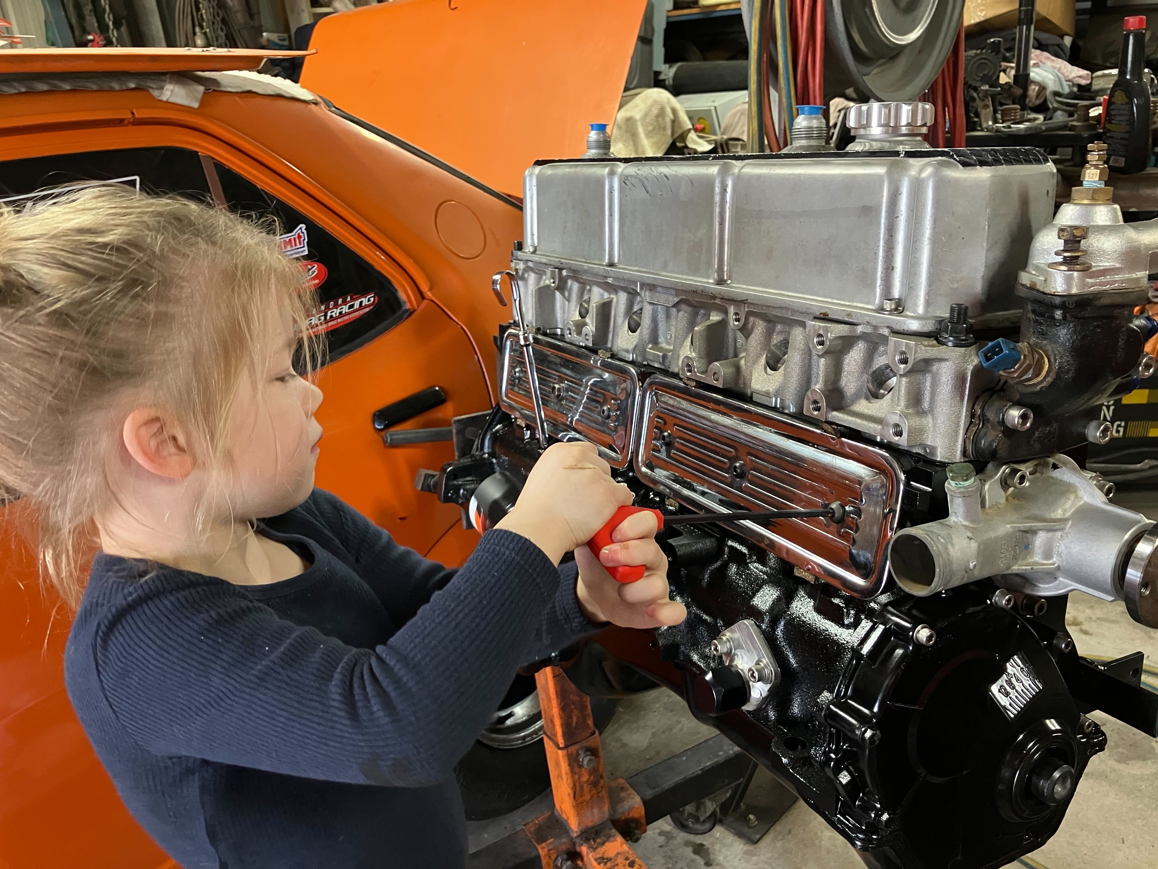

Well its taken far too long to get to this point but we are on the home stretch!
Finally got some colour on the car and shes looking fantastic!
Claire has been keen to get the car back home (after painting) and she was keen to help me put the engine together!
engine is in and running but still got a hand full of parts missing, radiator etc, as i need to finish painting the front area either side of the radiator.
Definitely happy to have the motor running with good oil pressure so heres to hoping for the end of the issues!
