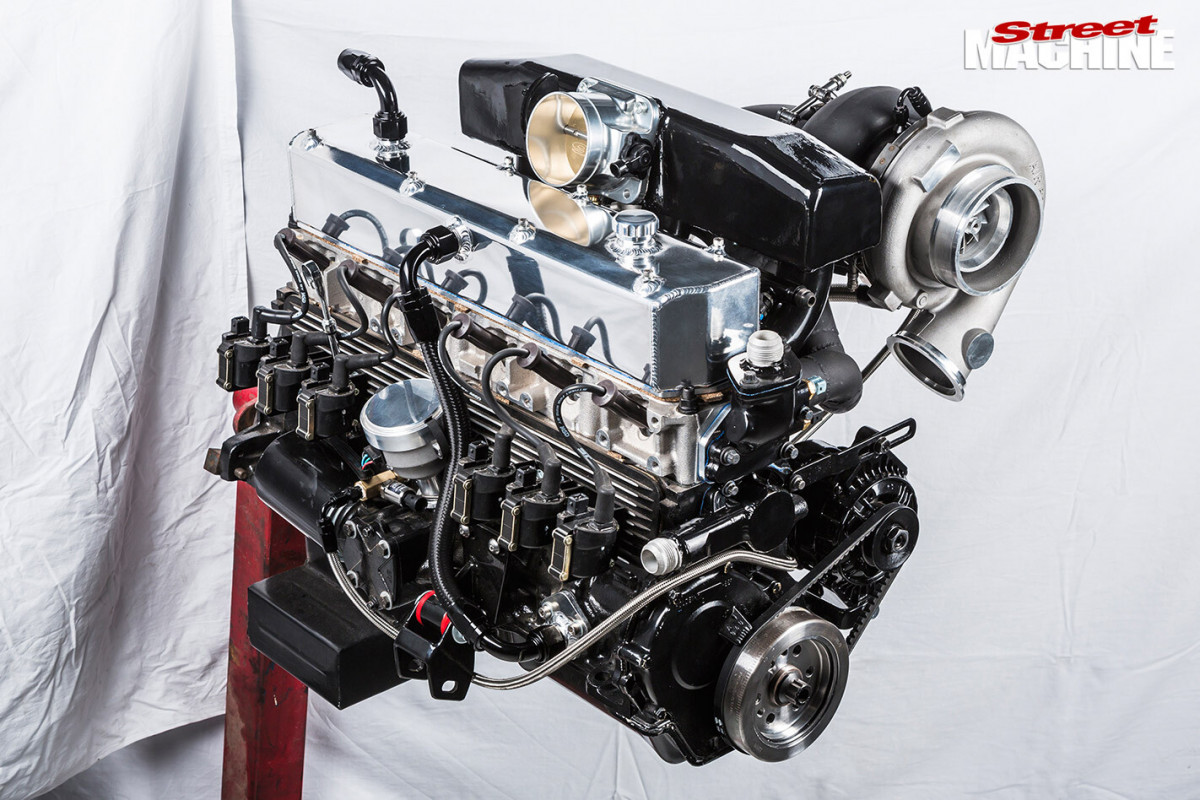

Ah yes, that makes a lot of sense. Vent the crank to the rocker first, then out the rocker cover. That would negate the windage pressure forcing out via the pushrod holes and help with oil and air separation that might occur if you vented just out the crank by itself.
i originally had a third breather line from the fuel pump hole to the catch can, it was getting a lot of oil up that tube on the dyno so i then decided to use a T piece and put it into the tappet cover via the front breather, but that didnt seem to help either so im not sure....

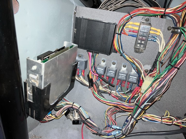

So this was the setup i had in the car originally,.

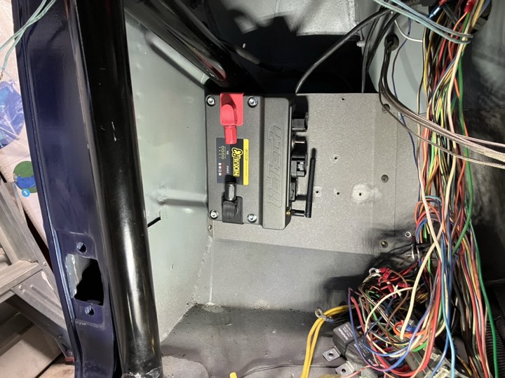

I've been wanting better data logging and input functionality for a while now and when i got a nice little bonus from work a few months ago i decided to have a little spurge! So there aforementioned logging and inputs was part of the reason i changed, but also the ability to have engine protection was a big thing after the oil pressure issues.... The Nexus R3 was pretty much the perfect product for what i needed, it allowed me to remove all the relays above, as well as add a few other extras, PWM control of fans and fuel pump, auto start (where the key is tapped once and the ecu cranks the motor over) built in wideband controller, traction control, race timer ..... and much much more

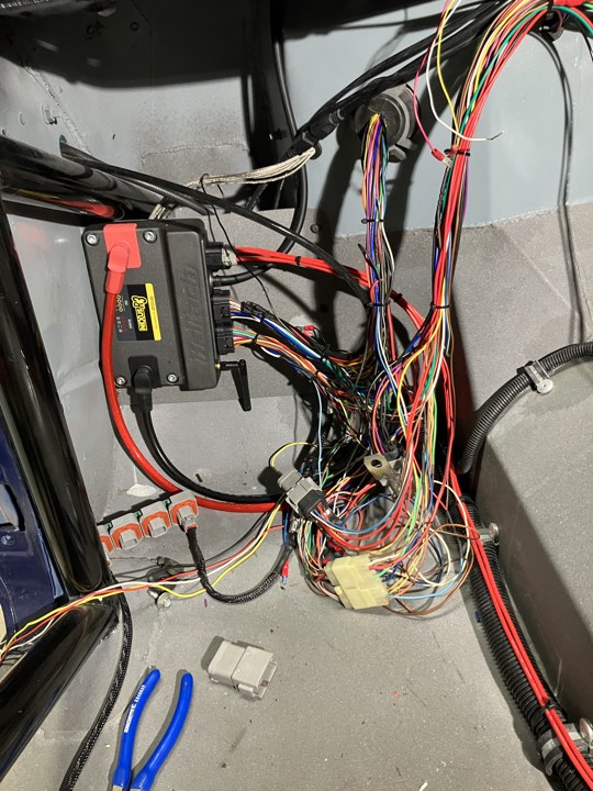

So this is the current state of the wiring, there's still a lot of tidy up to do but its at a point where i can take it to the dyno now, and kinda want to give it a good shake down before i button it up too much more.

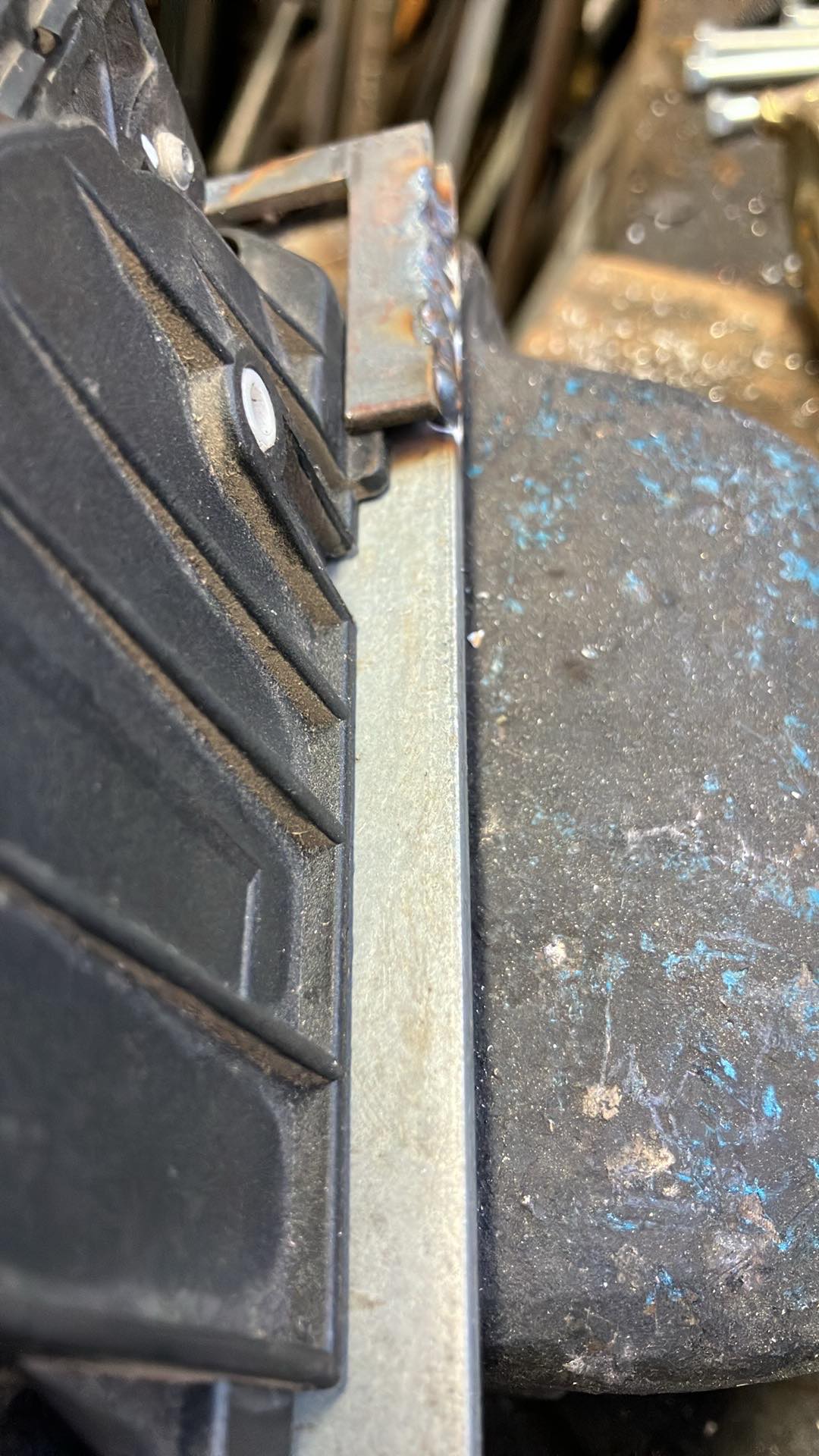

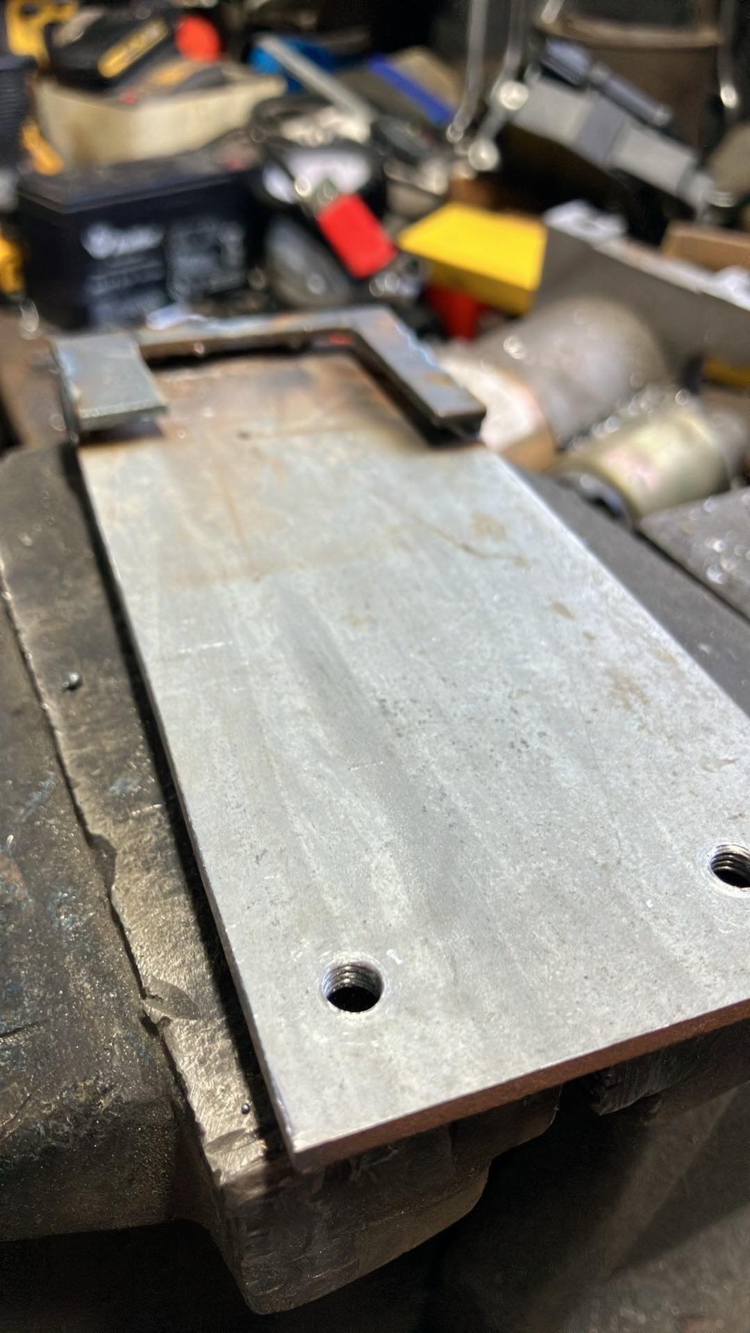

One of the extra features i wanted to utilize was the drive by wire ability, so i needed to adapt something to the manifold but i wanted to make it removable if the need ever arose, so i brain stormed for a bit then came up with this little adaptor plate.
Dont worry it has been smoothed off on the outside since this picture

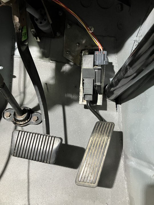

So the throttle body is from a VZ Alloytec as i had it and a pedal in stock!
Next on the cards was making a bracket to hold the pedal
It bolts to the original spot the old pedal was on so worked out nicely!

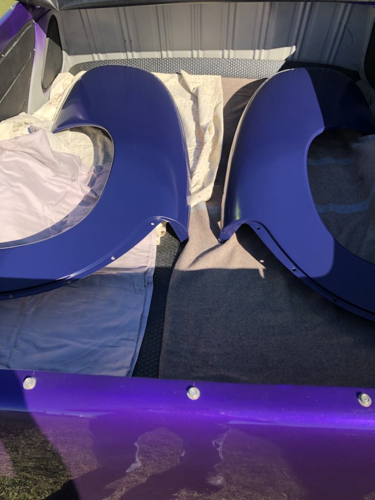

I almost forgot, during all the wiring madness, the last of the body panels got painted!
