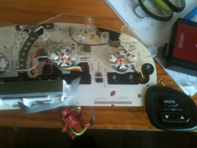

I got hold of a clip and thought I would have a play around with this myself.
I have a cluster here that I did a read with using a gq4x programer, the cluster had 399615 kms on it. Attached is the bin file and after having a look it all seems to have read ok.
vt mick.bin
(256 Bytes) Downloaded 271 times
The thing I can not work out is when I go to write back to the chip I seem to end up with a write error,
c:\documents and settings\clint\desktop\vt mick.bin.
Speed = 2
ID check skipped
Writing... Code
Elapsed time: 3.32 seconds.
Device write completed OK
ID check skipped
Verifying... Code
Verify Failed, Address=0x000000, Device=0x00, Buffer=0x9E
Verify Failed
Elapsed time: 1.91 seconds.
I have added a 9v power pack to the gq4x as I thought this might have been the problem, but it has not seemed to help.
Any suggestions or ideas on what I am doing wrong would be great
Thanks

Posts: 2959
Re: VT-VX Clusters
Post by VX L67 Getrag »
Not sure how you did it as I tried with a GQ3x & could never get the dump on board, but once I took chip off & then read & wrote it was fine!
Maybe there is extra power needed to write to it while IC, or a security measure while IC?
It does look like you have selected correct chip & settings so not too sure as it's uncharted waters for me!
kody
Posts: 17
Joined: Sun Jan 23, 2011 11:38 pm
Re: VT-VX Clusters
Post by kody »
Does the chip read seem correct to you?
I am wondering if the cluster needs to be powered up to write to the chip while it is on the board

Posts: 2959
Re: VT-VX Clusters
Yeah Chip read looks o.k. to me without looking SUPER close!
I tried all ways of even reading IC with powered up or not & didn't seem to help me, hence why I had no experience with IC as I desoldered & resoldered & worked fine!
Posts: 3550
cars: VE SS Ute
Location: WA
Re: VT-VX Clusters
Post by Tazzi »
I always thought powering the board up would give the required juice to read. Last option would be to also use that additional power supply on the gq4 with the cluster powered up although not sure if thatll fry something :?
Or bite the bullet and lift the eeprom off.
kody
Posts: 17
Re: VT-VX Clusters
Post by kody »
Yeah soldering skills are not very good, might have to have a look around for a 12 v power pack to run the cluster and might use the 9v pack to give the gq4x some more juice.
If it all goes bad :s I will just get another cluster to have a play with (y)

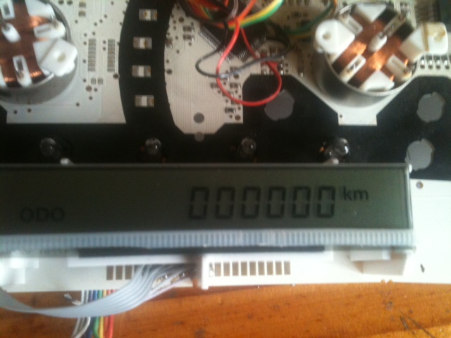

kody
Posts: 17
Re: VT-VX Clusters
Post by kody »
I think I can get it to read as I got my last spare dash here and it seemed to read ok. Just when it comes time to send the bin file back it does not want to play the game.
vtsc.bin
(256 Bytes) Downloaded 299 times
194,463 kms
lol now have 2 clusters here with odoerror
