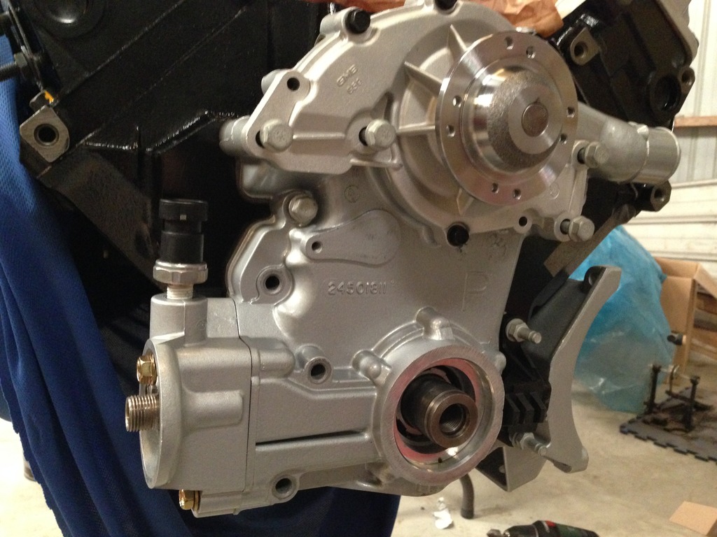

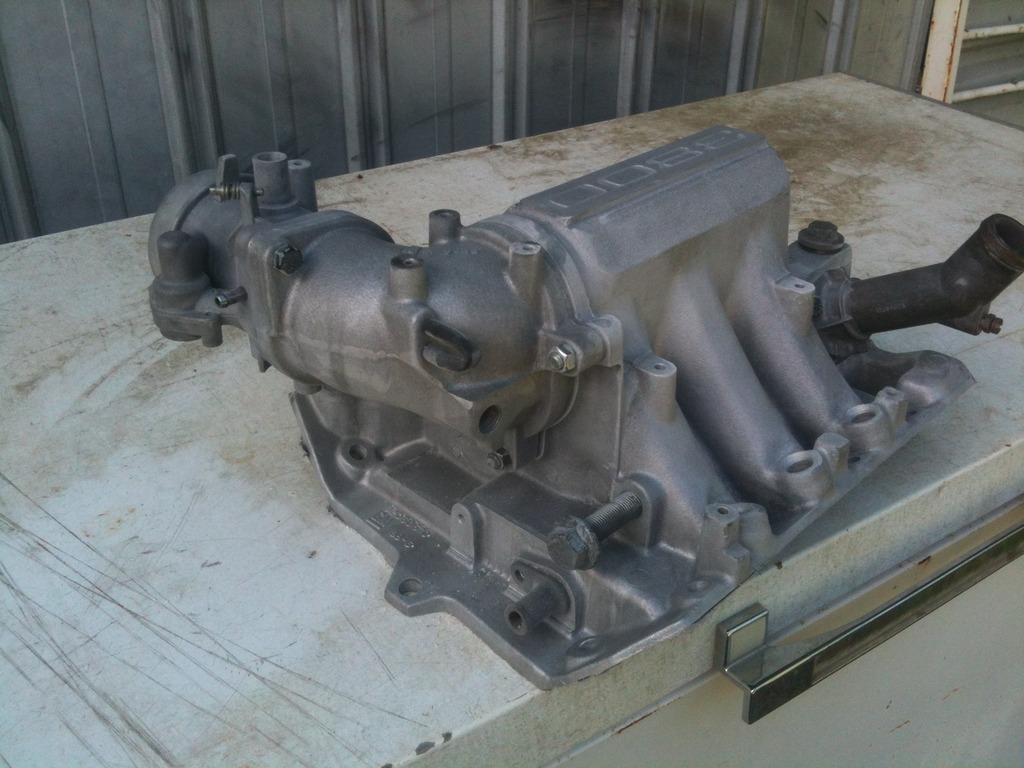

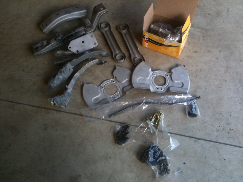

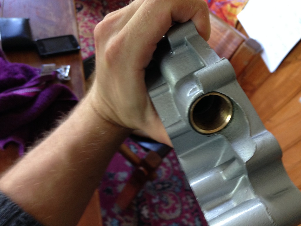

Got all my stuff back, bolts and bits plated, timing cover sleeved, suspension bits and manifold bead blasted, new water pump etc...

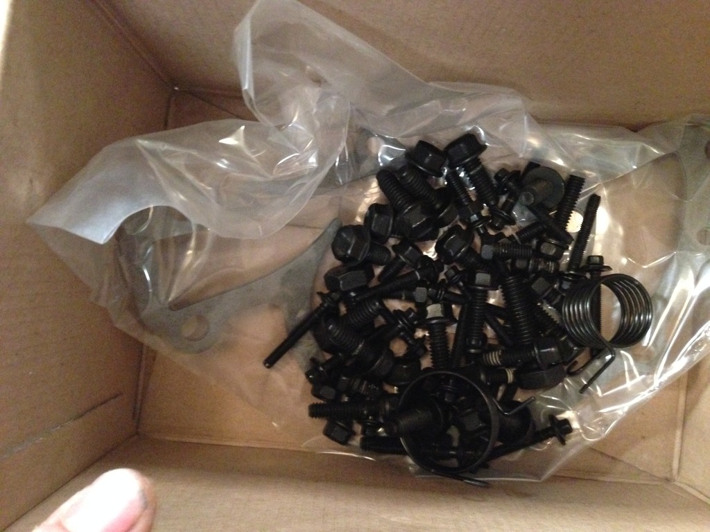

Started to dummy assemble the timing cover and found I am out of shock on some bolts and studs............
So now ordering a whole 45+ items from GM in the states inducing all the bolts and gaskets, also a ecotec timing cover before they go obsolete too. Damn expensive. 307 USD. better than 850 :shock: for the only 2 available ones in Oz.

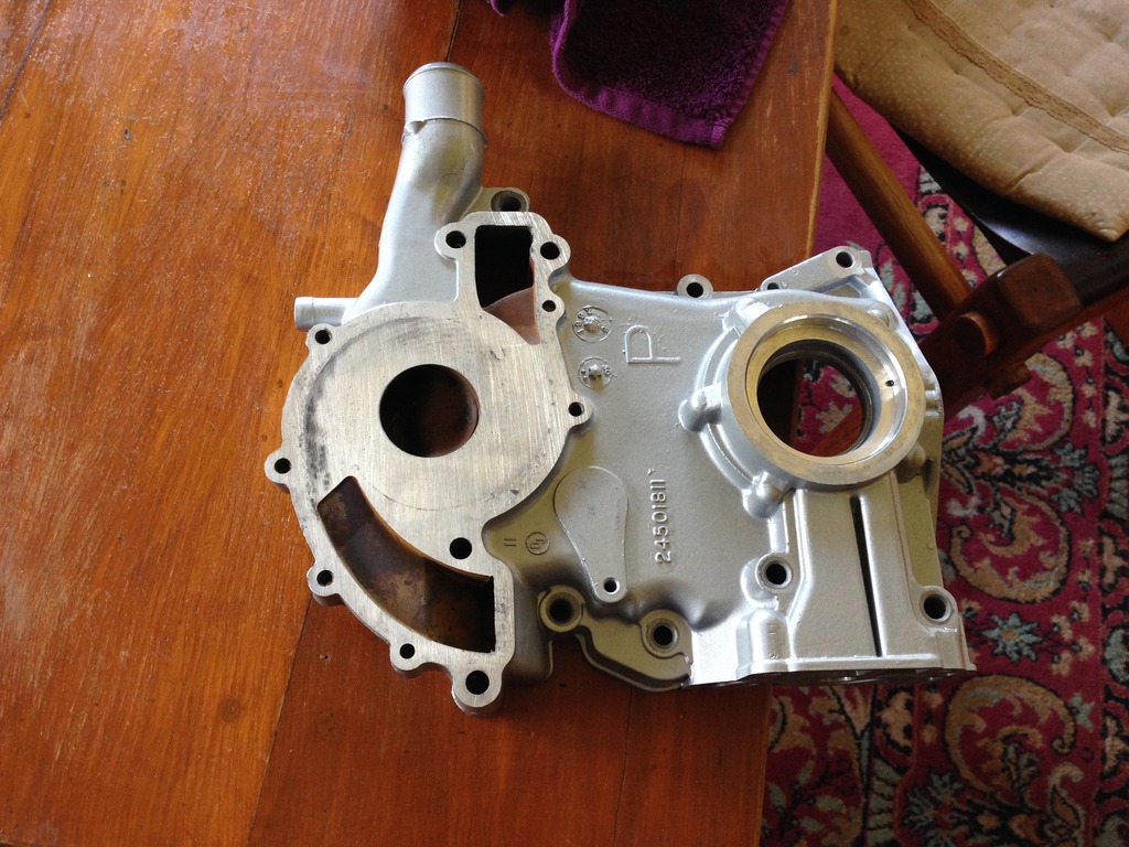

You know, I bought a diamond sharpening block for 25 bucks for facing the water pump face. Worked wonders! and its dead flat. So so much better than glass and wet paper.
