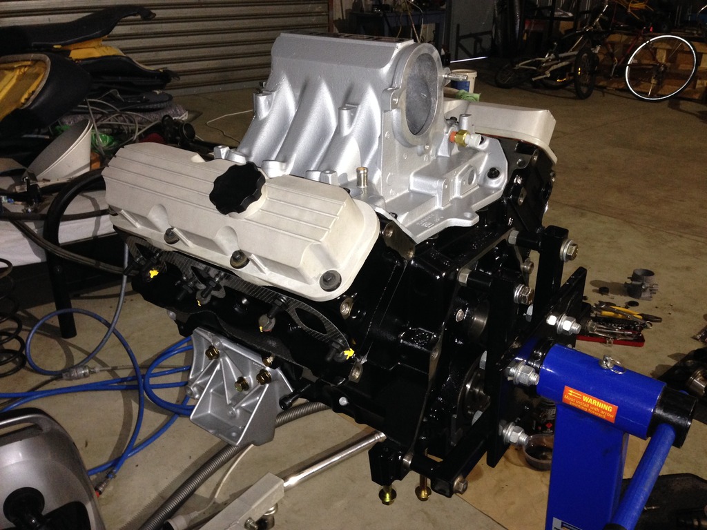

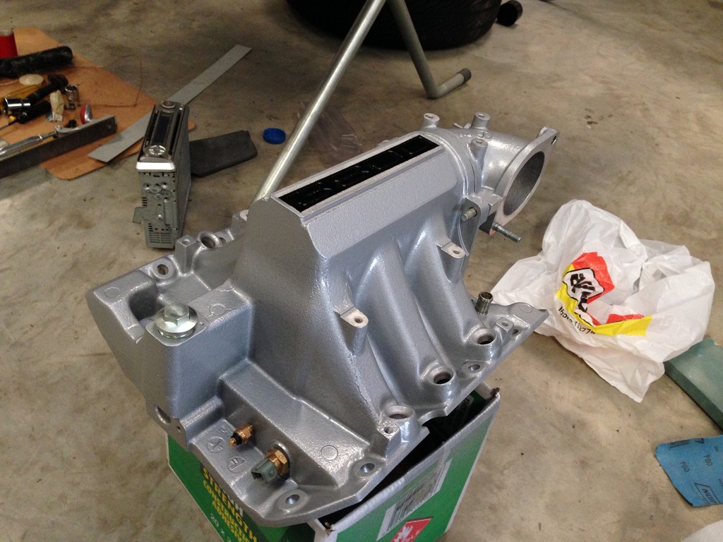

got the manifold painted. just waiting for the paint to harden and then i can polish the top bit. test fit and port match.
Oh and I ordered my bits. 1050 bucks latter...

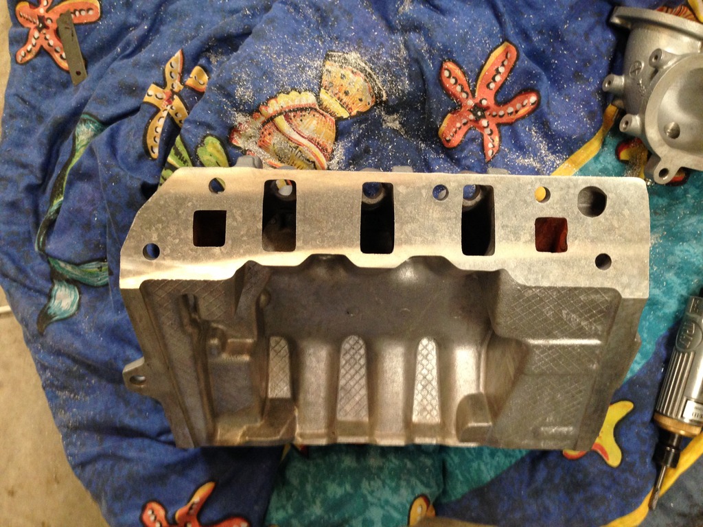

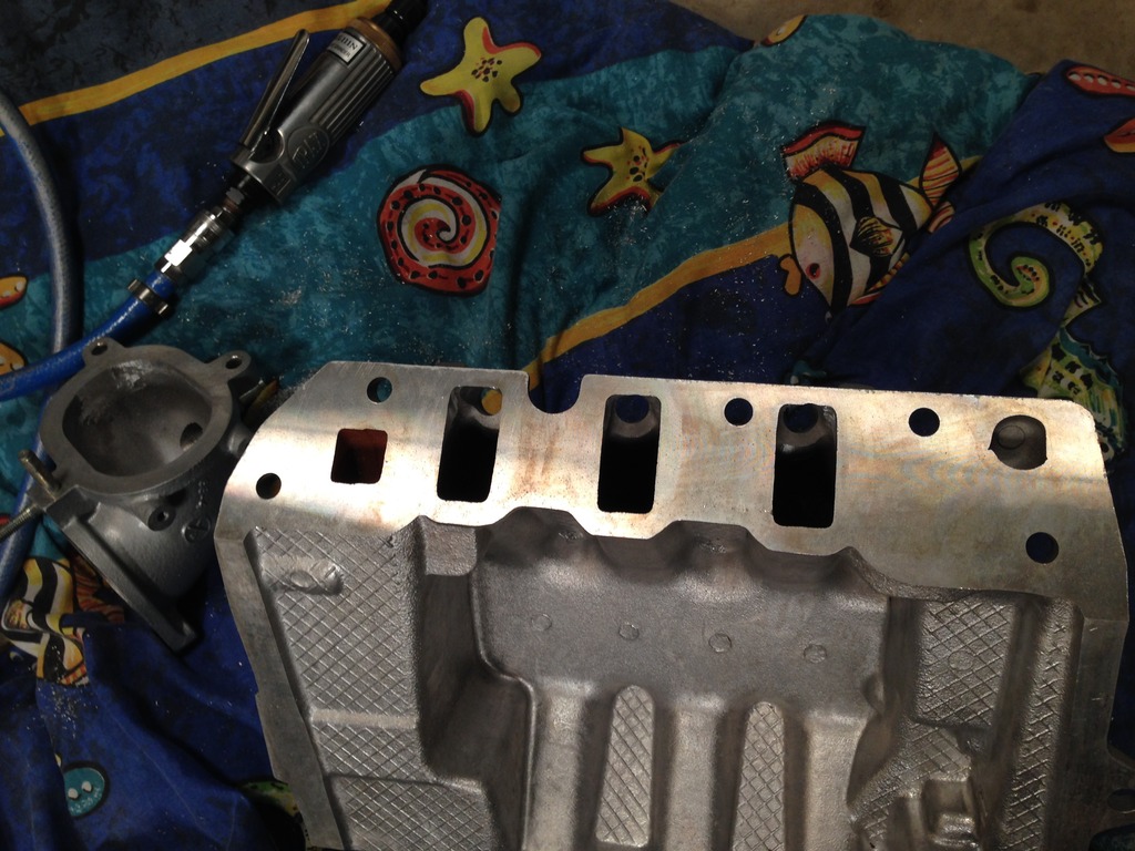

- Posts: 8601

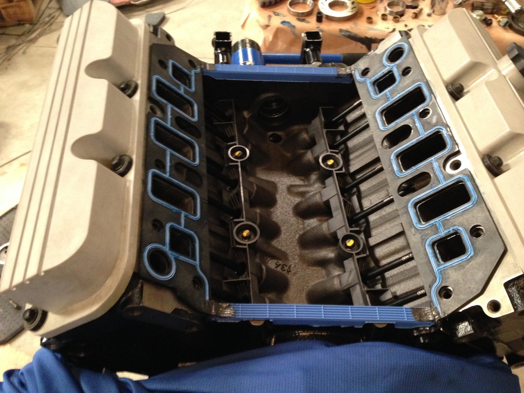

Did a check on the port matching and for stock its very good. Only have to clean up the top part of the port as it narrows down slightly due the way it was cast. Also will reduce the injector boss slightly.
https://www.youtube.com/watch?v=H-Kzf3HytAM
Just a test fit but its a sexy looking engine now.
- Posts: 8601
Adding to my pile of painted bits.

- Posts: 8601
Well with the phone torch, camera and screen I could use it to look down the ports real time. Video was only so I could show you guys

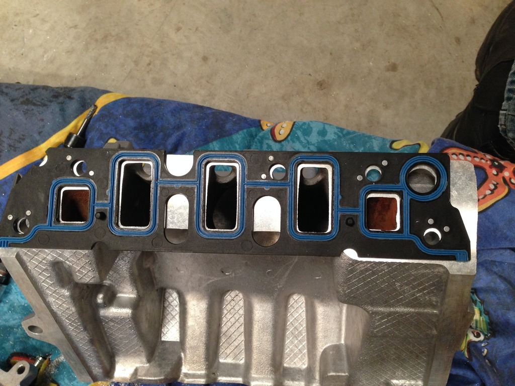

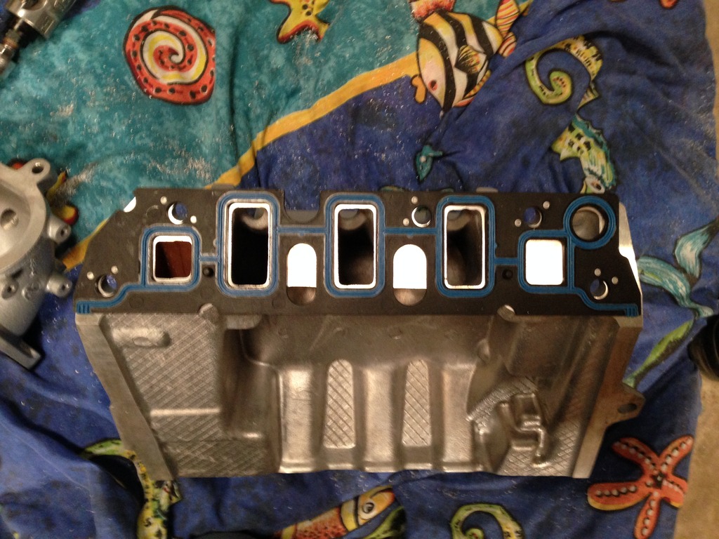

So to the porting.
As you can see the stock port tappers off at the top slightly.
And with gasket you can see it easier.
Now ported.
Ready to go!
could not be happier!
So to the porting.
Now ported.
Ready to go!

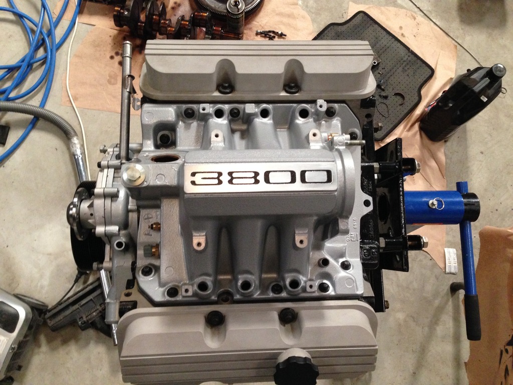

- Posts: 2681
The manifold could have had more out of it to match the head (based on the gasket pics sitting on the heads, the angle for viewing is poor)
Sorry...
Sorry...
- Posts: 8601
no, its exactly the same size as the heads, fraction bigger around the radius infact.
- Posts: 2681
Looking at the fourth and fifth photos above it looks very different... But like i said the photo angle of the head in the fifth photo is hard to tell...
