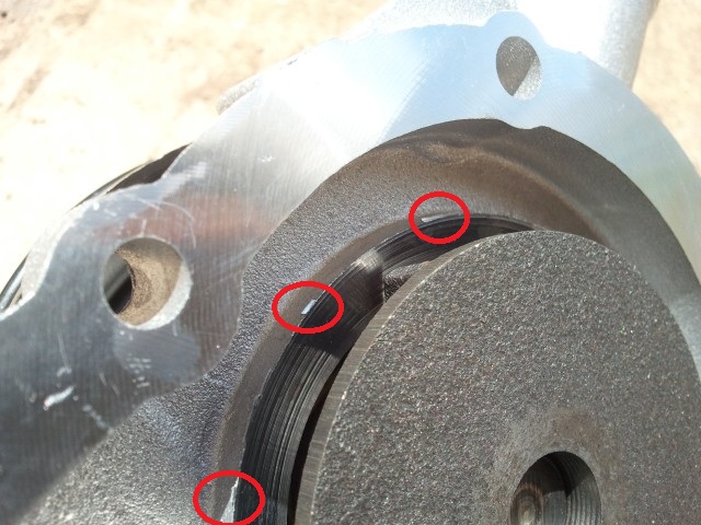

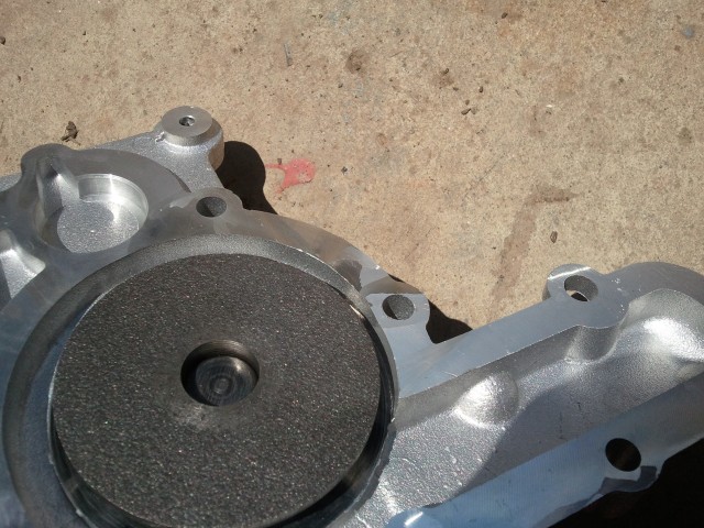

While that was soaking, I replaced the water pump, although the new one looks pretty crappy.
The mating surface was nothing like flat, and the pump was full of swarf from the impeller housing machining - not loose chips, but they'd be in the coolant within a couple of minutes of running :evil:
most of the swarf removed already, there was lots more
So after cleaning it up and fitting, hopefuly no more pump issues.

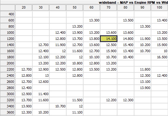

VE learn must be doing it's thing, because after idling for a while then putting around the yard a bit the VE table is showing some changes that I didn't make, and AFRs are starting to slowly get out of the plug-fouling range.
I've got the MAP and RPM radius set pretty high for VE learn, assuming that while I'm trying to get some sort of ballpark for VE, larger radius values will more readilly match up target cells for learning?

your right about the larger radius, it will catch more cells but it will also be less accurate, but as you say for getting in the ballpark its the go, can then tighten the radius as time goes on to get it even closer.
another option if you wish is to use the wideband log histogram, any drive you do just record the log, then play it back to popular the histogram and then use the numbers in there to put into the wideband converter spreadsheet along with your current ve table and your open loop afr table values and it will re-calculate a new ve table to paste in..... this also is not 100% fool proof, you do need to look at the graph after and make sure theres no stupid spikes in it but it will help you get most of the table pretty close with just a few drives.

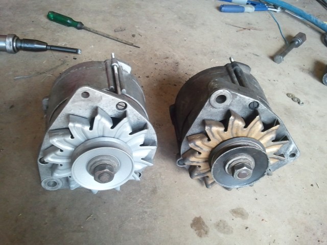

This morning I found a spare alternator in amongst my spare parts collection, so pulled it down and gave it a quick look over.
It didn't look too bad so cleaned up the slip ring and brushes, greased the bearings, gave it a clean and swapped it over.
The I grabbed my alternator tester and started the engine to see if it was working properly. A few seconds later, the engine just stopped dead.
