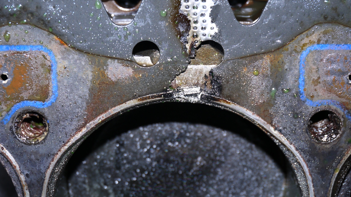

took the heads off today after pulling the engine out knew I should have taken them off first but anyway rings are OK
no need to tear motor down, just need to check that it has not been warped
- Posts: 8600
Re: The1's Daily
what kind of gasket is that? I have some stock factory ones that came out of my mates Vy and the metal sealing rings go almost to the outside of the head, looked like more than double of what you have there.
that could be your problem right there, shit gasket.
lol straight into the engine, thats your blow by problem
Did it torch the head or block?
trikky73
- Posts: 72
- Joined: Mon Feb 13, 2012 8:22 am
- cars: VS V6 Sedan
Re: The1's Daily
were ACL monotorque that came with the ACL rebuild kit I used
does not appear to be any damage to the head or block, need to get a straight edge in the morning to check the head before putting it all back together
Hopefully no warping otherwise its a trip to get them machined

let me see if i can get a pic oh the gasket or at least the head showing the seal width.
i have read the genuine gaskets to be the best.
