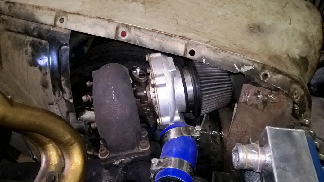

Turbo fits
Will probably rotate the turbo to be more straight and thinking i'll most likely send the exhaust out the inner guard too, should help get the exhaust heat away from the inlet and help with under bonnet temps!

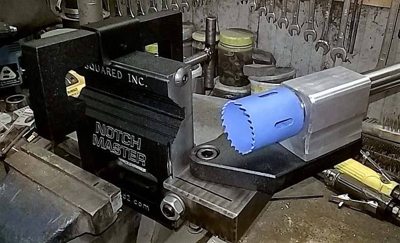

this arrived today, unfortunately there is a lot to do before i can use it!
- Posts: 2681
Like what? Looks like a nice bit of gear aside from the cheap looking hole saw...

Well for starters i need to get roll bar pipe, but then i cant install that till i have the chassis rails in and the 4 link rear end
