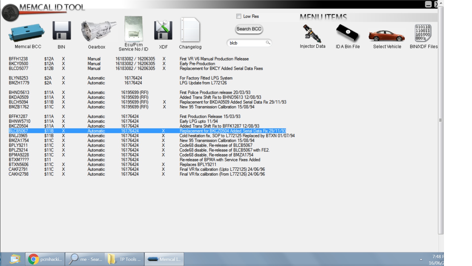

The Memcal ID tool says:
$11B

So, does this mean any thing for trying to connect to the aldl and ecu?

That adx you were using should be O.K.

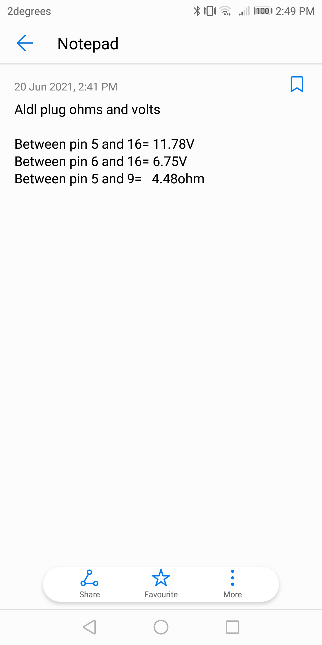

Checking to see if I have power at aldl under steering wheel
Pin 16 battery + voltage
Pin 5 earth
Pin6 earth
Pin9 baud 8192 data

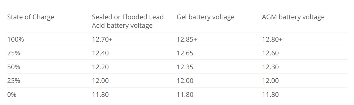

Your battery looks cactus.
Check for a good continuity from pin no.5 to earth. Can the battery be that low and still start?
Double check the pos (+) to neg (-) on the battery (volts).
Terminal no.4 (ALDL) is also an earth.
That's a lot of fresh air in that img. haha

I'm not a specialist, but are those ohms and volts telling us that the aldl and tunerpro should connect. Or is it creating more doubt?

You have voltage @ pin no.16, however it's not needed in this instance.
Voltage between pin no's.6 & 16 is irrelevant.
I'm not sure if the resistance in the data line is meaningful.
