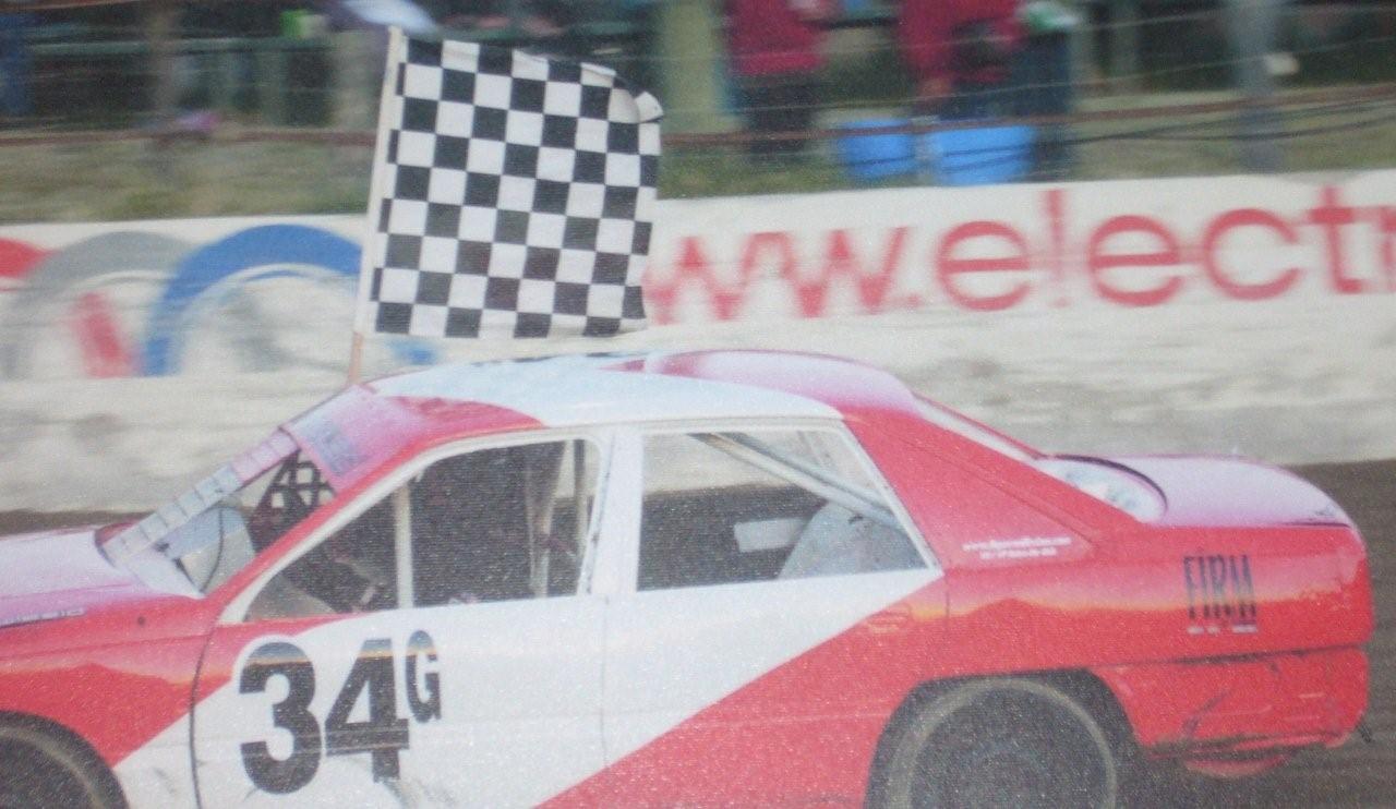

Been a while since seasons end so a quick summary before preparing for another season.
Far too many DNF's
Destroyed a few parts
7 rims
1 tyre and tube
3 front guards
2 bumper covers + 1 recycled & pressed back into service
3 bumper irons
2 right tie rods
1 right front bottom arm
1 steering rack
1 diff
1 front cut shock towers forward
1 serpentine belt
1 belt tensioner and pulley
1 fan shroud
Had to send the radiator out a couple of times for repair
thats all off the top of my head for now and i won't go into frequent panelbeating needed
Fabricated a new exhaust with termination box in time for last meeting
When i wasn't finding carnage the car was very competitive had some good results, some torrid battles - good, bad AND ugly and i also got three extra laps like this
As a good freind who drives a streetstock put it i had "one hell of a speedway season"
Will i be back out there next season??
VN Production Saloon

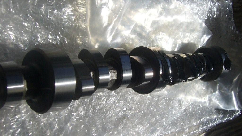

Reground cam showed up late last week and i've started a bit of a howto over on the SquaredArches forum whilst pulling it down ready for the cam.
I checked out the spec card and set it up with a degree wheel then compared it to the notes i took when assembling the engine a couple of years ago - didn't think much of it to be honest so i mapped it out @.003' lobe lift then every .010' lobe lift then every .001' over the nose and every .010' down to closing - man thats tedious and i still wasn't happy so i pulled it back out and slotted the old stocker back in and mapped that out the same way as the new grind and studied the data i had recorded
VERY VERY CLEVER overall duration hasn't increased much and the timing is not radically changed but lift 'under the curve' is much better and duration over the nose is doubled so it should make more power everywhere especially midrange to top end and still idle, best of all its perfectly legal for my class of racing.

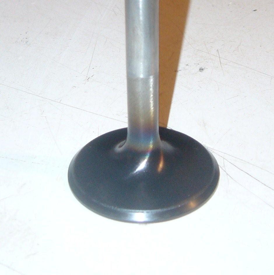

Before all this rigmarole i scraped off the gasket faces ant taped off the intake faces to keep any crap out, when i was setting up the degree wheel for true TDC with the stopper i made years ago screwed into the spark plug hole i noticed a bit of movement of the tape over #1 inlet port but didn't think much of it, noticed it again resetting the wheel when the old cam went back in for comparison and got concerned so after doing the cam thing investigated thinking maybe a scrap of gasket got between the valve and seat ( the rockers were still on when i scraped the gasket ) so i put my air duster down the port and tapped the valve tip a few times then filled the cylinder with compressed air with tape back over the port - pop went the tape, next up i compressed the spring in place and had another blow while turning and opening/closing the valve by hand and spraying down the port with wd40 recheck no good, checked the other two on that bank and #3 was leaking as well - off came the head
chamber very sooty and the back of the valve looks like its had wet fuel sitting on it, been getting hot where the stem joins the head too, all the inlet valves look like this so i'm thinking dodgey injectors, might try some ecotec injectors which i have on a VS intake i got given and work out the tune with them to the new cam - those valves will be getting binned as a precaution too

Sweet as mate, rang SI Valves in California @ 5.30am this morning (10.30am yesterday morning their timedelcowizzid wrote:he wants to hold off on getting heads just yet.so what duration was your cam our [email protected] turbo grind arrived last week lobes are so wide at the pointy end LOL
206@ .050' (pretty near stock) , .003' either side of max lift has gone from 12* to 24* and the timing of events has been tweaked, i'm pickin it won't sound like its cammed but should pull like a schoolboy with a new Mayfair everywhere.
