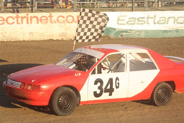

First season done and dusted, bit of a mixed bag results wise but had a ton of fun.
Starting point
made my money back selling the LPG system and various bits and pieces
to make this
Havent got round to the drivetrain yet, still auto with 368***km's on it, i just slap it into 2nd (kickdown cable deleted) stab it and steer. Diff gears welded and *inches of stagger on the rear to help get thruogh the turns. Spent this first season for the new car sorting the handling, bit of a mission with the big girl and now being restricted to a max. tyre width of 205---plays even more into the hands of the fwd puller brigade grrr

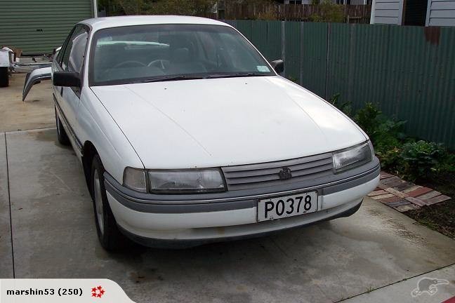

This is Donor, so far has given a good mate the FE2 springs/front sway bar for his VK Production saloon; steering column/wheel etc. plus bootlid/spoiler has gone to DYNO as will LSD diff. Pillaging it of a few panels and rest of suspension etc. for spares for racecar
non contact class but rubbin' is racin'
And this is DYNO
About to put a s1 manualmotor/5 speed in so i can test heads/manifolds on ( have been doing my own porting/valve jobs for years) and work out tuning the delco, we arent allowed datalogging on the racecars and going near it with a laptop in the pits will get you trailered immediately, by sticking DYNO back on the road hopefully i an start next season flying and have a chance of beating the pullers HTF do i stop it from cropping half my pictures off??

do you find the trans slips a lot in 2nd without the kick down cause it not only makes it kick down but increases the line pressure in the box depending on how much throttle you give it if you really need to stop the kickdown you can buy a TV valve that is locked at high pressure without the cable connected which would work better will pull the clutches and bands tighter.or you take the torque converter out and they sell a solid adapter that goes in its place to connect to the trans pump and the splines and you use a modified valve body in the trans that slips 1st and second and when you select 3rd its directly locked with zero slip you need better diff gears to suit down in the 4.11's for a start would be good.

Thanks man it is. All growed up and still playin' in the dirtVL400 wrote:Nice looking race car, looks like heaps of fun!
And delcowizzid you probably right, however rules say that torque converters must be full of oil and functional, besides the fun coupons are tight and didn't give a damn about the auto anyway as i have a manual s1 motor/box for next season.

Putting s1 VN manual/motor & box destined for the race car into DYNO the VP for testing purposes, only got one of them puppies as they don't grow on trees which makes em pricey
sounds backwards i know but its a matter of using what i got, when i'm happpy with the setup i'll pull it out again and chuck it in 34G and go racing . Will PM you later delcowizzid, cheers

What was left of Donor..not much, i even cut off the back panel and sills for spares has gone to the crusher....made the missus real happy seeing it go as it dominated the view out the kitchen window.
Dyno needs too much work and too many fun coupons to make roadworthy so will possibly end up as a streetcar racer. My local track runs a couple of 30 or 50 lap streetcar races a season and i kept the barwork from Donor for that possibility using the motor and auto from 34G......will need to put somewhere when i stick the manual motor/box in

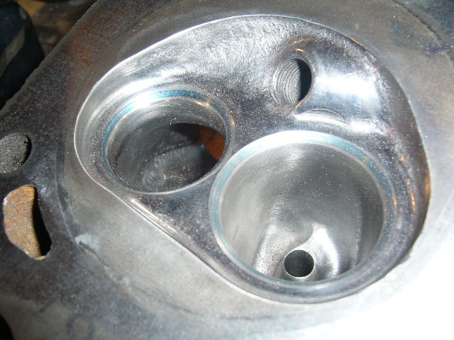

Had a S1auto & S2 long blocks that had fallen over given to me last year (both minus sump & pickup and both with S1 intakes sitting on them) so i took the heads from the S1 to tickle up in prep for going through the man. motor, must have been the one that "dropped a lifter" heads pretty much done, will finalise seats/chambers when the shortblock goes together to get compression spot on. When i pulled the first rocker cover off the man. motor i was hit with that burnt smell that spells
this thing has been cooked, big step in tops of bores-torn up cam bearings etc. etc. but the crank looks mint. pulled apart the spare S1 auto and its had some dosh spent on it previously, bores and cam brgs. pistons good, also had new looking genuine morse timing set, ballance shaft gears etc. so i'm using this block/pistons with the manual crank and cam (spare cam badly pitted lobes) and timing cover (spare looked nicer till i found a crack behind the seal through to the pressure side of oil pump .. grr.
