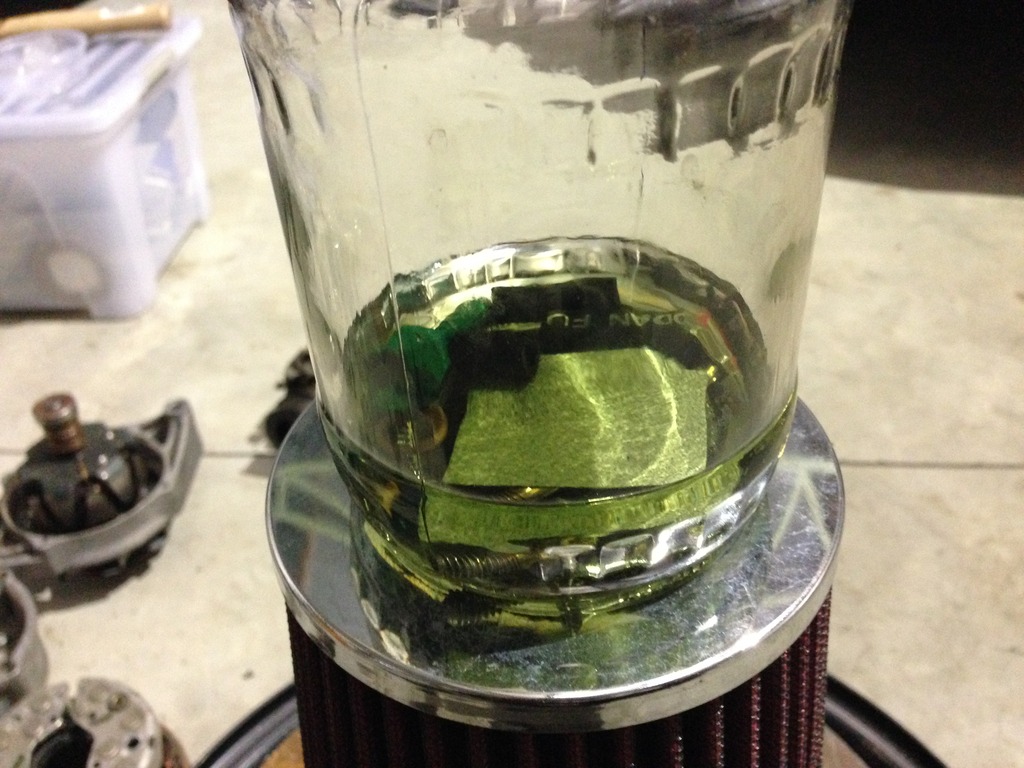

Have made an experimental E85 tune and 202T put in his 2c
Bought 20L to play with on the holidays.
Taking this opportunity to see if it has effects on parts and materials found in my fuel system. A jar with some stuff to soak for a long time and see what if anything happens. have 3 types of fuel hose, 24 year old genuine GM hose which I have found flawless despite the age of the hoses now, and danish made? codan brand hose. Also have metals with various different coating and platings, anodized alloy, in tank return hose (factory non re-enforced type), o ring that I use on the fuel system, viton and nitrile (N-buna?)
This stuff smells wicked!, real sweet smell and has a peanut butter after smell lol. I cant smell the petrol component though?

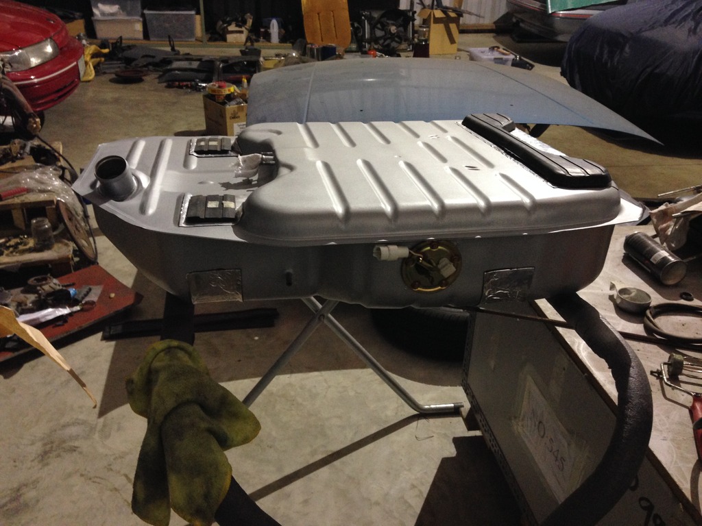

Finished my tank.
Also painted up some more brackets and stuff on the engine, few more to go. The1 is doing some injectors for me, ford 39lb 6 hole ones!
Finished my tank.
yoda69
- Posts: 1226
One of the things you need to be careful with is as it soaks up water out of the air and then corrodes metal parts that aren't coated.
Holden changed a lot of parts for the VT that went to Brazil as they run an ethanol mix. From memory steel piping needs to be coated on the inside and some rubber hoses the inside breaks down and releases little bits of rubber that can block filters and injectors.
