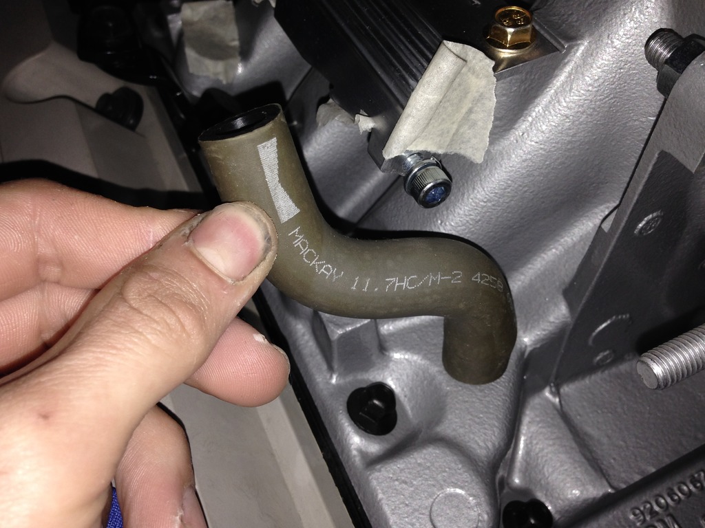

The verdict on the E85 soak test is surprising.
The normal fuel lines did fine and the interesting part is the outside jacket which is not meant for fuel contact is completely perfect in E85. The genuine 24 year old lines hold up a treat, the Codan brand does alright too but the feel of the 2 I'd say long term the genuine hose. Funny as it was designed when there was no such thing as alcohol fuels.
The bad news is the in tank hose dies very fast, 12-24 hours and its fucked. Stays intact but picks away very easy as seen here. So VN-VS commodores will need the tank opened up and that line replaced with something like a gates submersible line, which they are alcohol rated standard and aramid reinforced
Interesting bit is the bits left out of the E85 over night seems to have reconstituted more or less back to normal. Im going to leave it soaking for a week , test its properties and then leave it for a while outside and see if it comes back to normal or stays crumbly.

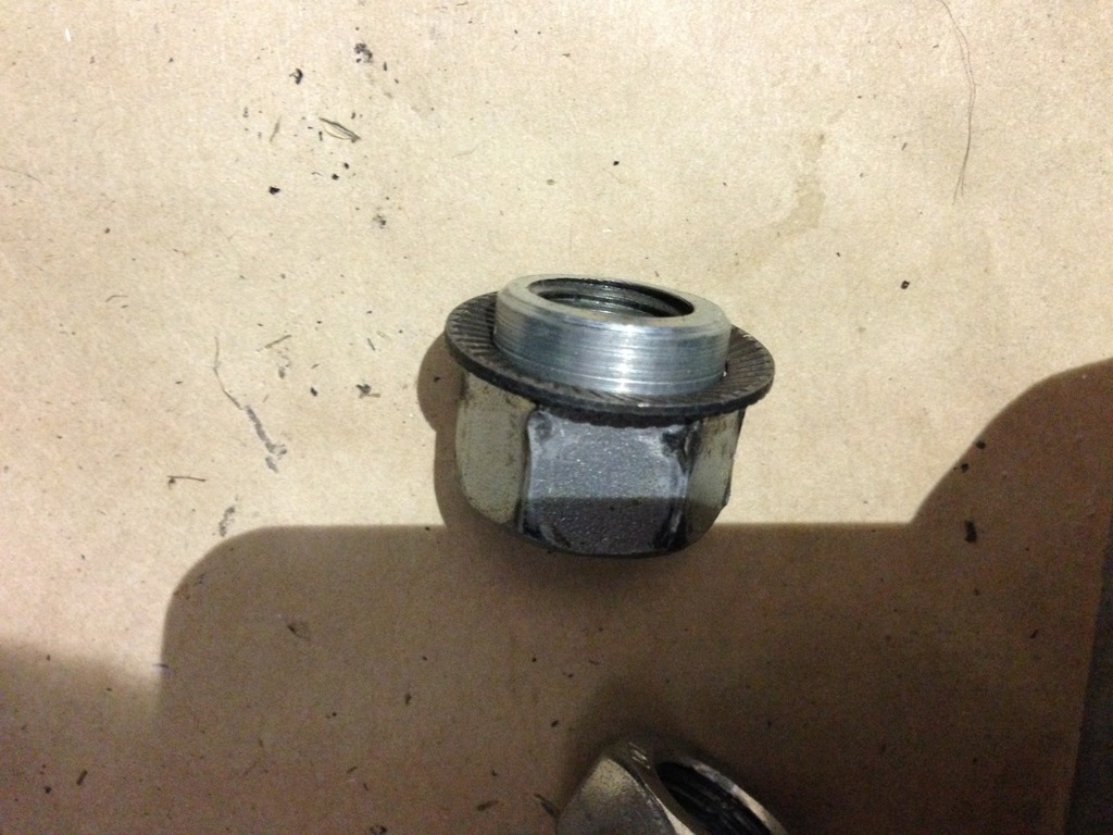

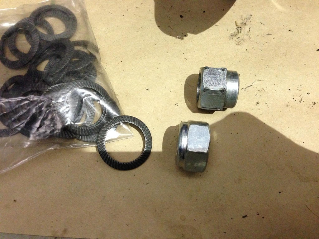

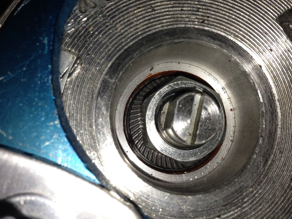

With the K mac strut tops. They have a custom made nut with spigot to located into the hemi joint. The potential problem I see is that there is no locking means for the nut so I had used these anti shake washers before. They are harden spring steel, conical shape and are serrated. I have heaps at work but they are too small. At a job on the last day of work I was 2 blocks from wurth and I stopped in and got some. Perfect fit! Genius! :punk:
Looks like is would foul up but it moves the full range of motion which is 5 times what it will actually move once in the car. Could not work out better. I think I will pass this on to Kevin at K-mac as this is potential safety improvement.

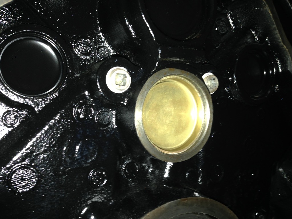

Cam plug, new one on the left, shitty steel one on the right. Dont worry, there is enough depth to install 2 of those brass ones back to back and still not hit the cam lol.
:D
I also replaced those shitty gallery plugs with proper hex ones of a better metal. The factory ones are cast as I found when I broke 2 trying to get them out of the old block in the vacationer as I wanted spares. These new ones are the same as I used to delete the knock sensor in one of the earlier posts few pages back. I bought a heap as I always do haha.
