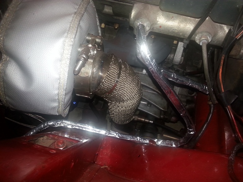

Brake lines are now insulated near the turbo, I still have to sort out a heat shield for the MC though. Long term plan is to move the MC over to the driver's side firewall and get rid of the booster, but that's not a simple job so this will have to do for now

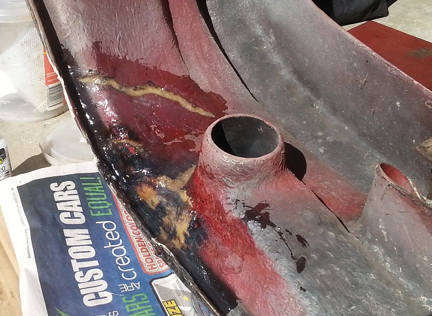

I scored a fiberglass front bar (which meant losing the gutter mesh lower grilles I made), test fitted it then pulled it back off for some repairs.

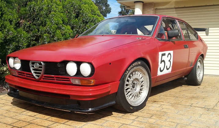

Couldn't find that headlight so had to fit a spare one.
Finished the repairs to the front bumper and touched up the paint a bit, then moved it outside for a quick wash.
I spent far far too long trying to work out why it was idling like a pig, finally checked the codes and saw high MAP set.
Popped the bonnet and re-connected the vac line :(

Looks good man can wait for the vids of the track day how much more is there to do?
Posts: 9002
Re: festy's Alfa Romeo Alfetta GTV
Yeah looks ready to go! :) For a car like that how awesome is it that you can read the codes and get pointed straight to your vac leak! Maybe not so exciting for us lol. :thumbup:
Posts: 1217
cars: HQ Holden
Post by HQ355 »
Nice looking machine mate, keep us posted how it goes :)

nice, need track vid
Car looks great festy! Surely not long now till it hits the track?
