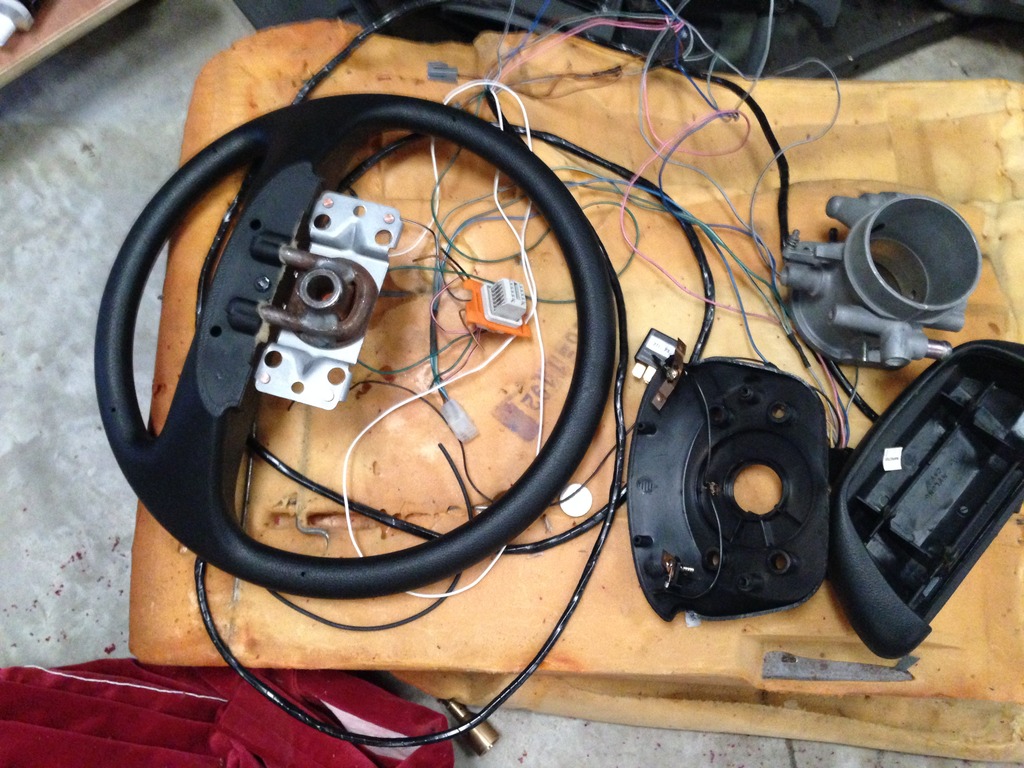

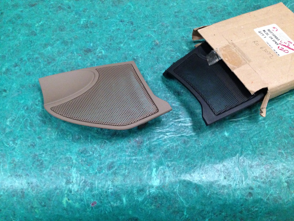

Scored a NOS black VP steering wheel for 80 bucks and also from the same guy a pair of NOS speaker grilles. The left one in the VP S is cracked so it happens the left one from this set is the correct colour
That steering wheel would be worth a mint as its NOS but even more rare that fact its black. As far as I know this was vactioner only spec. But ill put in the red car as my wheel is a bit sad.

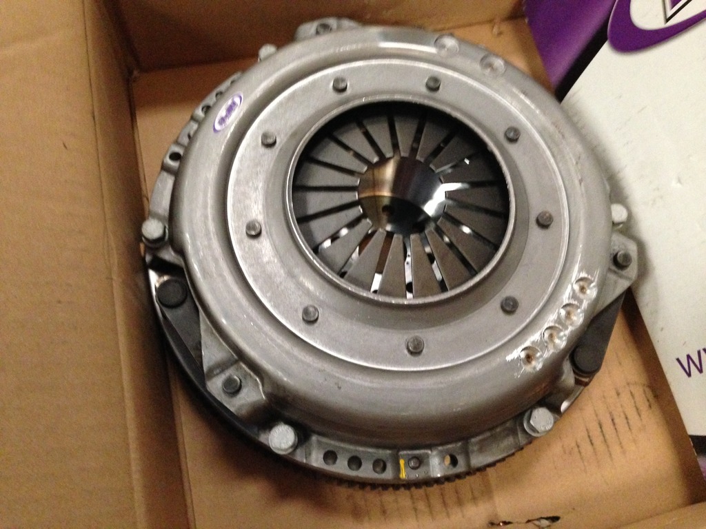

New clutch balanced.

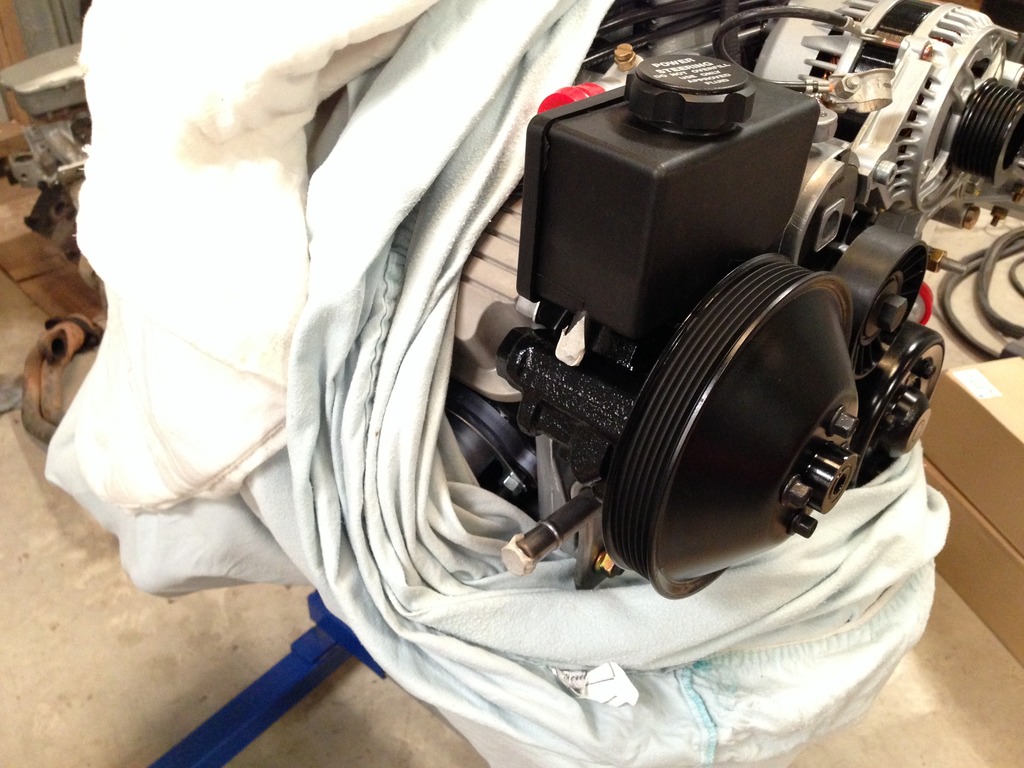

Annndddd... new PS pump yay!
