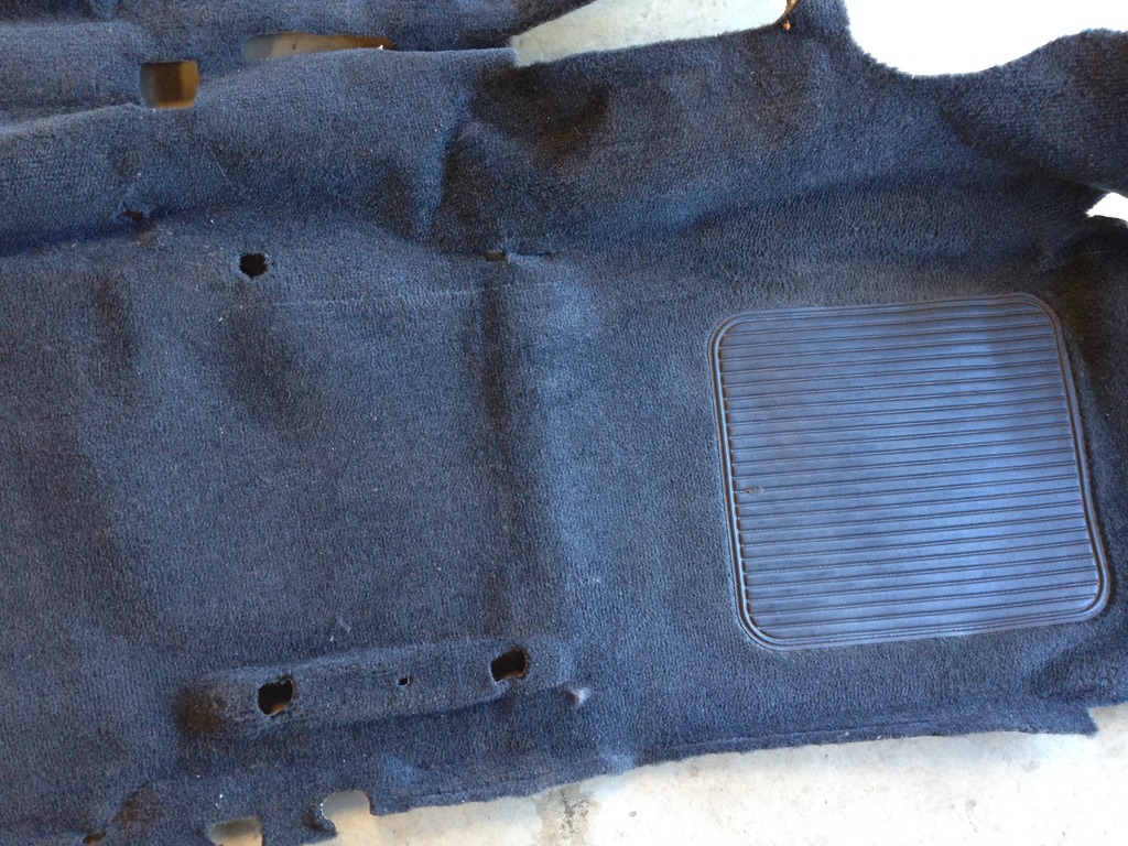

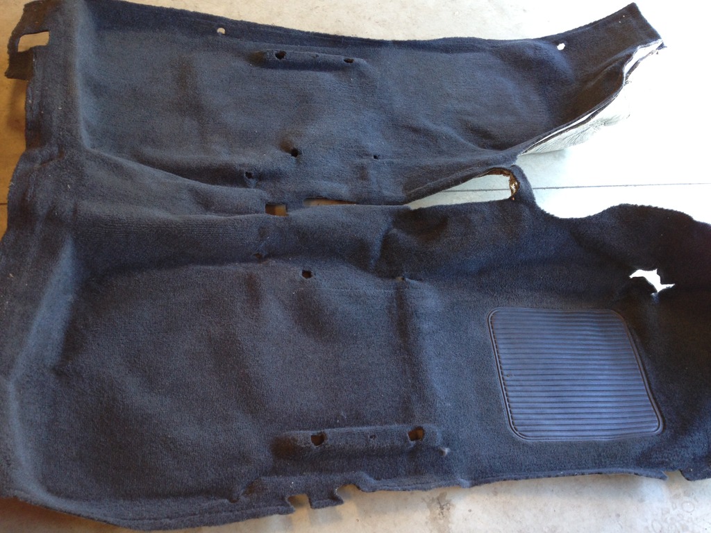

I scored this really clean carpet from NLA parts in sunshine. Alf the owner he is a real enthusiast and has tons of NOS stuff for all commodores. Got some real nice cars of his own. Heaps of V6s with less than 70k on the clock there too. for 650 you can drive home a 54k VP II, but man its fucked from sitting what seems the desert for all its life.
This one came out of a near mint HSV VP that they couldn't register.
I have been put on the contact list for first dibs of VP parts haha, Also at allcomm the same deal. :P

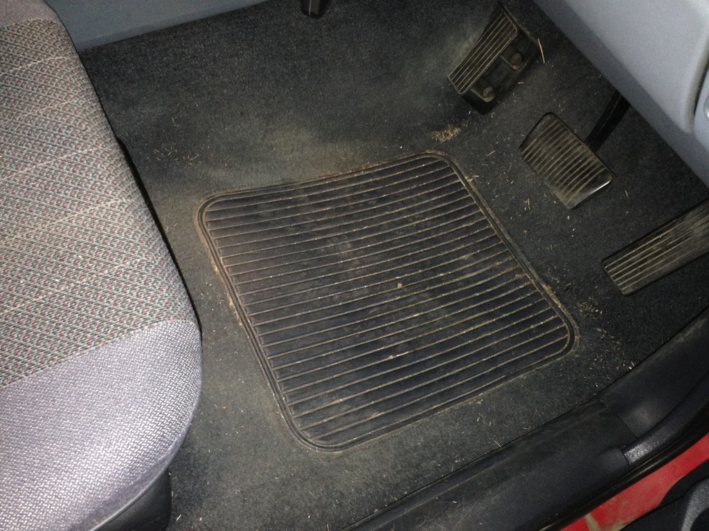

Will later wash it to really bring out the goodness. Evidence of something spilt on the backside where the driver's feet are.
Better than my carpet lol. Worn out already, wasn't that great to begin with.

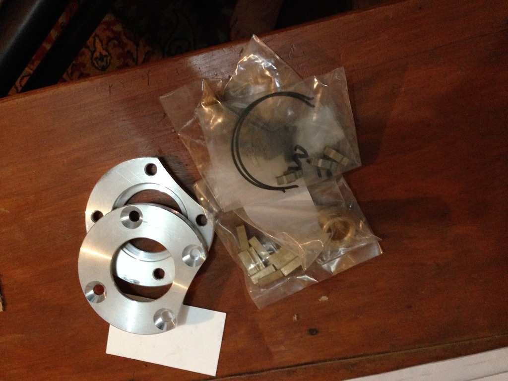

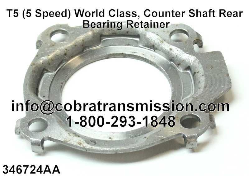

Where did you get the counter shaft retainers from I've heard varying things about different brands and people making them saying the move around to much on screws or hit on 5th gear?
I got them from thegearbox.org.
They are counter sunk 10.9 screws, certainly won't move. The plate is 8mm thick, vs the 2mm or so pressed sheet OEM plates.

Nice just had a look at the site I'm guessing it's from US. I was looking at this one http://www.5speeds.com/t5.htm
Comes with peel able shims in real small sizes just peel it down till preload is correct and it's about the same price
