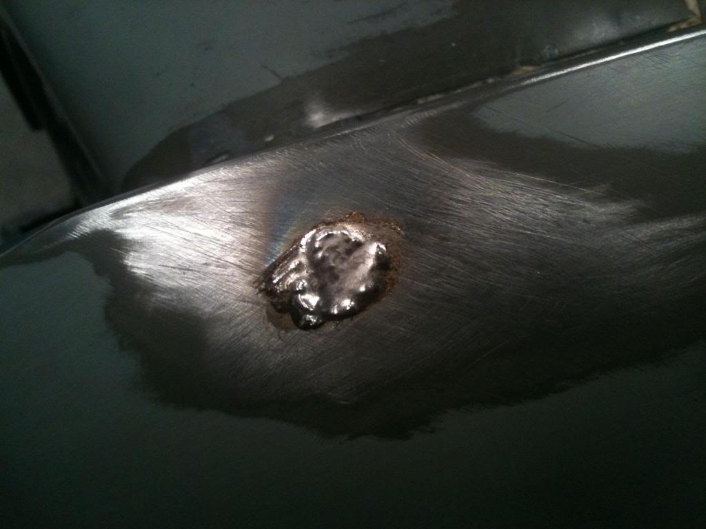

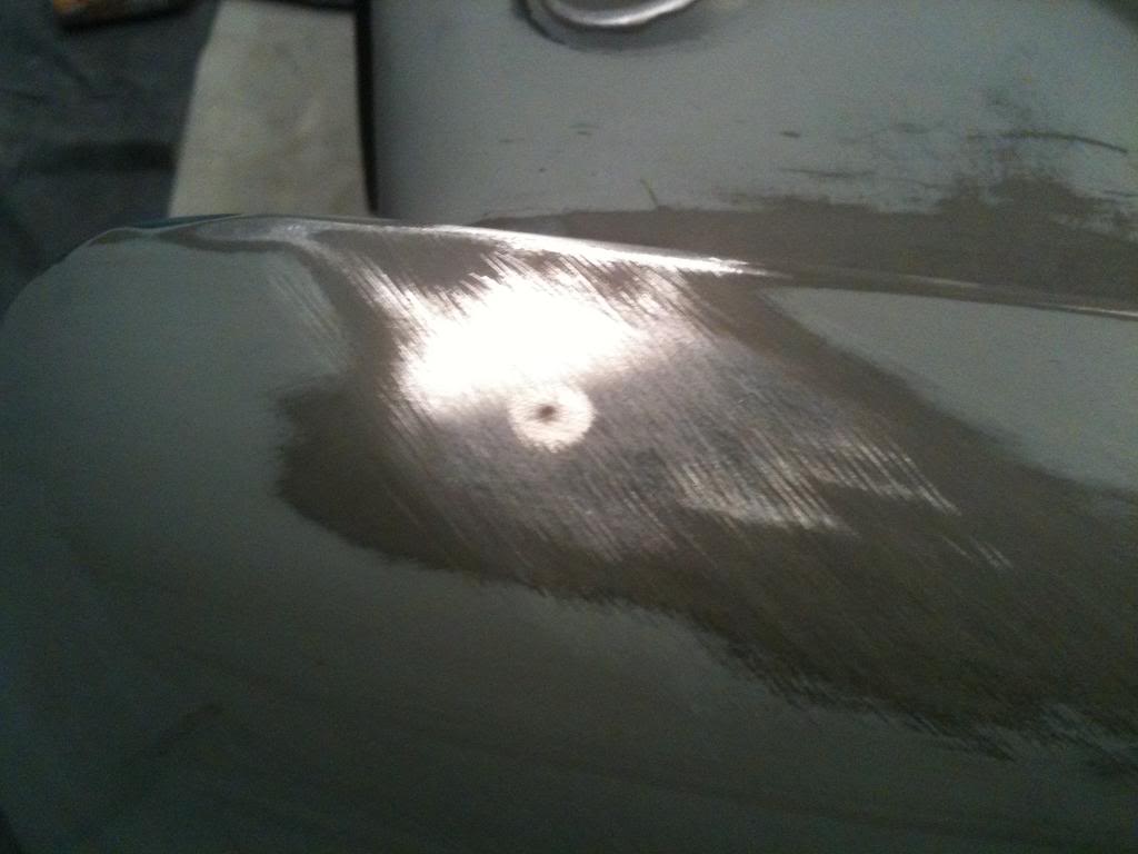

got to this spot, no dolly would fit in there. So I tried the old heating trick and got only so far. the dent was tiny but very sharp and deep.
so lead fill time :D
I got the proper body lead tinning paste and filler rods from consolidated alloys in Thomastown. The stuff is manufactured so old school the brochure was printed in the 60s lol :lol:
Anyway this stuff works real well and is easy to use.

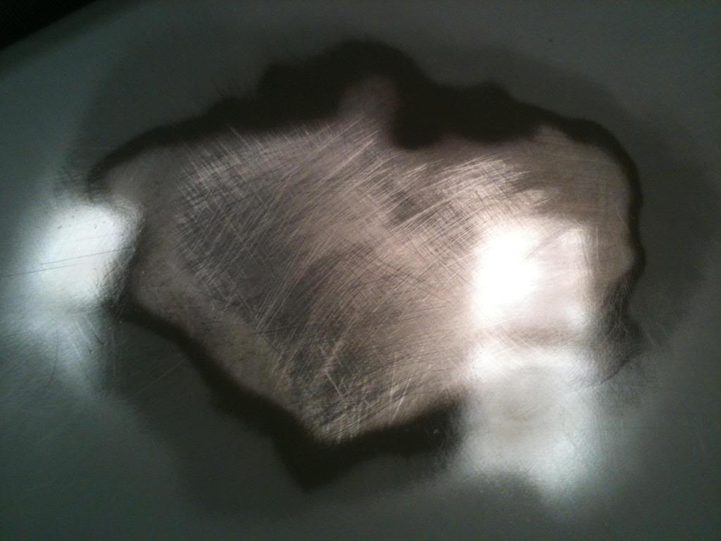

filed to final finish.
With these newly learned tricks I can tackle the 2 dents on the left rocker panel now. Might also try lightly heating some very subtle low spots in the 2 major roof panels beating I had show few pages back.
