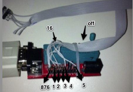

Here is the programmer.
Can you see anything obvious ?

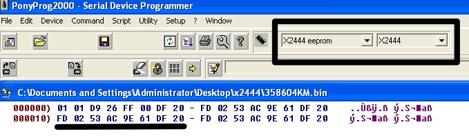

Maybe you could try putting the chip back in the dash to check it still works and hasnt been corrupted.
- Posts: 4853
all i can think of then is it's the serial to usb convertor your using or are you using straight serial? i used min on a convertor..

Dumb question maybe, device is x2444 eeprom / x2444
do you have some other program you can recommed that I can try?
- Posts: 4853
no it's only program that i know of that will work with x24c44 chip.

- Posts: 4853
yeh same here, dunno what's going on, working fine here
So in the program youve got X2444 eeprom and x2444 in the two drop downs?

See images, a second question is do you need to change all 3 sections with the new hex numbers?The1 wrote:yeh same here, dunno what's going on, working fine hereSo in the program youve got X2444 eeprom and x2444 in the two drop downs?
