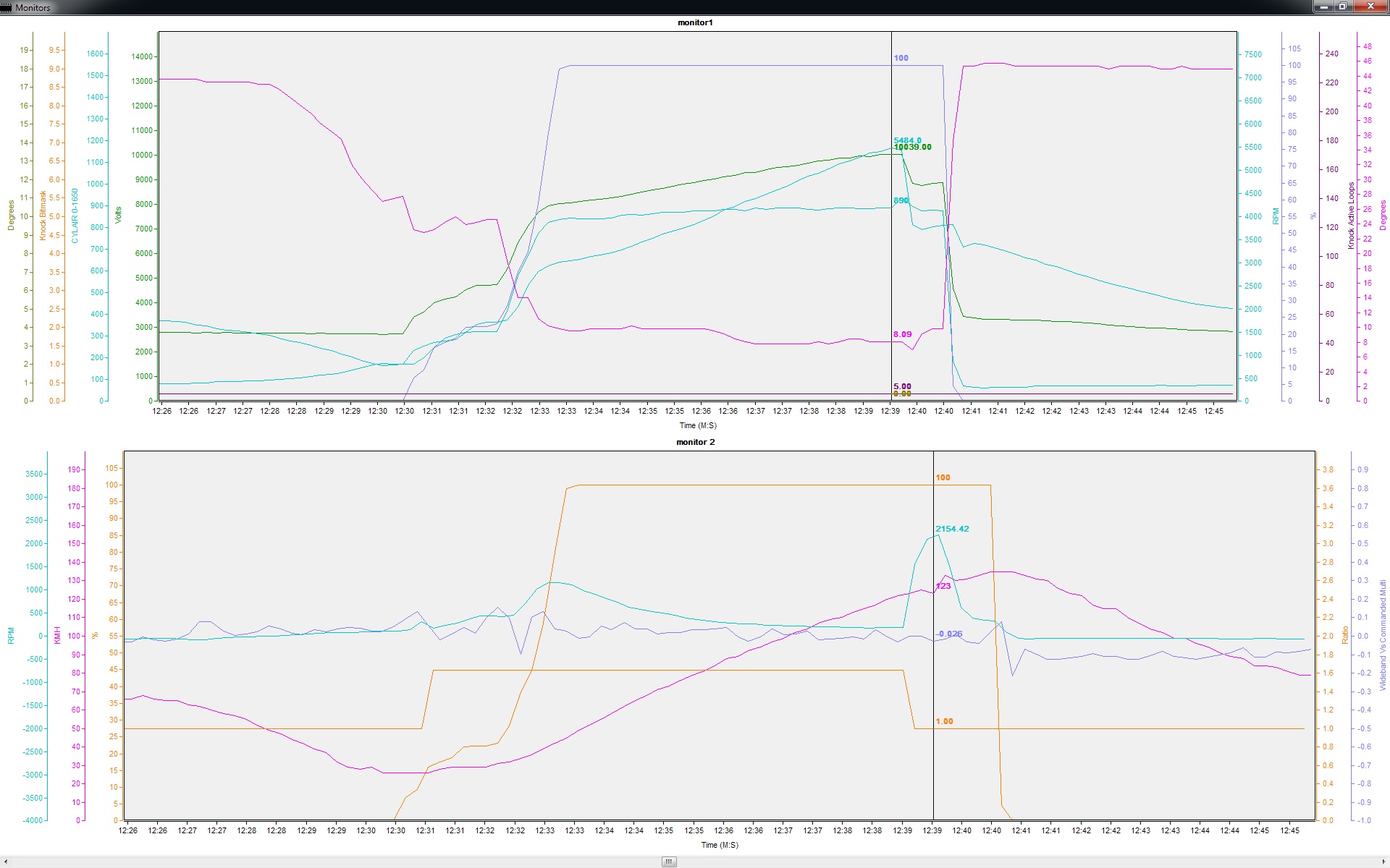

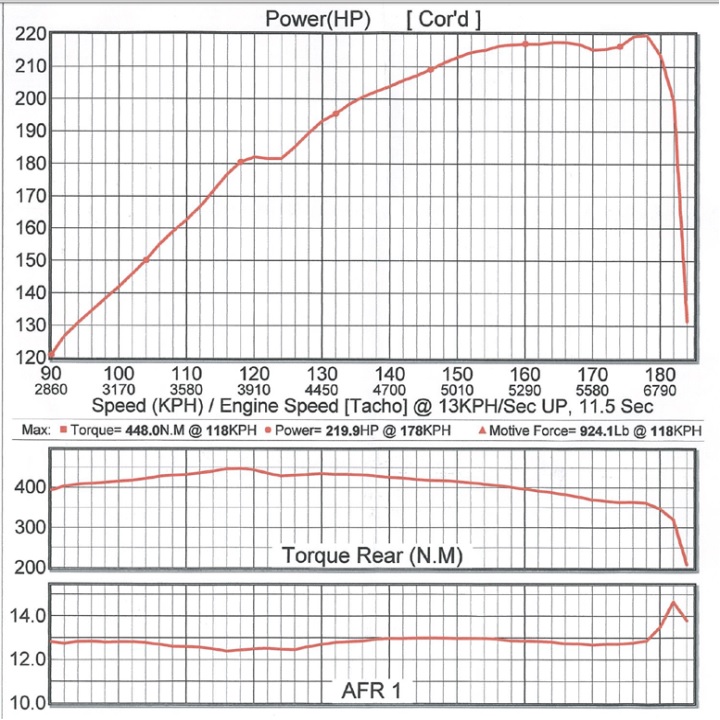

thought id post an example for you all to analyze lol, tuned this car with enhanced mod v1.2 not yet released. Attached is dyno log and a WOT run in tunerpro. Not sure what's going on with AFR's the innovate MTX-L reads 11.70 but NGK tailpipe meter on dyno reads leaner

- wotrun.jpg (333.05 KiB) Viewed 5831 times

Great numbers and on a mainline dyno too.
Tailpipe will always read eager in a car with cats, won't it?
That dip in the top looks like classic valve springs going off.

Re: Enhanced Factory Bins
yeh that's what i put it down to being cats messing with the readings, but you'd think an expensive tailpipe meter would be close.
It's running stock 5900rpm limiter.
Yeah I've heard tailpipe normally reads leaner too and I've seen the same on the Dyno myself, but not that much difference!

Wideband before and after cats will read differently, leaner post cats. How much different is generally how well the cats are working I think. If you log pre and post cats during closed loop you won't see the rich lean swings post cats if they are working OK. This is how the pcm can determine catalyst faults on obd2 cats.

cool.... so does that mean my cats are working well?
yep and thanks for sharing and tuning with me, has been good, now your off to get a map a2a kal lol anywaySchwuppes wrote:cool.... so does that mean my cats are working well?
normally there isnt as big a difference as what you've seen but it relies on no exhaust leaks but the time you get to the rear and also having an extension tube that goes right up the tailpipe to prevent any outside air contaminating the reading.
