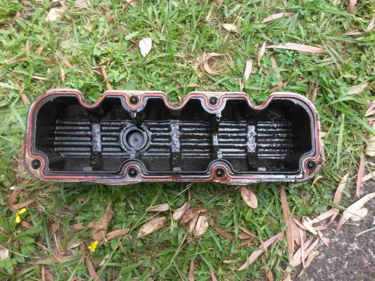

Took the Calais out for the Sunday lunch run. Starts well and runs good with the numbers The1 supplied for these injectors. Plan is to fit the rockers next weekend along with new rocker cover gaskets as the drivers side gasket is leaking big time now, can smell burning oil after a drive where it's leaking onto the exhaust

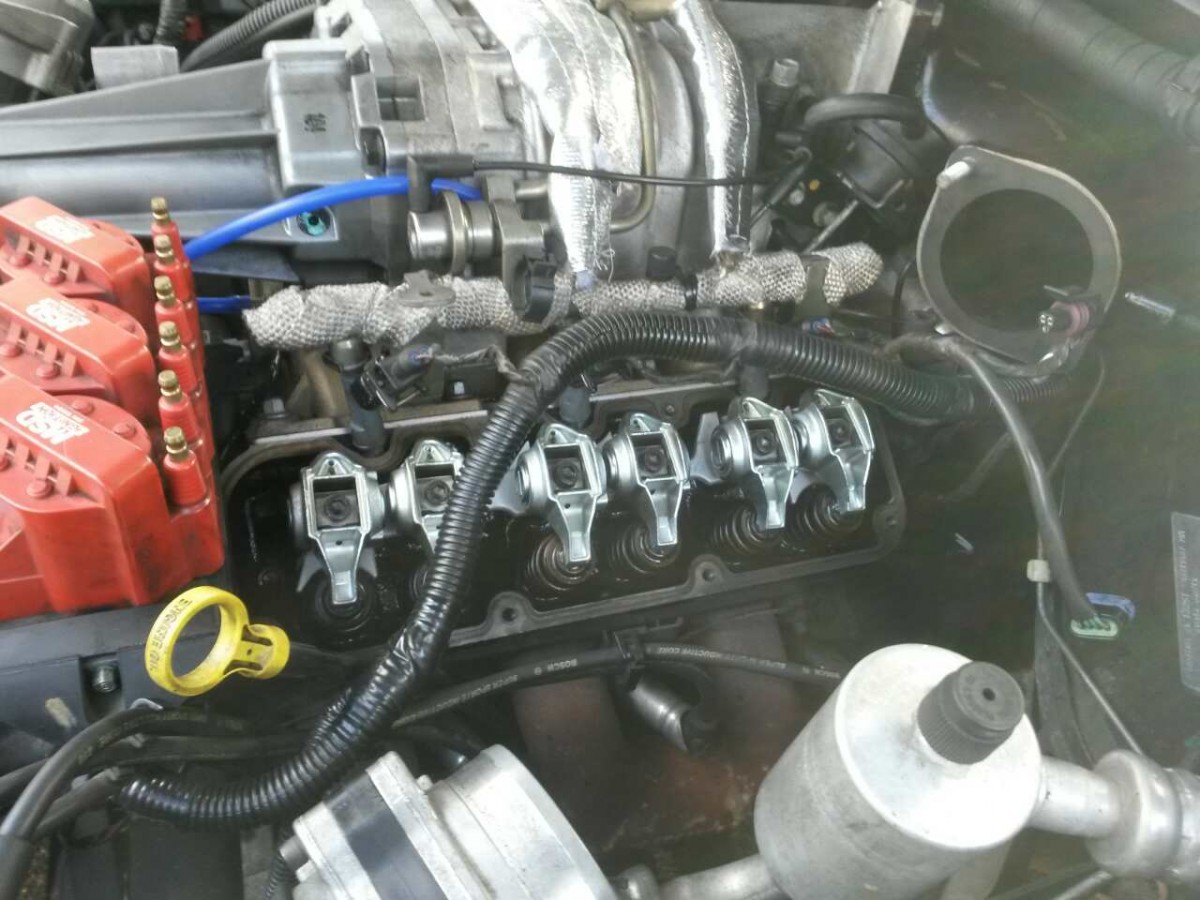

Upgrade time
Time to fix those leaking rocker covers and enhance the performance just a little bit.
Scungy (great aussie slang) shit

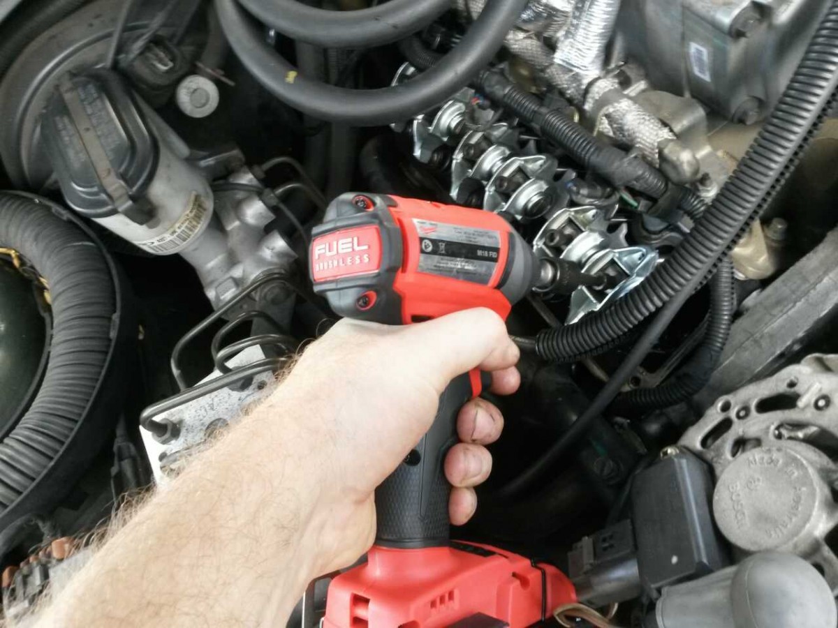

Fitting new shiny shit and testing out the Xmas pressie. God damn I wish I got one of these years ago....

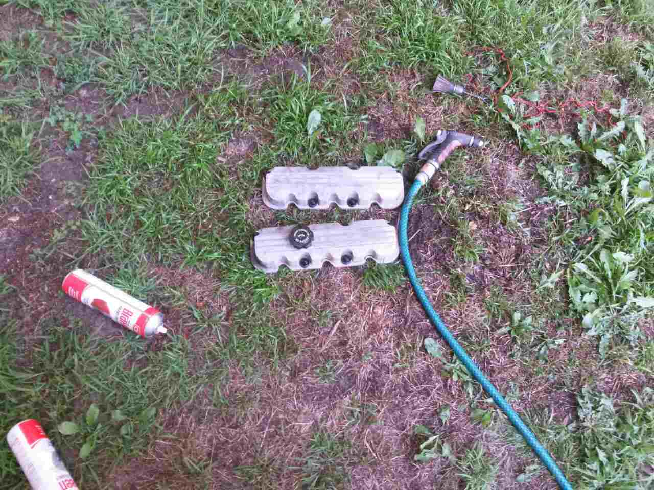

Giving the rocker covers a big birthday

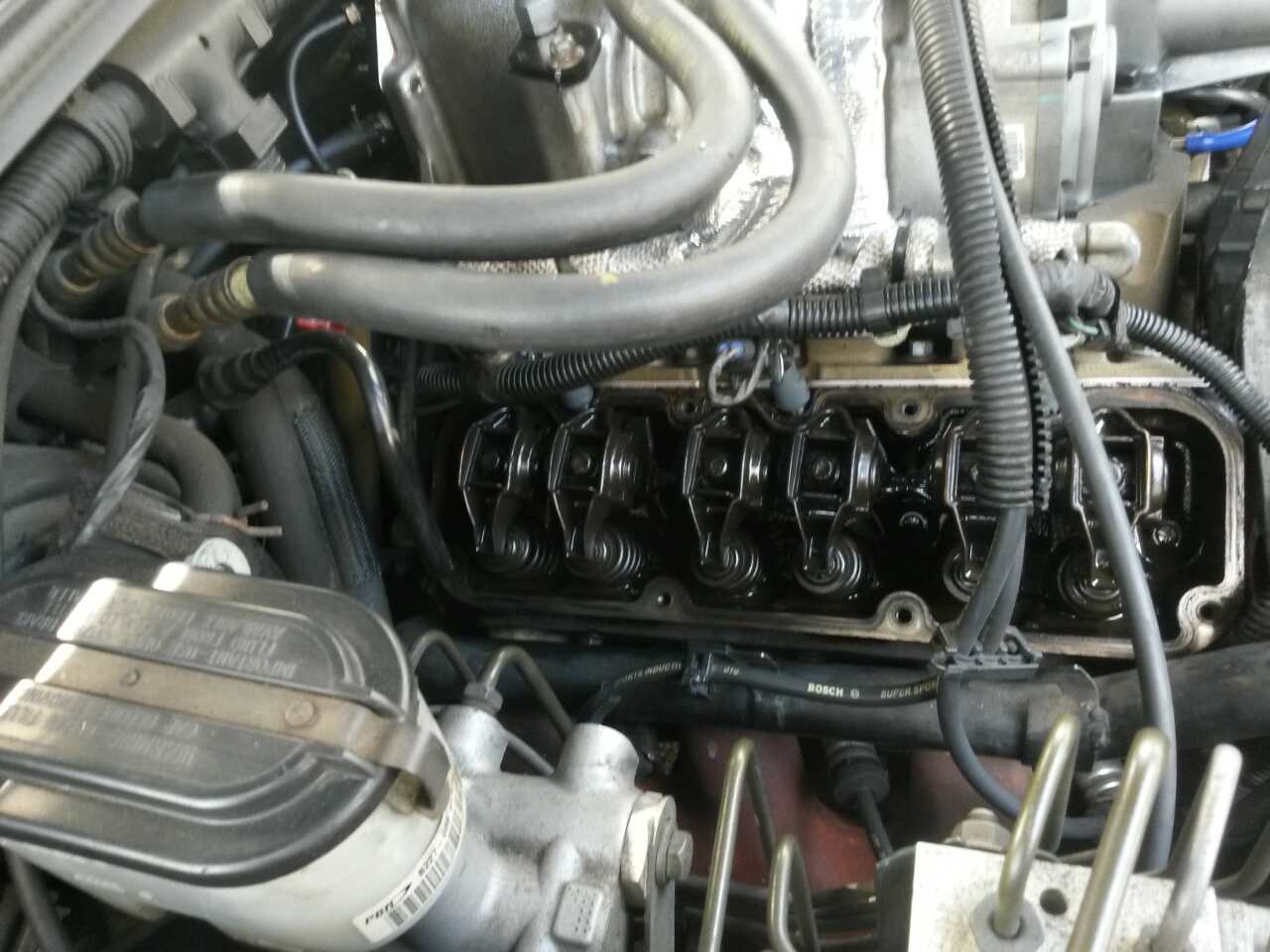

I have fitted new push rods with the high ratio rockers and I'm glad I did, of the 12 original push rods, 9 had worn a fair bit, I guess this is one of the few down sides of roller lifters because now the push rods don't rotate allowing mating surfaces to wear into each other a lot easier. I tried to take a pic with the crap phone camera but they just aren't coming out. Might try later with a decent DSLR.

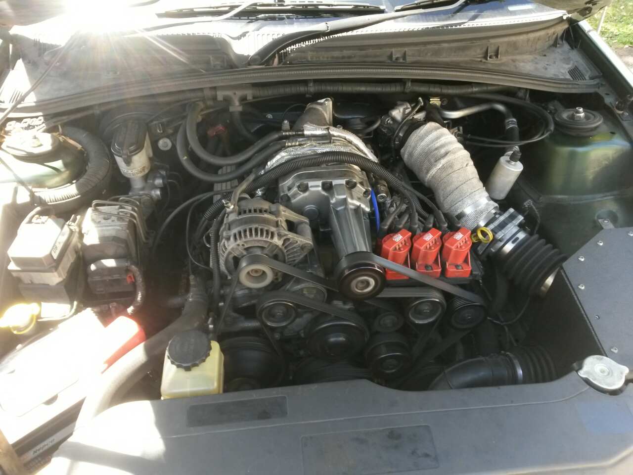

Well she's all back together again and purring like a kitten, Fired up first crank and no nasty noises
Looking a little cleaner although it's gonna need a thorough de-grease top to bottom. Time for a test drive and to see what the numbers say.
