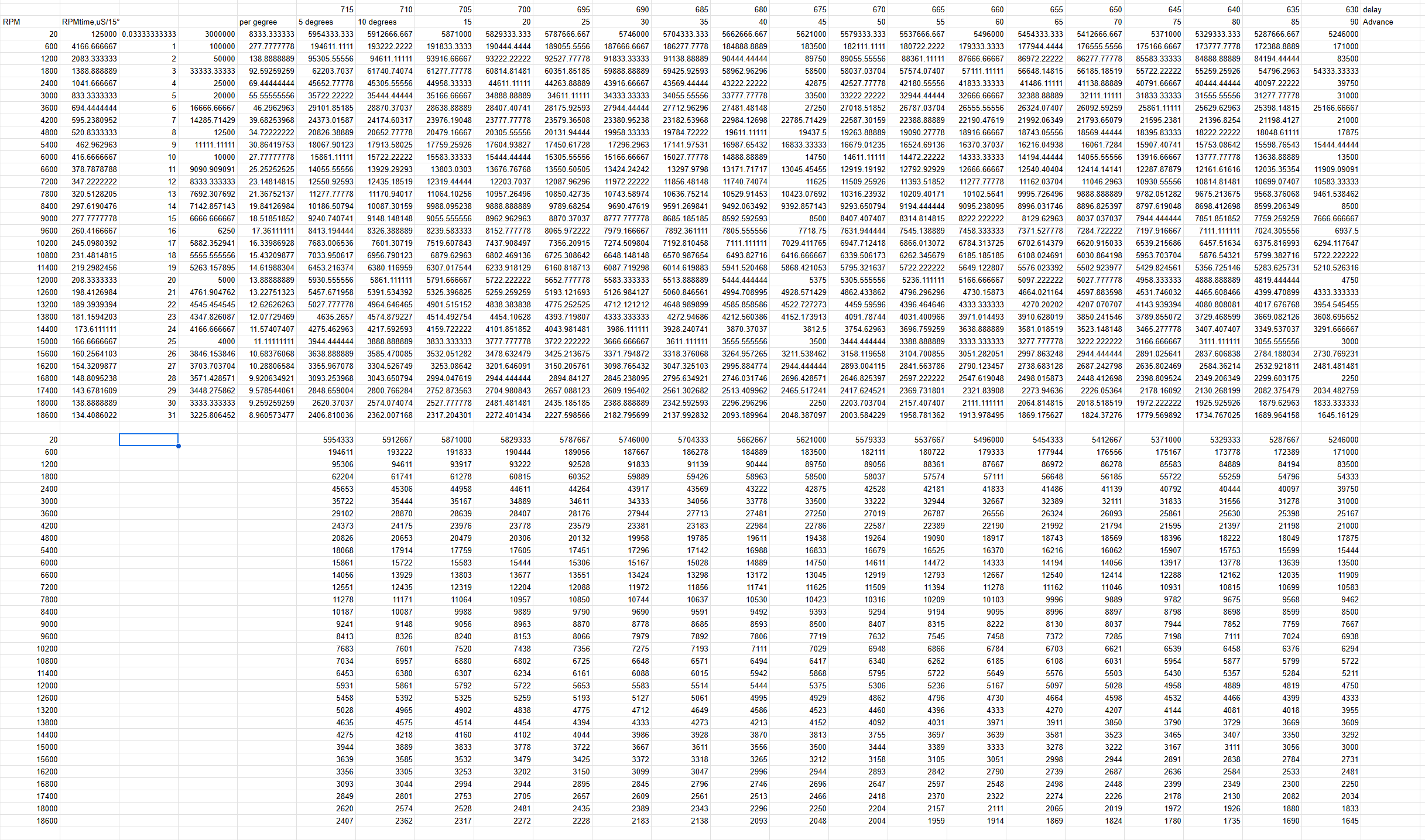

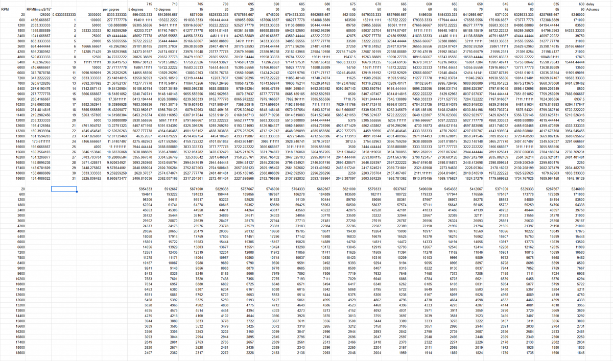

The numbers to put in to achieve desired spark advance in each RPM zone of main spark table.
Numbers are for the full sequential setup.
These numbers account for the fixed 4millisecond dwell.
Bottom is same numbers rounded without decimals.
Don't stress specific units.

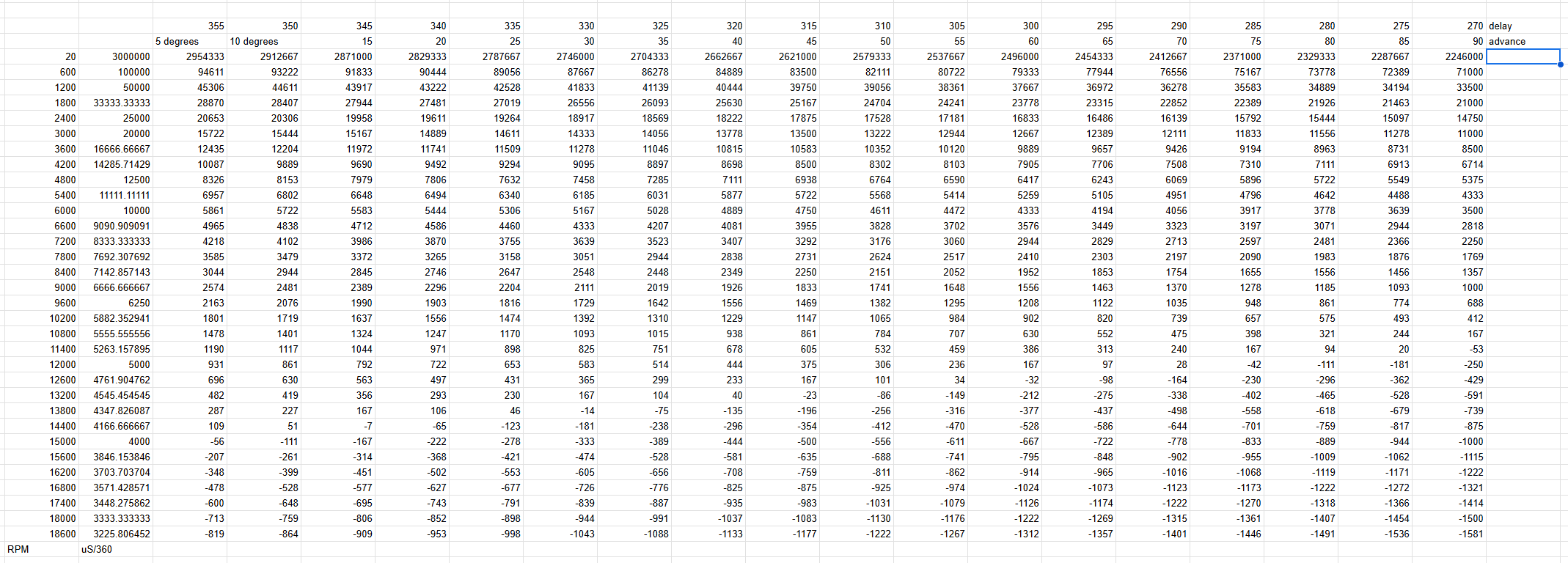

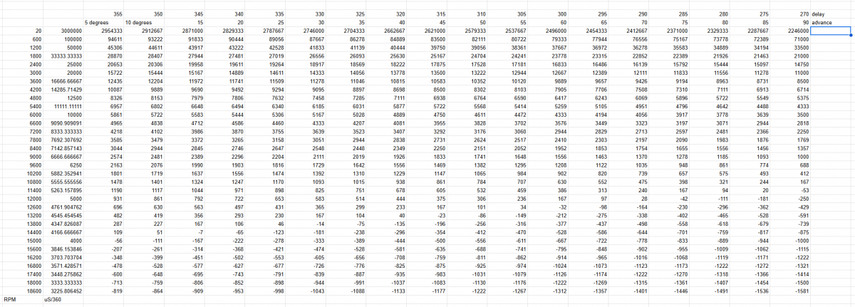

Here are waist spark numbers. Just subtracted the microseconds per 360 degrees.
Negative number just means you can't do it. Those negatives start at over 11,000 RPM though.
This is what I meant by opening up the dwell window for higher RPM.

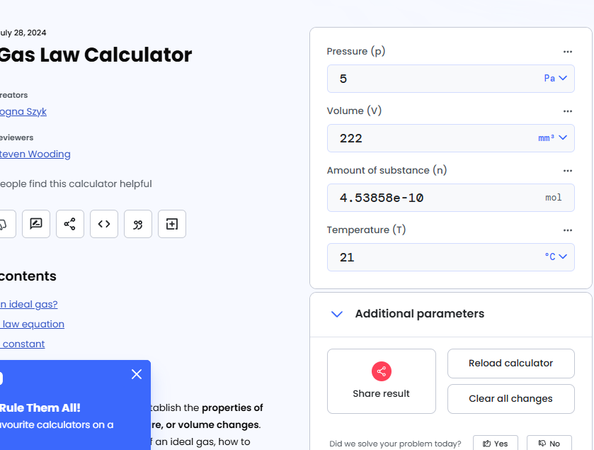

Never understood what the fuck a "mol" is.
Just looking for good starter numbers for the CB450.
Calculations I can put in google sheets. Make it a little easier to give people instructions they can follow.
Going to start with some false assumptions,
like 100% volumetric efficiency at all RPMs.
1 millisecond injector dead time.
I'll have a choke knob to play with to get an idea how far off I am.
