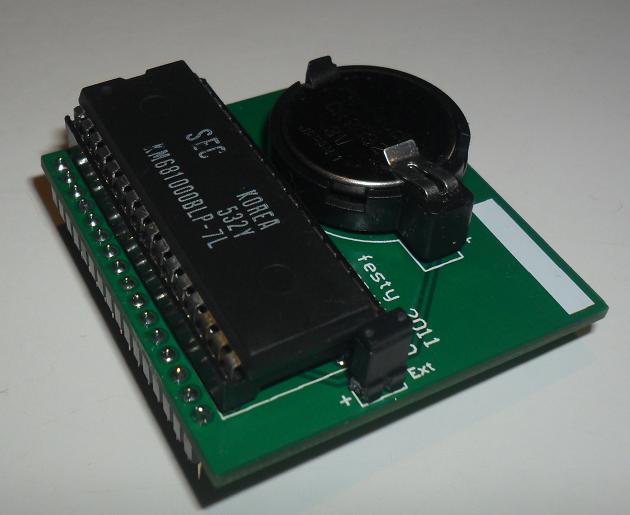

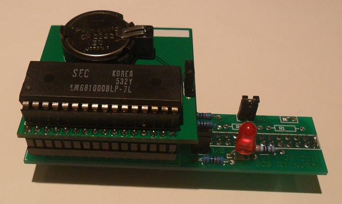

The boards arrived today - just need to pick up some shorter pcb pins because the machine pins I was going to use make it too tall to fit in the 808's case without mods. My 'test bench' ecu is running off this module now.

That looks good. Any idea of cost yet?
