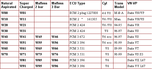

i actually just realised you have a VX not VT have you rolled back ecu's to the vt ecu or something shouldnt you be using the W81+ software for VX at least thats what this table would suggest

I was told by Alan Gibbs at KalMaker, who runs the selling side of it not actually developing it, that the realtime boxes are the same, But I will confirm it with him as I told him what I wanted it for! & mentioned they have the same controls & features.
