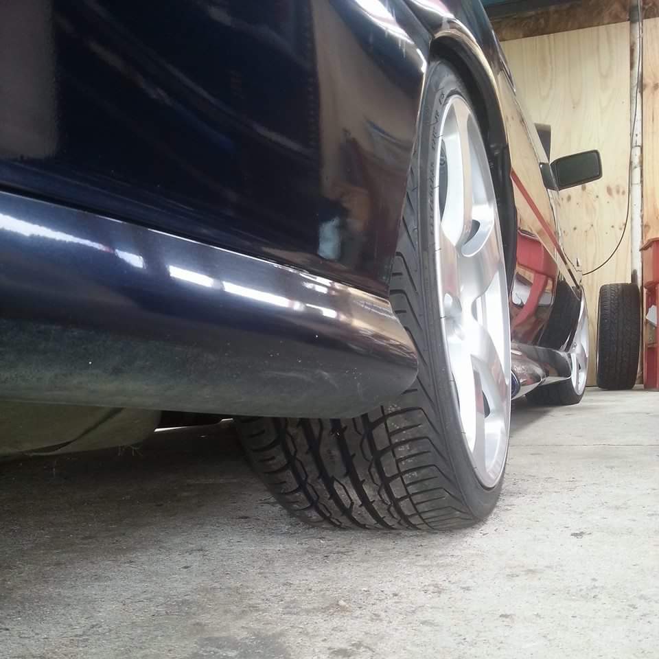

If you need clearance look into the VQ trailing arms. Moves the wheels in 13mm a side ftom memory.
Depends whivh side you're wanying more clearance.

Got the 275s fitted to the rims and bolted on and the guard is sitting hard on the tire. good advice Dylan, guess what I'm half way through doing now? Lol for anyone playing at home vq to vs trailing arms are identical but vp vq rear stub axles are 19mm narrower than vr vs ones. Just waiting on new rear bearings to arrive then I'll put it all back together!

Vq stub axles fitted with new bearings, caliper spacers made and bolted up which required my shocks to be spaced out too but they're all on now but haven't road tested them yet as I'm re doing the front suspension before it gets a wheel alignment... might do the 6speed too if I get some motivation.
