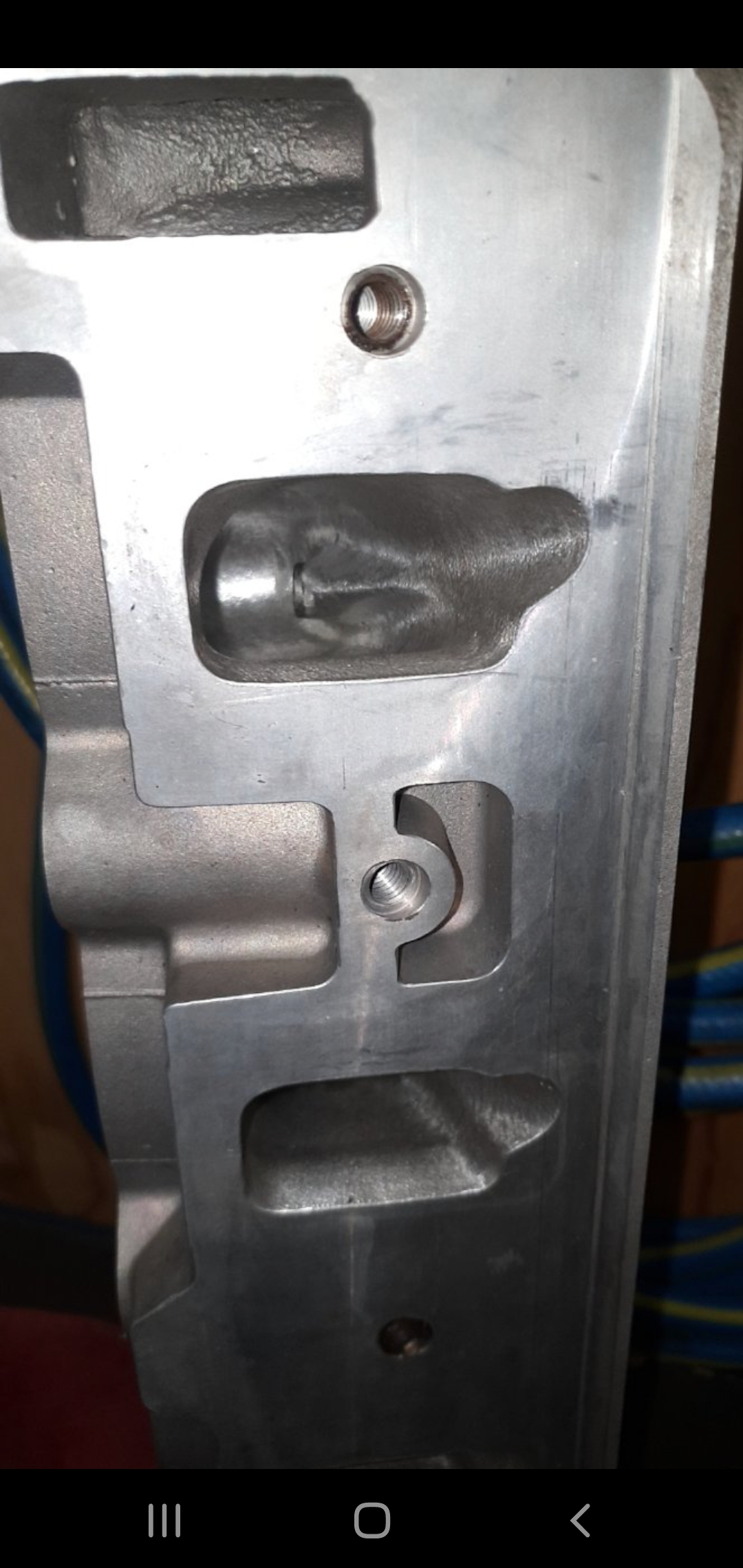

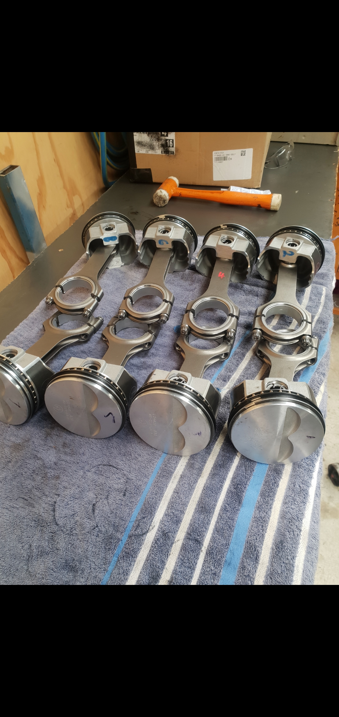

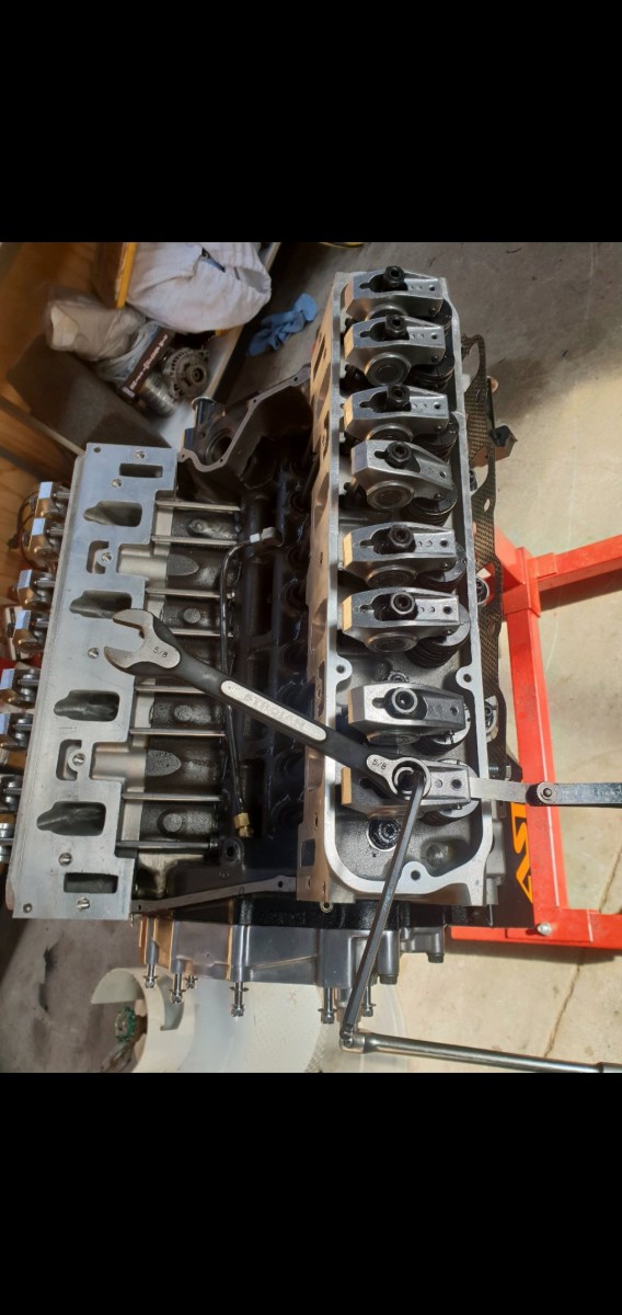

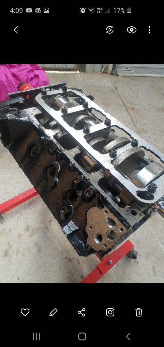

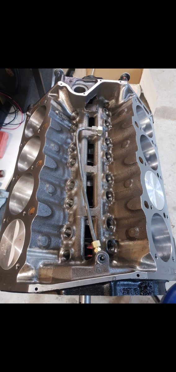

Come racing 355 stroker crank, mains cap girdle, scat H beam rods, speedpro flattop forgies, 11.9:1 comp, monster ported alloy heads with oversize stainless valves, crane 288 cam & crane valvetrain, asr main girdle oil pan, ARP studs top & bottom, oil gallery mods with ported oil pump, Harrop high rise manifold with 1200cfm 4barrell throttlebody, 42pound injectors, 400lph walbro pump, innovate WB & vl400 NV ram, VT 5L 120amp alternator.
