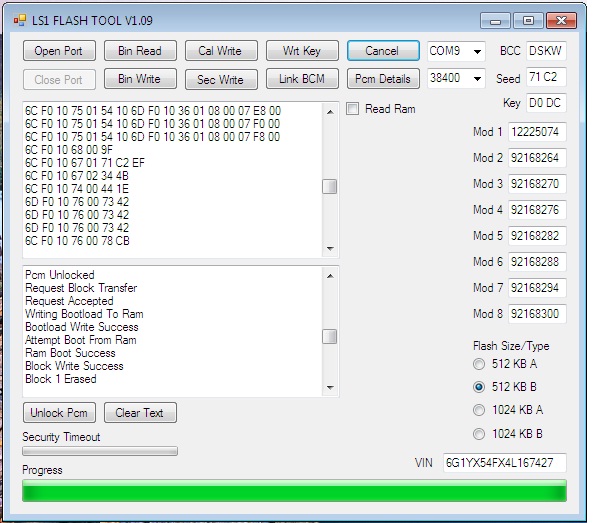

Yeah prototype is working well now,next step is to find someone to make me up some pcb's.

This is the latest version,it will read and write all commodore ls1 .bin files from vt to vz, as well as many USA ls1 512 and 1024 KB .bin files.
Ive decided to implement CAN to cable as well before i release this so that E38 pcms for L98 6.0 litre
VE commodore can be reflashed with it as well.
